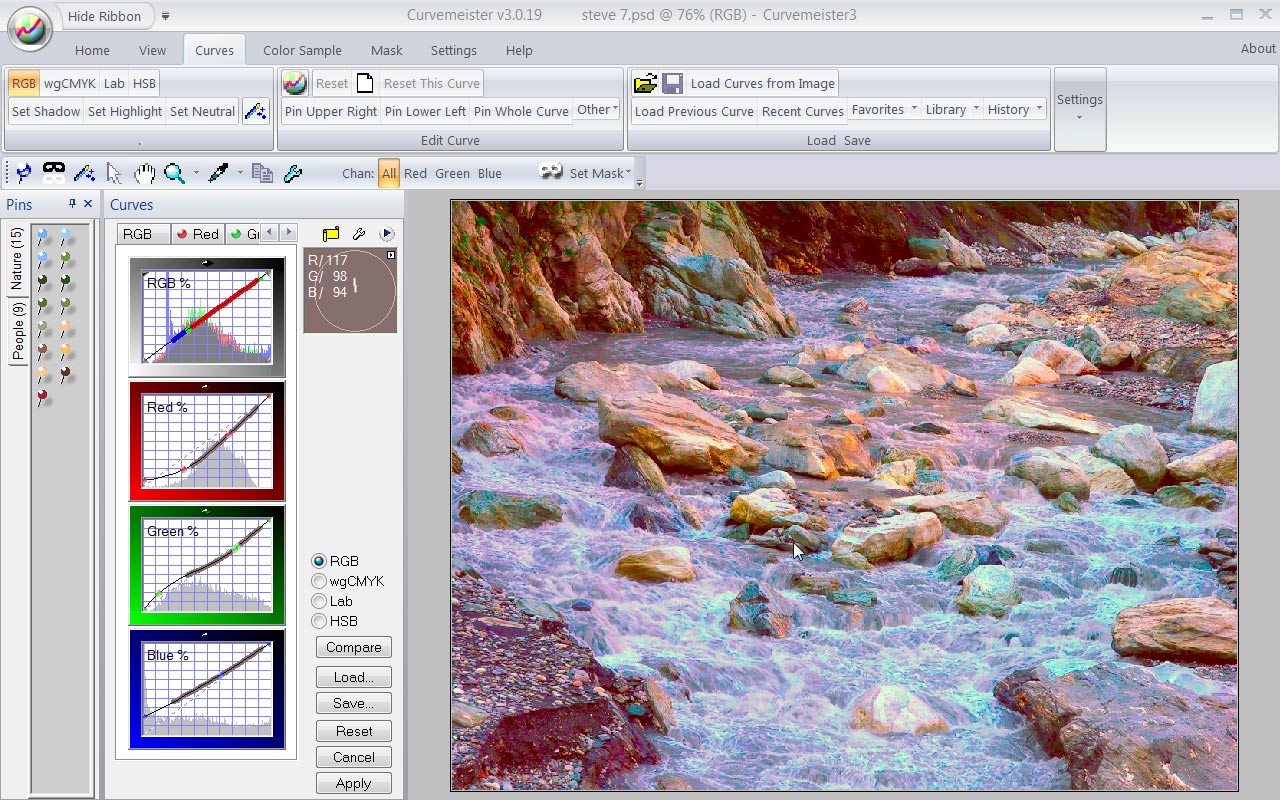

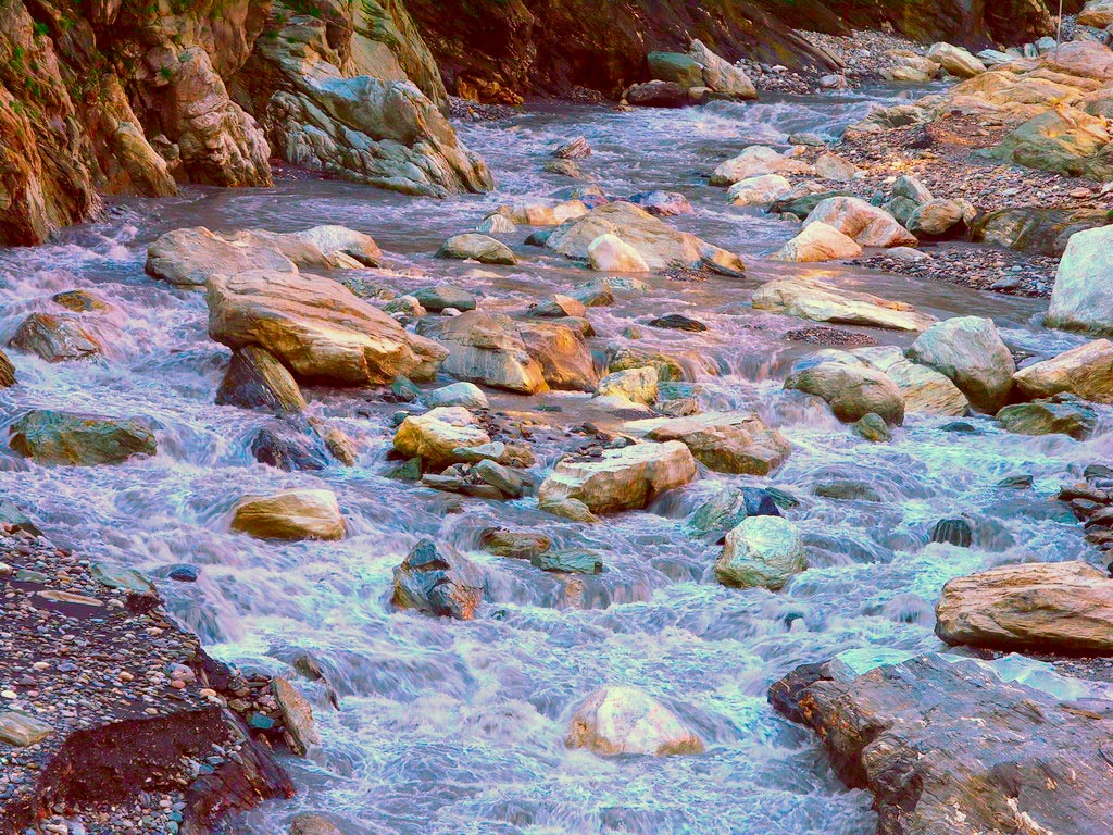

Here is my take on the canyon.  I used LAB, set thresholds.  I then boosted colors to shop for the neutral.  The hint that it wasn't the rocks wasn't helpful.  I am a little dense and tried the foam and there always was too much blue in it. I use a 3 x 3 sampler.
I shopped the rocks, and found a point that seemed to have the colors break right.  Then i backed off the colors and added contrast.
steve-7-ss-jpg
steve-7-ss-jpg (999 Bytes) Viewed 16951 times
steve-7-jpg
steve-7-jpg (999 Bytes) Viewed 16951 times

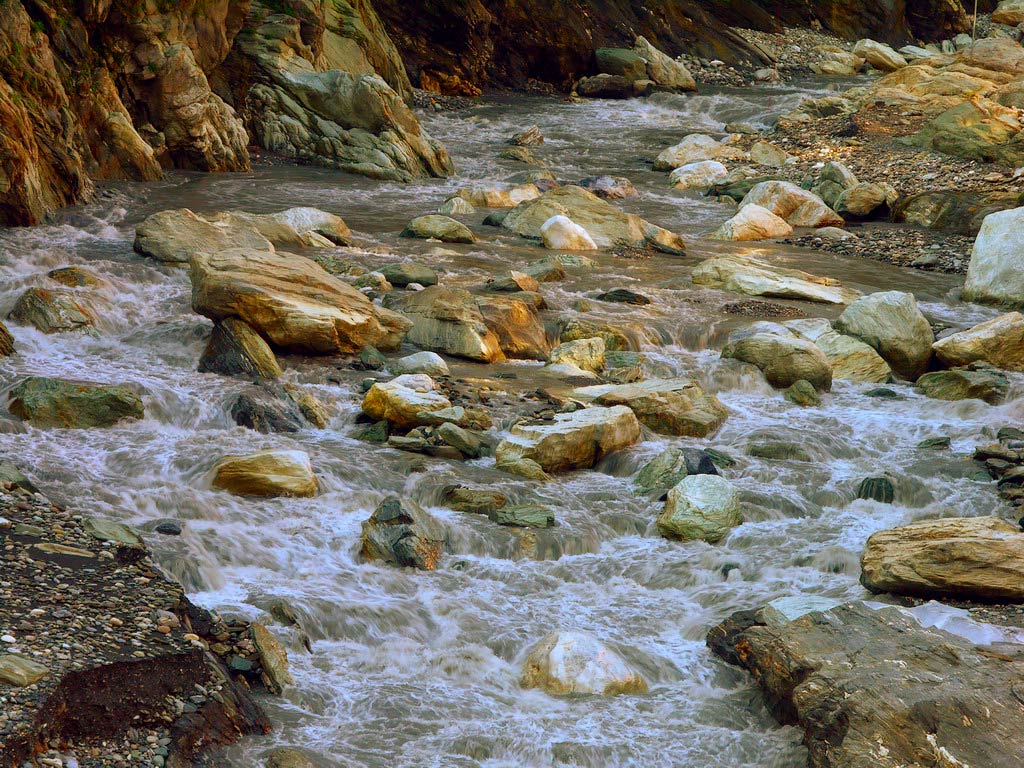

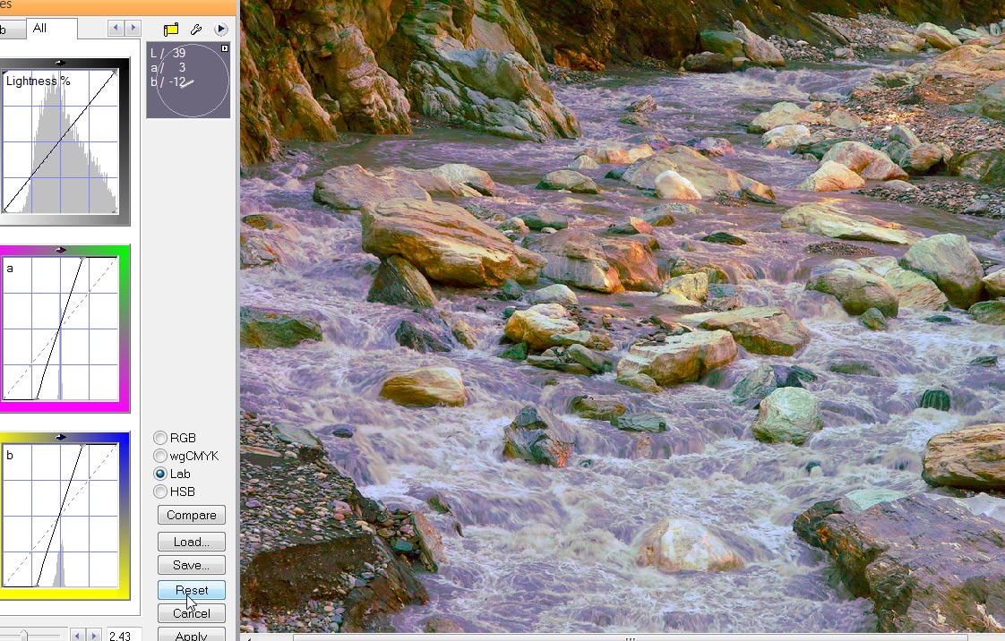

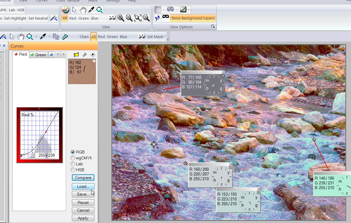

Postby sjordan93436 » Fri Sep 24, 2010 4:44 am
Did this fix it?  I found a neutral.  Then pushed the blue curve to get the water a least a little blue.
Then lab and color boost.
steve-7a-ss-jpg
steve-7a-ss-jpg (212.54 KiB) Viewed 16951 times
steve-7a-ss2-jpg
steve-7a-ss2-jpg (232.78 KiB) Viewed 16951 times
steve-7a-jpg
steve-7a-jpg (262.77 KiB) Viewed 16951 times
Postby ggroess » Fri Sep 24, 2010 2:04 pm
Much better...
I'm really glad you found so much color...
Try setting the hue clocks on the whites parts of the water and adjusting the highlight cast out a bit.  I found that a new neutral removed a lot of the blue and a slight adjustment to the Red channel made a nice difference.  I have attached my ACV file from your image.
This can be a losing battle Steve...Sometimes competing adjustments force you to close and re-open the image multiple times..or an adjustment that makes one part look good messes up the rest.  It's looking much better...

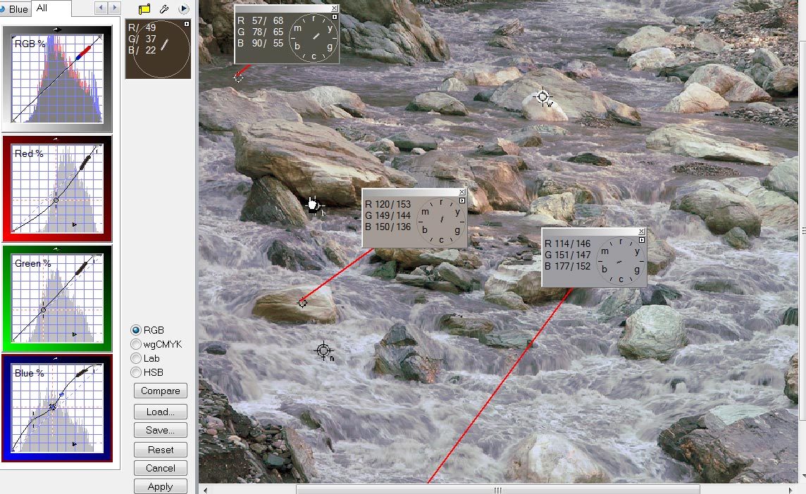

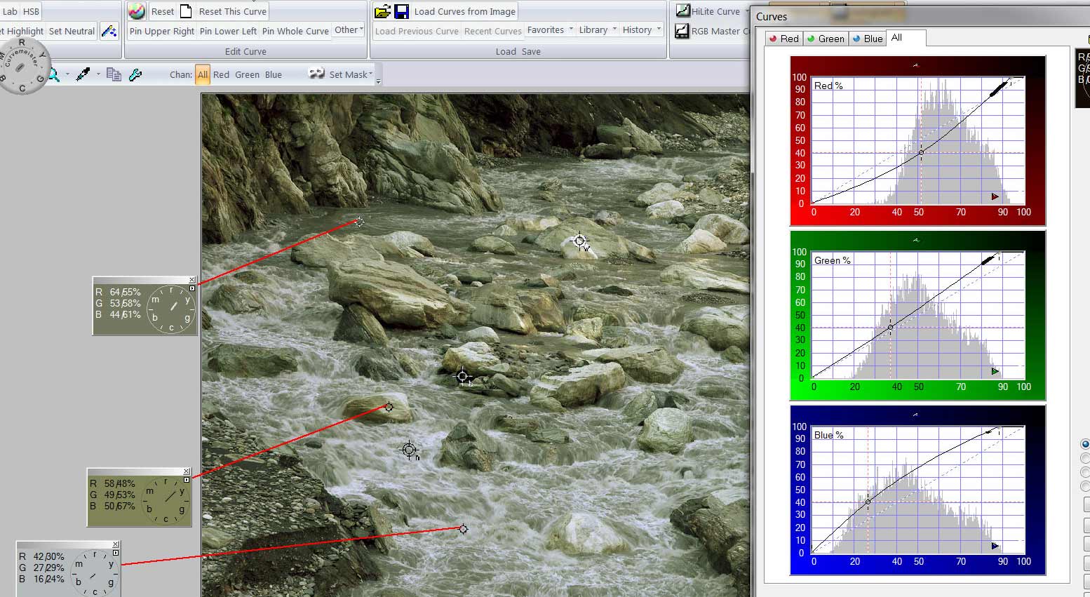

Postby sjordan93436 » Sat Sep 25, 2010 4:24 am
I tried to keep the water green and the foam white.  two screen shots,  one with the curves and one with my points
steve-7b-jpg
steve-7b-jpg (284.83 KiB) Viewed 16951 times
steve-7c-ss-jpg
steve-7c-ss-jpg (240.02 KiB) Viewed 16951 times
steve-7c-ss2-jpg
steve-7c-ss2-jpg (274.88 KiB) Viewed 16951 times
Postby ggroess » Sat Sep 25, 2010 1:58 pm
Steve...
I think you are fighting too hard for this correction...
Let's try it again from scratch.  The colors are getting way out of control.
Remember rocks do not get purple except in extreme circumstances...Earth tones are more the rule for this image...

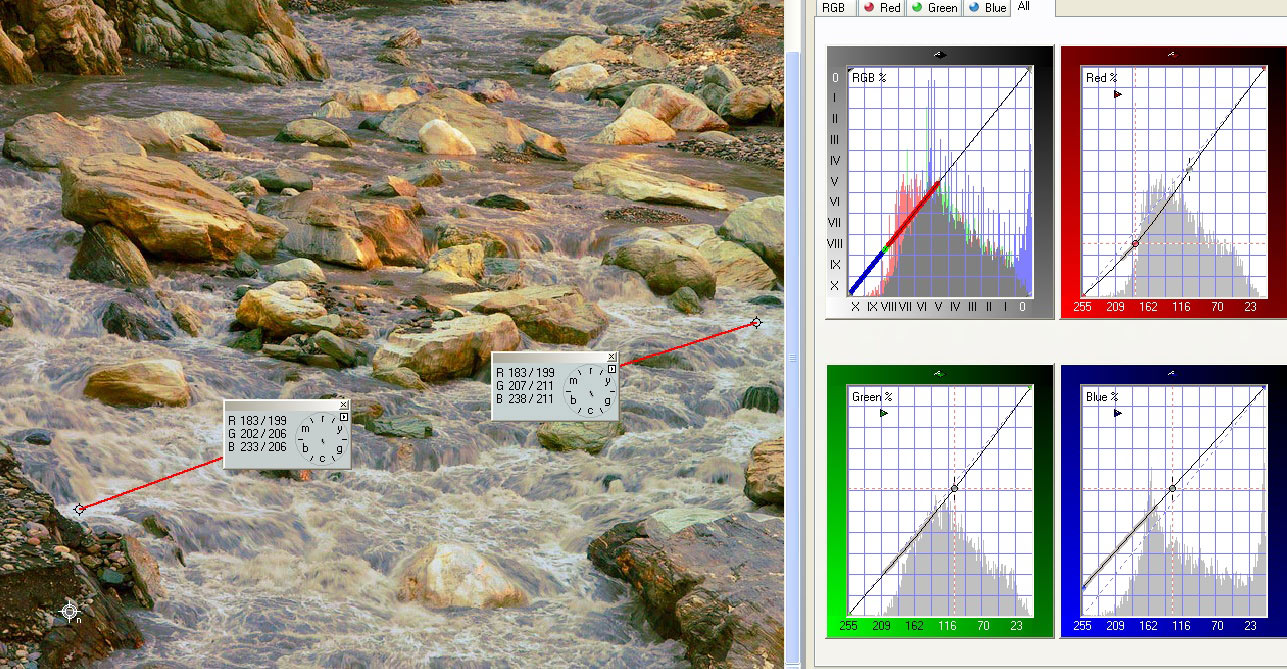

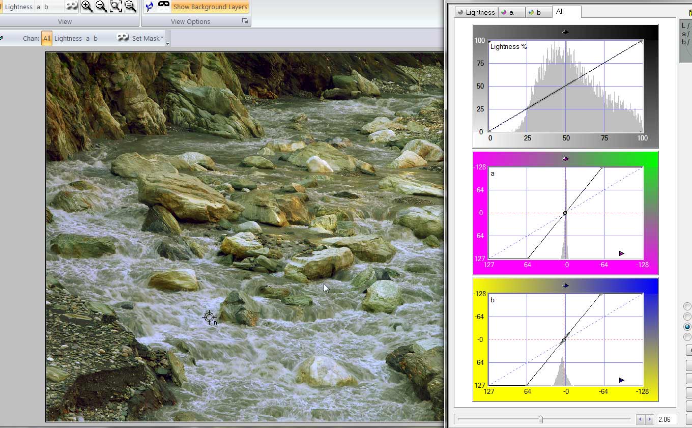

Postby sjordan93436 » Sun Sep 26, 2010 5:00 am
Another try.  I hope this is not too tiresome.  I gave up trying to make it blue.
I also added another neutral on the lab
steve-canyon7ss1-jpg
steve-canyon7ss1-jpg (192.59 KiB) Viewed 16951 times
steve-canyon7ss2-jpg
steve-canyon7ss2-jpg (162.98 KiB) Viewed 16951 times
steve-canyon7-jpg
steve-canyon7-jpg (220.13 KiB) Viewed 16951 times
Postby ggroess » Sun Sep 26, 2010 1:57 pm
Nicely done....
