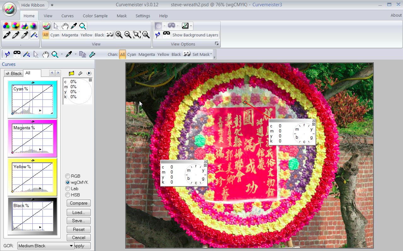

First attempt at cmyk. Don't know if I succeeded, but I tried to boost a little yellow. I tried to add contrast but lost shadow detail. (I will fix my pumpkin next). Is it helpful to attach full jpg (not a screenshot)?

Yes the full JPG is very helpful...I can look at it in Photoshop and in most cases give you a change that will take the image from where you are at when you posted to what ever fix needs to be applied.
I download every image and look in PS. But the full image is always better.

Overall you have a pretty strong Cyan cast working on this image...try setting a neutral on the gray branches on the left edge of the image...
I like to think of CMYK as Negative RGB. You are really using "inks" to make a print at this point.. so to speak...CMYK is a more subtle adjustment space, you might find it to have the feather lite touch instead of the hammer like approach LAB can have.
Remember that in CMYK the GCR is like a volume lever. The heavier the GCR the less adjustment for the same effect. Heavy GCR is the easiest to see on the monitor. The printed results...well actual mileage may vary....

In your image you have a Cyan problem...but your curve shows you adjusting the Cyan so this is natural...try this one again and start by setting a neutral. Then go after subtle color casts with small adjustments...Lastly add just enough K to make the image look full and rich without locking up the shadows.
