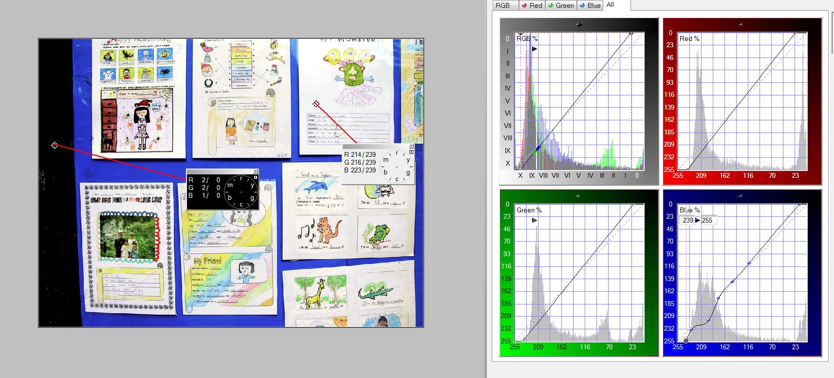

In my screen shot you can see that I rotated the curves to increase saturation and color contrast. to do this... Set a highlight hue clock and a shadow hue clock. Twist the curve so that the highlight and shadow stay neutral. you can twist the curves by placing your mouse on the curve frame so you have the double headed bent arrow and left clicking and dragging the mouse slowly left and right. the curve ends will move and the curve line will rotate about the center of the grid.
So long as you keep the shadow and highlight neutral you should be good. Do this on your posted copy. The neutral was solid and I was able to make the curve work for me...
You can load my posted ACV file on your posted image and see what I have done...
I then adjusted the blue curve but only in the area where the bright blue background was. I wanted to try to make it pop more like LAB...
Please ask any questions..

- screenshot002-jpg-41 (235.05 KiB) Viewed 9698 times

This all seems new. Maybe I have just forgotten. Do I have this right.
When I rotate the curves in EGB the second set of number on the highlight and shadow should become 0,0,0 and 100,100,100. Is that right.
I could really see the colours start to shine.
I find the shadow highlight or thresholds very hard to interpret in RGB. anu hints

When you rotate the curves in RGB it the highlight and shadow are neutral then yes the numbers will match and You can go as far as 0,0,0 or 255,255,255 on the highlight side. I move the ends of the master curve to boost the contrast a bit and make the colors pop a bit...You have to be careful that you are not moving points on the separate color channels...Master channel moves can be dangerous...or at least time consuming...
