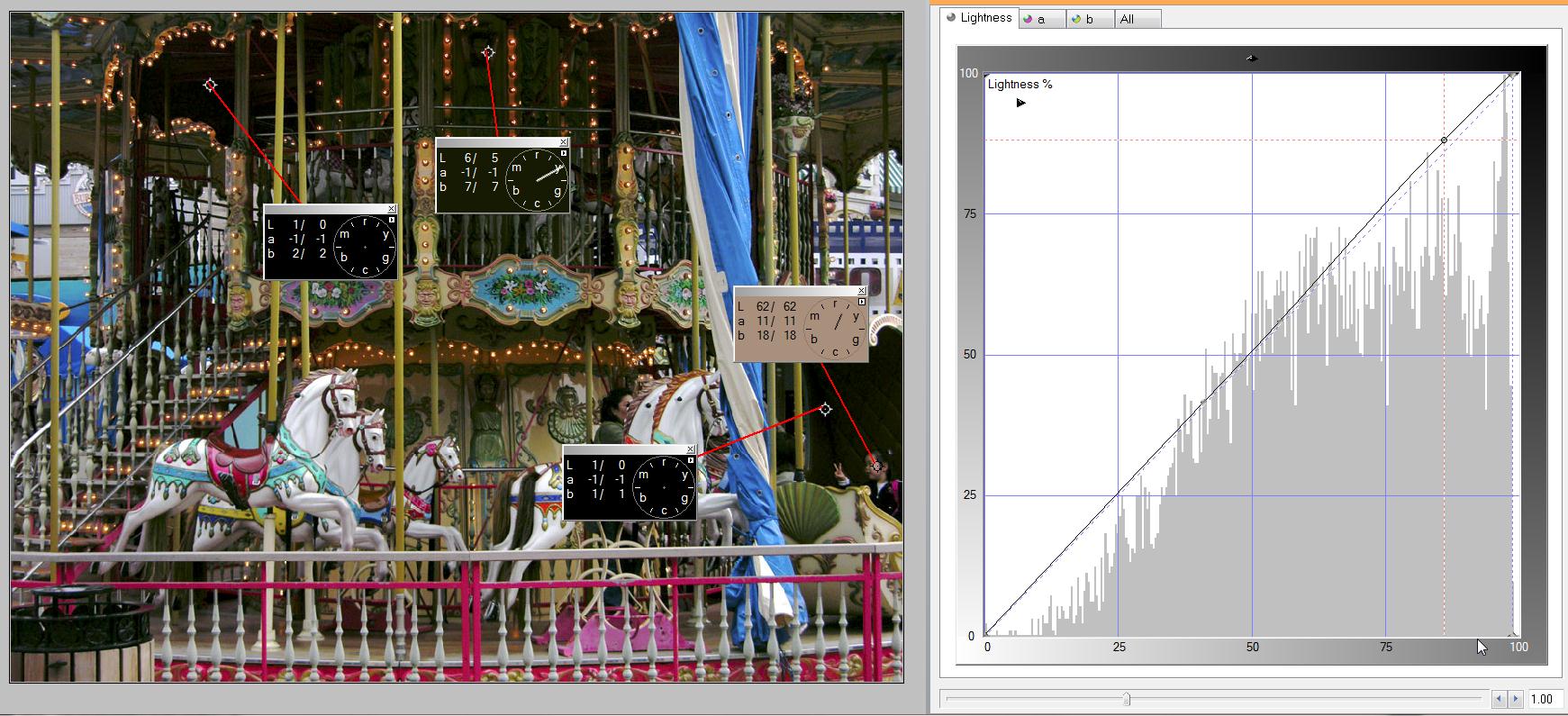

Postby ggroess » Tue Sep 21, 2010 2:01 am
I think you have done a fairly nice job with this image...If you look at my screen shot you could try this totally subjective adjustment to darken the overall shadow by 1 % in the L channel of LAB.  It is no more correct than your adjustment just different...
I think it makes the image look richer...and that may be the missing piece where you stated something is odd but you cannot put figure it out...
Try a similar adjustment and use the compare button to see what you prefer.
Let me know what you think..
screenshot001-jpg-56
screenshot001-jpg-56 (249.06 KiB) Viewed 12872 times
Postby imported_julie » Tue Sep 21, 2010 3:37 am
I can see the difference. Its slight but important. I think it adds a bit of depth. I like it more.
Thanks

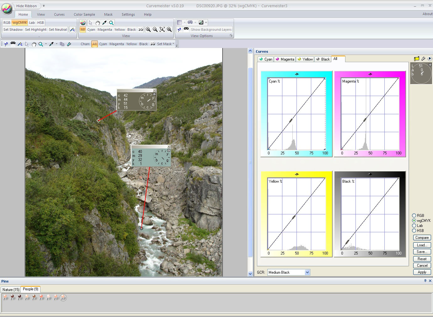

Postby ggroess » Tue Sep 21, 2010 12:03 pm
CM 3.1.0.0 is the 3.0.20 version of the program.
The title bar number is a bug.
The CMYK clocks have been an issue for some in the past.  if you are in CS5 are you 64 bit or 32 bit??
Postby imported_julie » Tue Sep 21, 2010 12:47 pm
I am in cs3. My computer says I have a 64 bit operating system. Is re-installing the only eay to get the pins back?
I just reinstalled and have pins and hue clocks again. I will try and keep a watch to see when cmyk hue clocks disappear again.
Postby ggroess » Tue Sep 21, 2010 1:46 pm
CS3 does not have a 64 bit version of Photoshop so you can run 3.0.19 I run it on an XP pc and the pins are working.  You may also find the CMYK hue clocks issue resolved for that version.
