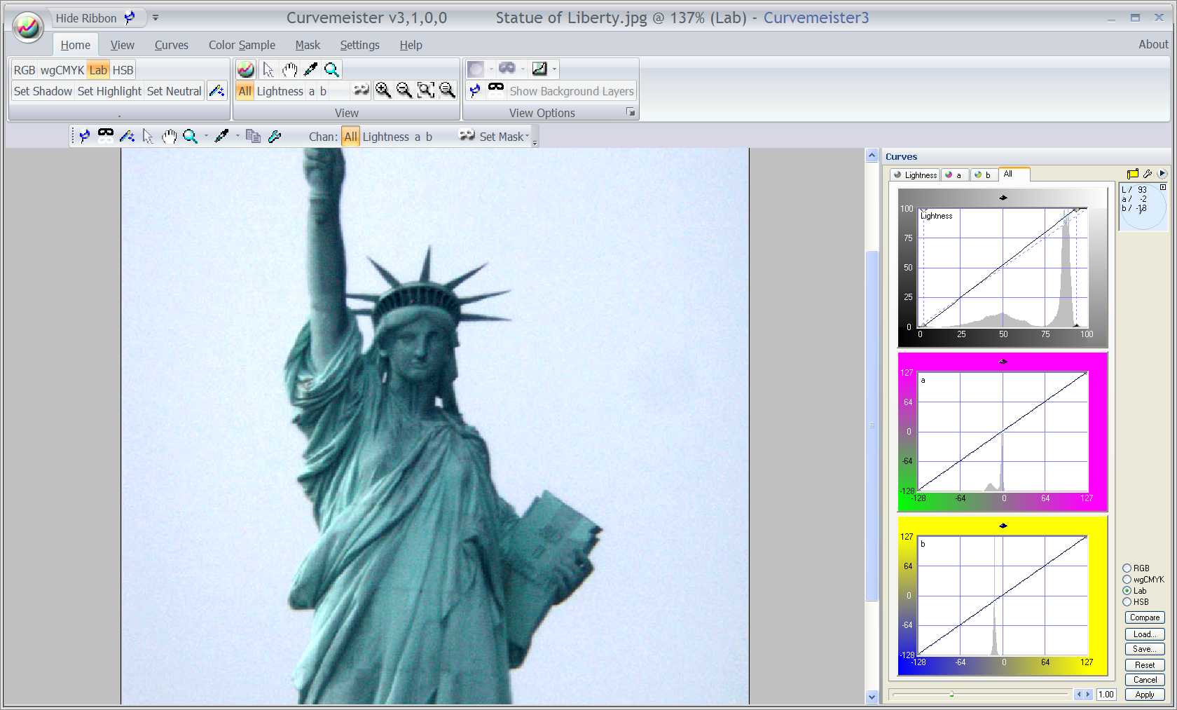

I have attached a screen shot of the page. Pin Palette is not open or I would be able to see it, right? I can click on either of the icons shown and nothing happens. If I right click I get customization options. I used that to add the pin icon to the quick access toolbar, but it too is not active.

Ouch - how embarassing. This is a bug that's been around for quite some time. On some systems, the pins will stay open if they were that way already, but once you close them that's it.
The quick solution is to go back to version 3.0.12, which supports normal pin operation. I'll see about getting out a special release for the class asap.
