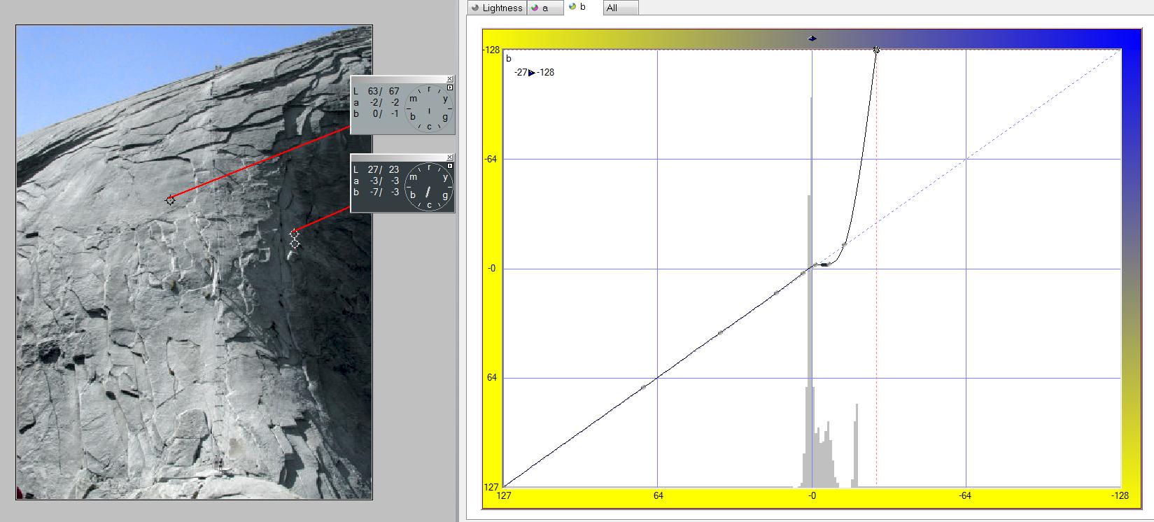

I still don't know the difference between moving a point up and down vs. sideways. In the flower I picked a point near the center of the bottom left flower and moved it to the right a tad and it seemed to bring out the small detail in the middle of the flowers. Maybe not--hard to tell.

RE: Up Down Left or Right.
A qualified depends.
In lab if you move a A or B Channel point Up or Down you have the effect of desaturating the color. A L channel point can effect lightness and contrast.
In lab if you move a A or B Channel pointLeft or Right you increase saturation and you can change a local color. For instance: if you want to kill off a color cast in a specific shadow area you can adjust a very narrow portion of the B channel and only effect the color you want. See shot attached. the point near the center was moved right which in effect moved the curve down...
In most cases the net effect is the same. "the qualified depends" comes into play here...some times when you near the corners you cannot move the point horizontally you have to move it vertically. Sometimes when you have the curve pinned down pretty hard you have to move a direction and cannot get there in the direction you want...again "The qualified depends"
- screenshot001-jpg-58 (141.36 KiB) Viewed 9346 times
