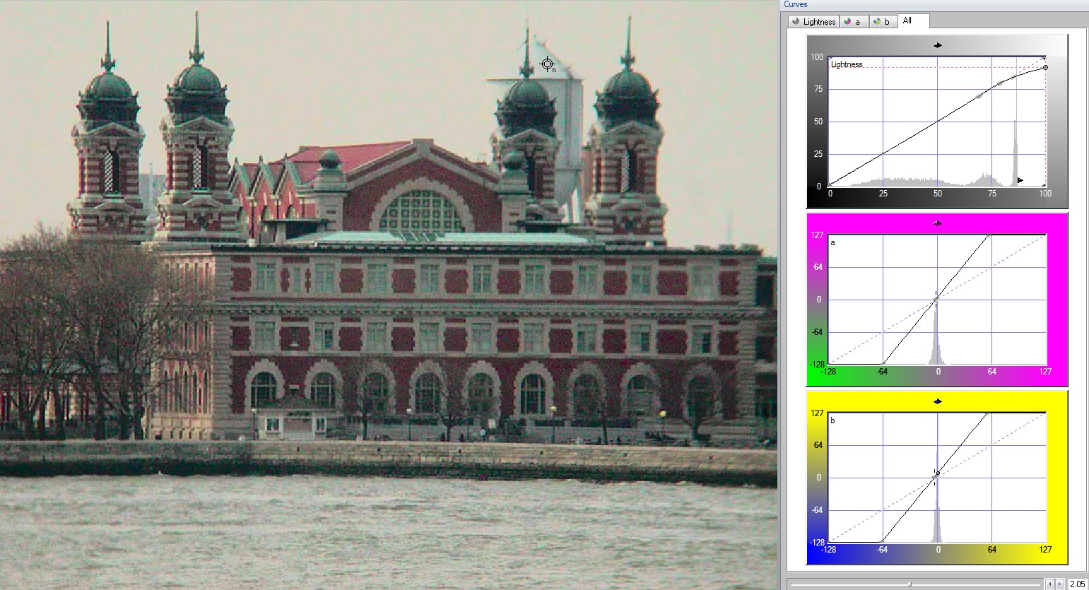

Layer1 Lab neutral on water tower,saturation boost,cut back sky lightness

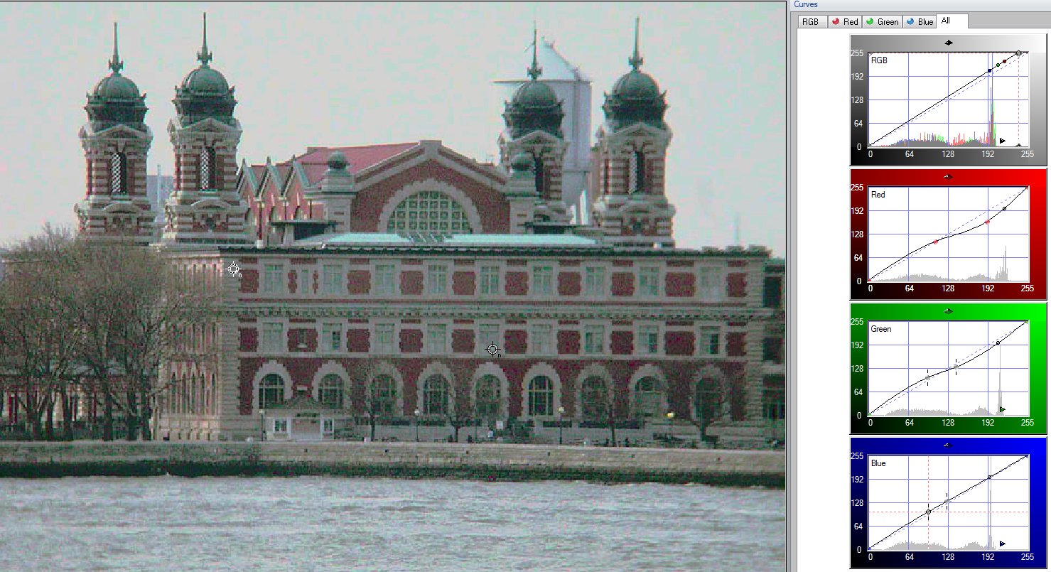

Layer2 multiple neutrals(you can do it in RGB)
Layer3 filter>sharpen GregM

- ellisfllab-jpg (264.58 KiB) Viewed 13684 times
- ellisflrgb-jpg (257.01 KiB) Viewed 13684 times
- ellisfle-jpg (230.49 KiB) Viewed 13684 times
Thanks, Gremurphoto--I like your result. I see what you did in RGB, but I don't quite understand how what you did related to what you said about "multiple neutrals." The points on the various curves don't make sense regarding neutrals, especially the ones in the combined RGB channel, which look high for neutrals. In the Red, Green and Blue channels you also have a point set high in each curve. Were those points to stabilize or "tack down" the curve? I'm surprised that such a little adjustment in the color channel curves made a noticeable difference. If I have time, I'll try it myself. (Hmmm--in continuing to ponder the points on the curve, do the ones in the ALL box in the RGB mode reflect a culmination of the "tack down" points in the other curves? If so, it does make sense.) I hadn't thought about doing the CM in a layer--do you always do this? How is this accomplished? Thanks again.
Rhonda,
Please remember that a neutral is different from a mid-tone.
In RGB you can have multiple neutrals based on Brightness. The shadow Highlight and "Mid-tone" can all be neutral.
In the color correction "world" neutral in RGB is all three colors RG and B being the same number on the hue clock or on the numbers pallet.
We leverage the RGB color spaces ability to have multiple neutrals to help us remove color cast from a shadow or highlight without messing up the mid-tones. In fact in advanced work flows you start in RGB for color correction then switch to LAB for color boost. You get the best of both worlds.
Generally we talk in terms of 1/4 tone, mid-tone, and 3/4 tone; to mean the density and tonality. This is separate from color. Once you separate these in your mind it gets easier to understand the curves you are working on.
CM in a layer is a great way to use the tool. It allows you to adjust the correction if you get back to PS and find the correction is over powering the image. To use CM on a layer just make a copy of the background layer and have it selected. Open CM and work on the the image. Your changes will apply only to the layer and you can adjust the opacity to suit your needs. Another great use for this is to make adjustments in a layer and set it to "Luminosity" mode and use curves to adjust contrast and luminosity.
Points on the RGB master curve and most likely for tonal control not necessarily pinning the curves to a specific point. They can be for tacking down the curve but in general Greg M usually does not work in that fashion...
