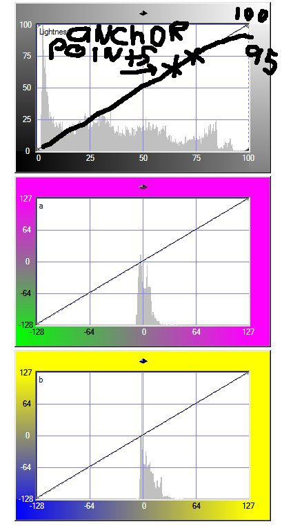

Alt click gives a hue clock. Easy. Next with options the hue clock can give numbers and graphical.
It is okay to correct by eye, BUT there are advantages to by the numbers. Small color problems are hard to see by eye. Why bother? Well, if you boost the color, small problems become large.
Second reason, with a little practice, you can correct much quicker.
Third, (for me) there are problem images that are very difficult to correct by eye.
So if any of those issues are important, i.e. color boost, quick accurate corrections, or fixing difficult images then you should learn skills to do that.
Look at the before and after of some of these drills. Use PShop elements or Lightroom without curves and see the output.
LAB or RGB- LAB can easily boost colors. Run CM and wizard then run the color boost. It will accentuate any "errors" in the color. If the skin is (wrongly) red, it will turn REALLY red. If color boost is good and you need it, then learn the skill.

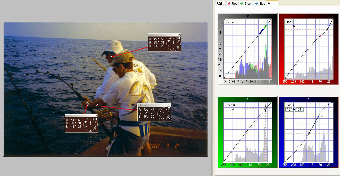

And now for your image...
One of the tricks you will learn is that you can take an image through the CM process multiple times. Once in LAB and once in RGB for instance to fix different problems.
I started in LAB with your image because I wanted to adjust the lightness to see what I could get out of the image. Also having LAB in the tool box I know that one of the channels allows me to adjust Yellow and Blue separately. Your description told me you wanted to keep the yellow light feel so i wanted to make sure I had enough yellow light to work with...B channel in lab holds all the yellow in the world for you.
I then took the image into RGB to set the neutral and the skin tones. Since in RGB color and brightness are linked I know i can adjust the overall neutral and still set a skin pin on a dark skin area. That is the screen shot posted and the second ACV file.

If RGB then 100,100,100 is a neutral. 50,50,50 --- 0,0,0 black plugged. 255,255,255 white blown out.
LAB xxx,0,0 is a neutral. positive warm, negative cold.
Skies should not be cyan. LAB- b is negative, a is near zero. (can be slightly negative)
Faces - A and B positive A more than B except small children and light skin.
Greenery - A neg B posi. B is more positive than a is negative
Curves are a graphical method to convert colors. Move a curve and the color changes. If it is on a 45 degree line, it is original.
You can do something similar with the sliders of PS or PSE or ACR or LR. It is quick and easy, but far less precise. I would further argue that there are corrections that are impossible to do with sliders.
So if you want to repair the impossible (some of them) OR you want more colorful images, you need curves. And Curvemeister is a fine tool to do this. Think of it as PS curves on steroids. I am sure some of this stuff is like jibberish.
