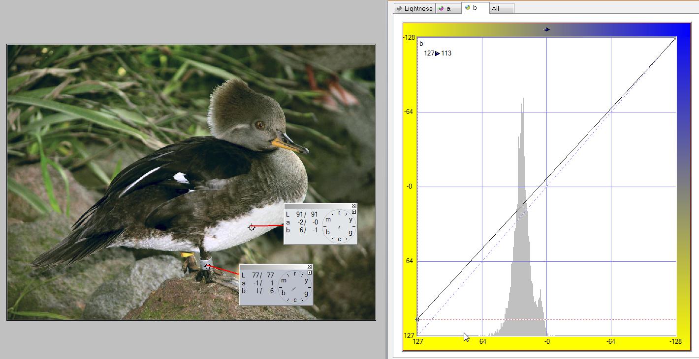

Image 1. Ducks lab
Image 2 Ducks rgb
The lab was more colorful.

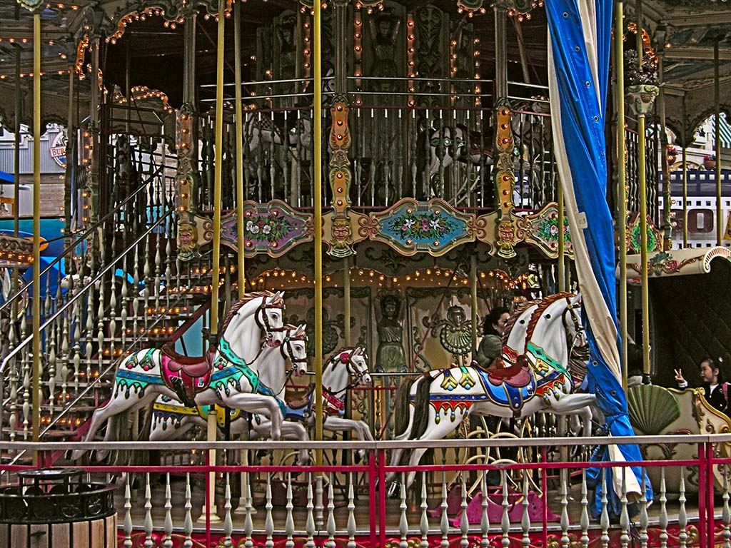

Image 3- Merry go round. there are a couple of pitfalls here.

Image 1 ducks...
The RGB version looks just fine...You will learn later on that there is more we can do but for this image today It looks good.
The LAB version seems to have a yellowish cast on it...It is slight but real...try moving the neutral around a bit and see if you can find a location for it that looks better...
See screen shot.. By lifting the yellow end of the curve a bit I can take out some of the cast. This also moves the neutral a bit so you can do either lift the the B channel a bit or move the set neutral point.

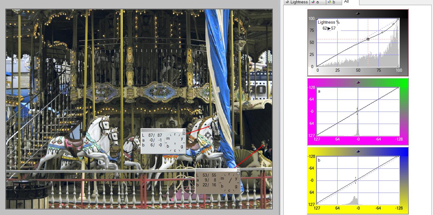

The merry go round Image.

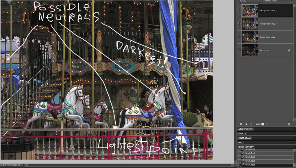

Steve, when you tackle these are you setting a neutral by eye or are you looking for items that should be neutral?? This image also has a slight color cast and it is consistent with the Ducks...once we know what is causing the cast we can account for it or help you adjust your way out...
When you place the neutral you should look to the hue clock on the upper right hand side of the CM window. In lab you want A and B to be zero. In RGB you want the values whatever they are to be equal.
One of the goals for the image is to open the shadows...Using LAB remember that the lightness is separate from color and you can adjust it without introducing a color cast. You can add what is sometimes called a "lizard tail" to the L curve to open the shadows. See the screen shot attached.
- screenshot003-jpg-24 (194.61 KiB) Viewed 15415 times

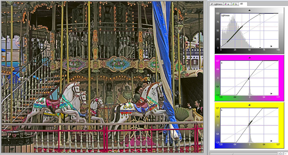

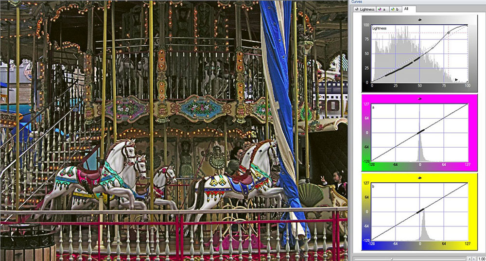

Steve,for the merry go round picture I think of the horses' necks and the little girl's face.Get them right and the rest of the image falls into place.GregM
first pass in Lab to establish shadow,highlight and neutral.The shadow point may seem odd but if you go to the original image(right click and move it around) you'll see it results in the fewest black pixels.The same for the highlight,if you use the white of the horse you blow out the image.The neutral is tricky,there seems to be a lot grey or light greysto choose but move the cursor over them and you get A and B channel readings of 0,-6:7,-4 anything but the 0,0 of a true neutral.I put an S curve on the lightness curve because the image had lost contrast.
second pass was to add more contrast finishing up with a bit of sharpening.
- sept10mgrsnap-jpg (238.94 KiB) Viewed 15415 times
- sept10mrgsnap2-jpg (231.54 KiB) Viewed 15415 times

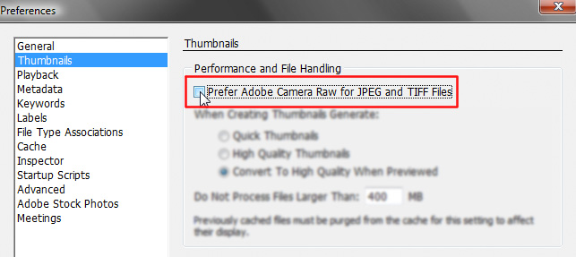

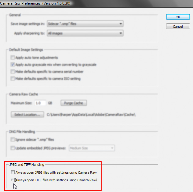

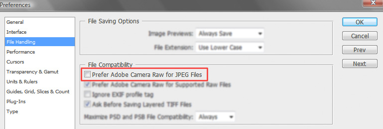

Hi Steve,
I wanted to jump in to see whether I can help you with the Adobe Camera Raw issue that you described. This is most likely being caused by the way that the Preferences files on your machine are set up.
My Windows machine has Photoshop CS3 installed, so the screenshots that I've made might look slightly different from what you see, but the process will be the same regardless of which version of Photoshop you're using.
Adobe Bridge (if you already have Photoshop open, you can open Bridge by selecting: File > Browse...)
Next, choose: Edit > Camera Raw Preferences.... You should now see a window that looks like 'ACR_Prefs.jpg' (attached).
Make sure that the highlighted checkboxes at the bottom of this window are turned off (strictly speaking, you only need to worry about the 'Always open JPEG files...' checkbox, but turning them both off will prevent you encountering the same problem with TIFF files).
Having done this, you need to:
Adobe Bridge Preferences (Edit > Preferences... - select the Thumbnails tab),
And check the Adobe Photoshop Preferences (Edit > Preferences > File Handling...).
Again, I have attached screenshots that highlight the checkboxes that need to be turned off.
I hope that this helps. Please let me know if you continue to have trouble with this. :)
- Firstly, open
- Check the
- acr_prefs-jpg-jpg (68.25 KiB) Viewed 15415 times
- br_prefs-jpg-jpg (59.22 KiB) Viewed 15415 times
- ps_prefs-jpg-jpg (52.89 KiB) Viewed 15415 times
