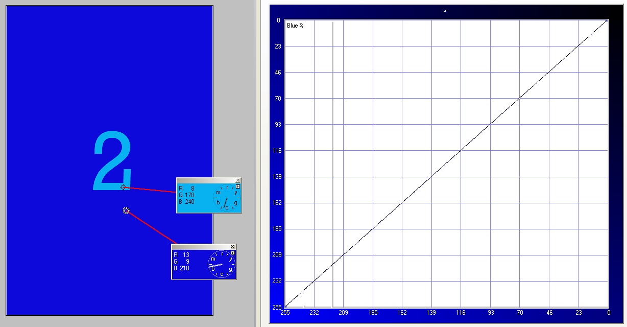

Shot1.) Open the Image in RGB and set two hue clocks. One in the Dark Blue and one in the Light blue. Notice the readings..
In the light blue color the Green channel is adding to the color (G=178) so we will have to go get rid of the green at some point. The hue clocks are directing me at this point...I could use a PS tool like lasso to go get the shape as a selection and then open the sample pallet and figure out the RGB settings for the background and then make sure the number has the same values using a paint bucket or various other tools but why when I have CM open and ready...

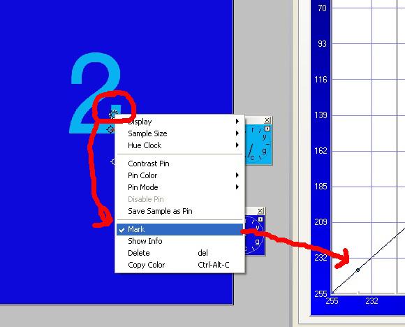

Shot 2.) Right click on the number in CM and select "Mark" This marks the curves grids in each channel with the location of the color I want to change.

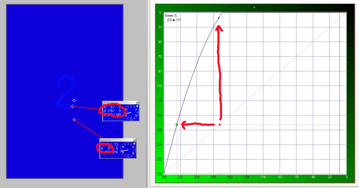

Shot 3.) adjust the green curve from the "marked" point by moving the curve to the left as shown. This forces the marked point to move "up" as shown by the arrow in the grid The marked point is now at the top of the frame. Notice the numbers have changed for the green sample point. I have moved the green point down to 9 from the original 178.

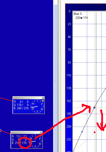

Okay, so you have the mark in the blue channel, you grab it and move it which way? I don't understand how you know where to place the other control points. When I move the mark in the blue curve, the dark blue color changes in the entire picture.

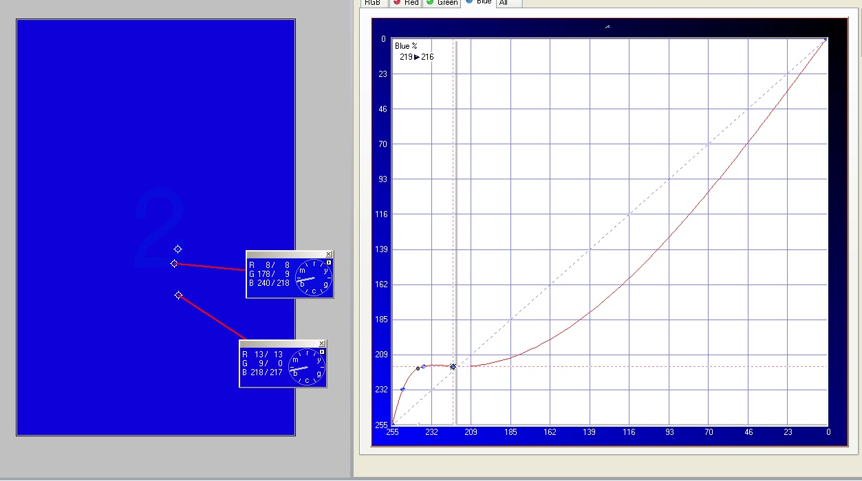

I'm going to break this one down with screen shots...

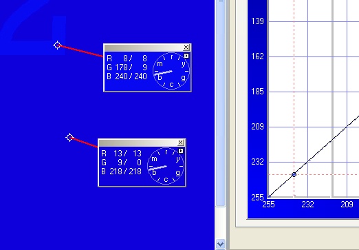

1) Start with the "mark" you placed on the Curves before. In shot1 I have that point selected.
2)Because I want to change the value from 240 to 218 I have only 1 direction I can go...Up...Shot2.

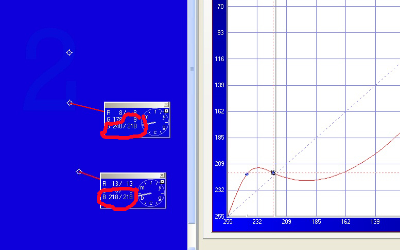

When I do this the background drops out...to a darker blue..because every point on that curve has moved along with the selected adjustment point.
3) I need to move it back. I selected a point at about 170. The grid markings give me that range as well as the numbers in the upper left of the grid. I move that 170 value straight back down until it hits 219. Shot3.

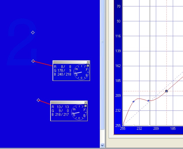

4) I can stop there but I like to clean up a bit and make sure the curve is pulled back to near the center I simply add a point that allows a comfortable curve back to the center line. Shot4. In other corrections this will be a very important part of the process; since we have no other details in this image we can get away with it.
