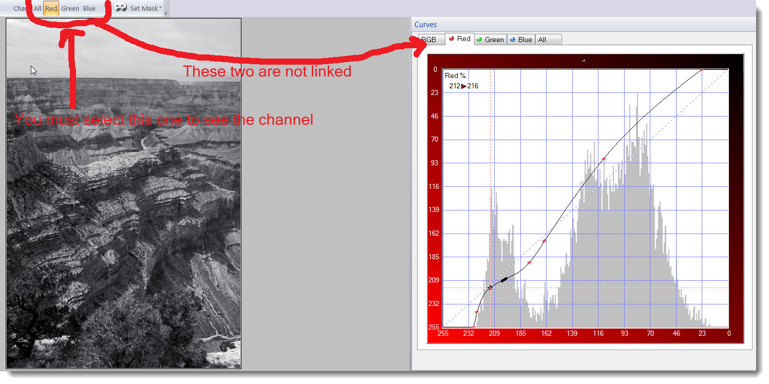

If you use Elements you can do almost the same thing by creating a layer copy and using CM to adjust each channel separately by clicking on the channels view in CM...See Screen shot...Ignore the colors as you will be applying the layer in Luminosity mode again...
- greg25-jpg (271.05 KiB) Viewed 53569 times
