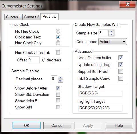

Is there any way to set the sample size to stay at 3x3 instead of constantly having to change it from 5x5 to 3x3?  Every time you open CM, the sample size is at 5x5, and it gets annoying to have to keep changing it to 3x3.
Postby ggroess » Fri Oct 01, 2010 10:12 pm
Are you setting it using the Config wrench?  It should stick from there...
screenshot001-jpg-47

screenshot002-jpg-36
screenshot002-jpg-36 (47.63 KiB) Viewed 70702 times
Postby mikemeister_admin » Fri Oct 01, 2010 10:33 pm
No, I didn't realize that was how to set it.  I kept clicking on the wrong thing.  I noticed that you have the shadow target set at 5, 5, 5 and the highlight target set at 250, 250, 250.  Any special reason for that, as opposed to 0, 0, 0 and 255, 255, 255?
Postby ggroess » Fri Oct 01, 2010 11:15 pm
For me this keeps the highlights and shadows from being clipped if I drop below these levels.
I use it for printing locally and in general to preserve the extreme details.
Many people use these settings at even higher levels..you might want to play around with them when you print something.  They can save you sometimes...If the highlight and shadow in your image are not outside of these settings you do not need them.
