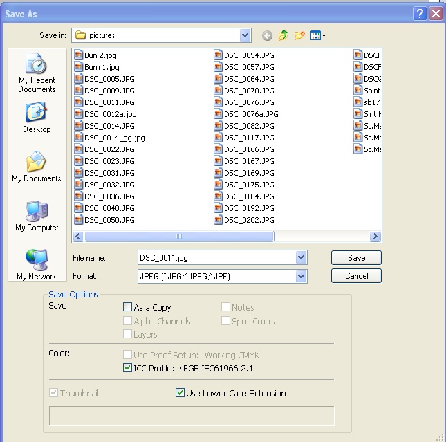

Something I keep seeing that bothers me is when I work on an image in Photoshop (CS3) and get it to where it looks good, I will save it, then later open it in another program and the colors aren't the same.  If you adjust an image by the numbers, then it should be okay, but when you start using pins, then the final result won't be adjusted by the numbers anymore, so you have to go by what it looks like.
This is related to the color space you are saving the image in.  If you are using Adobe and you have the ICC Profile check box selected as shown in Shot 1 this profile is getting tagged to the images.  It is "generally" the profile you want to use for most work.  If the program you are opening the image in after Adobe uses another Color space or interprets the sRGB space differently you will see a difference.  I sometimes run into this with images posted to the web...some people have different default color spaces set.

shot1-jpg-18
shot1-jpg-18 (126.04 KiB) Viewed 31090 times

Thanks for reminding me of that Greg.  I had the ICC box checked and I used the sRGB profile, when I used Photoshop version 7, but I just started using version CS3 and forgot to check it.  :-[
