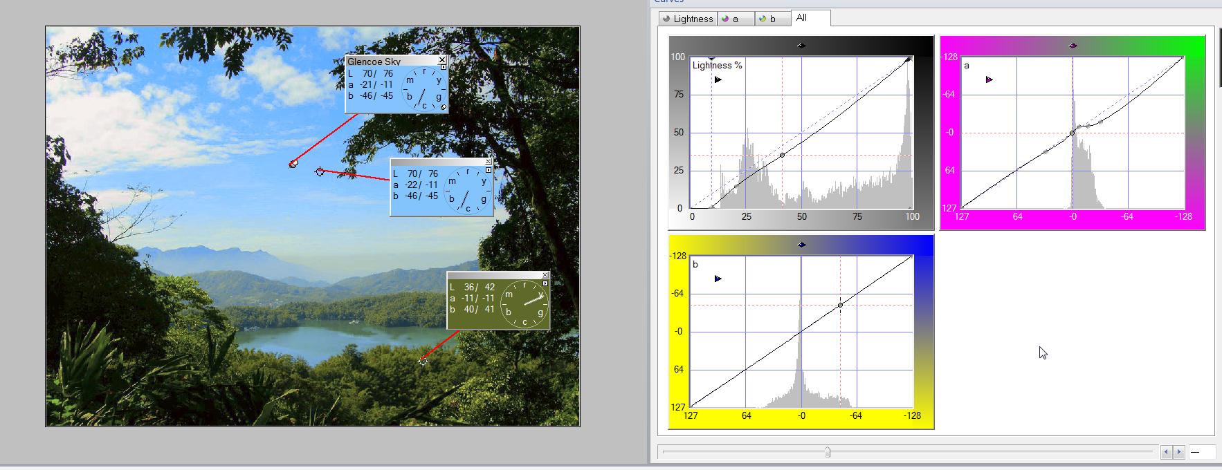

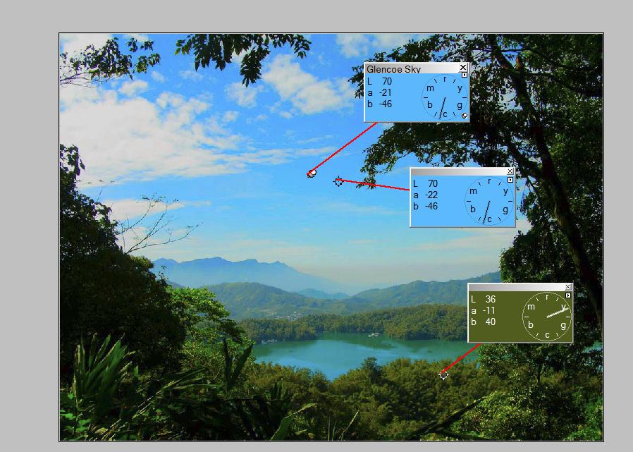

OK the explanation is pretty simple but; I was having trouble with the sky color overall.
It is too cyan and that cast runs all over the entire image. Since you were working LAB I tried to make my corrections in LAB as well. Since there is no neutral I used a Pin from the pins folder called Glencoe Sky. Since the Greens are also in trouble I adjusted the A curve to help them out...
In fact from where the image is right now a RGB correction is pretty tough...
I have attached the acv file.

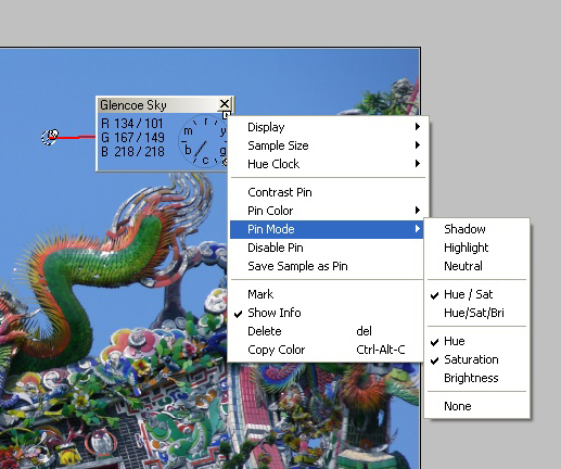

Pins: When I pin, it pushes the curves in the "right" direction. Sometimes (?) the pinned point is not the same value as the pin. In LAB, for example, the a and b seem to be right, but the L may differ. I assume that in RGB and HSB the act of pinning fixes the color but sometimes leaves a point darker or lighter than the pin.

Check the Pin Mode..Sometimes they are set to Hue and saturation but not brightness.
See shot1: the top red mark shows a right click point. You will get the fly out menu shown in Shot2.
the bottom red marked area has a marker for de-activating the pin. this allows you see the effect of the pin and decide what you want to do.
