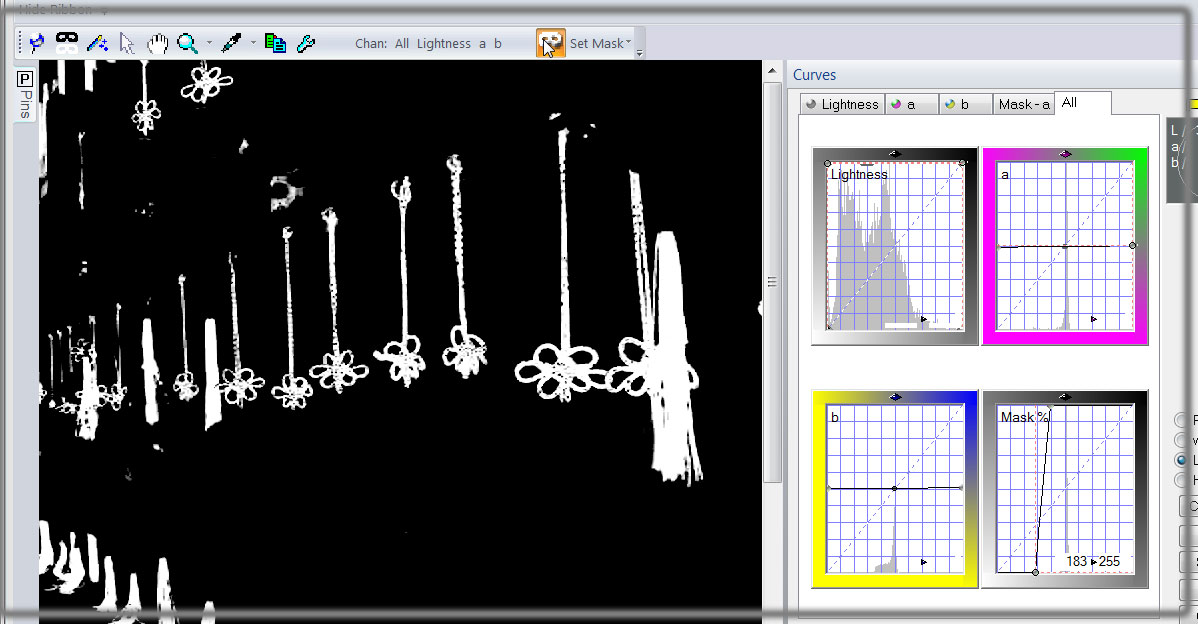

Postby ggroess » Mon Oct 11, 2010 7:22 pm
Steve this can be done in 1 pass through CM..
Open the image in LAB and mask off the tassels as you have done...
Then Rotate the A and B channels until you have a nice neutral gray tassel.
Then Curve the L channel to make them black.
Hint..Soften the curve on the mask a bit so that some of the shadows show up...this allows the color correction to bleed into the shadows....

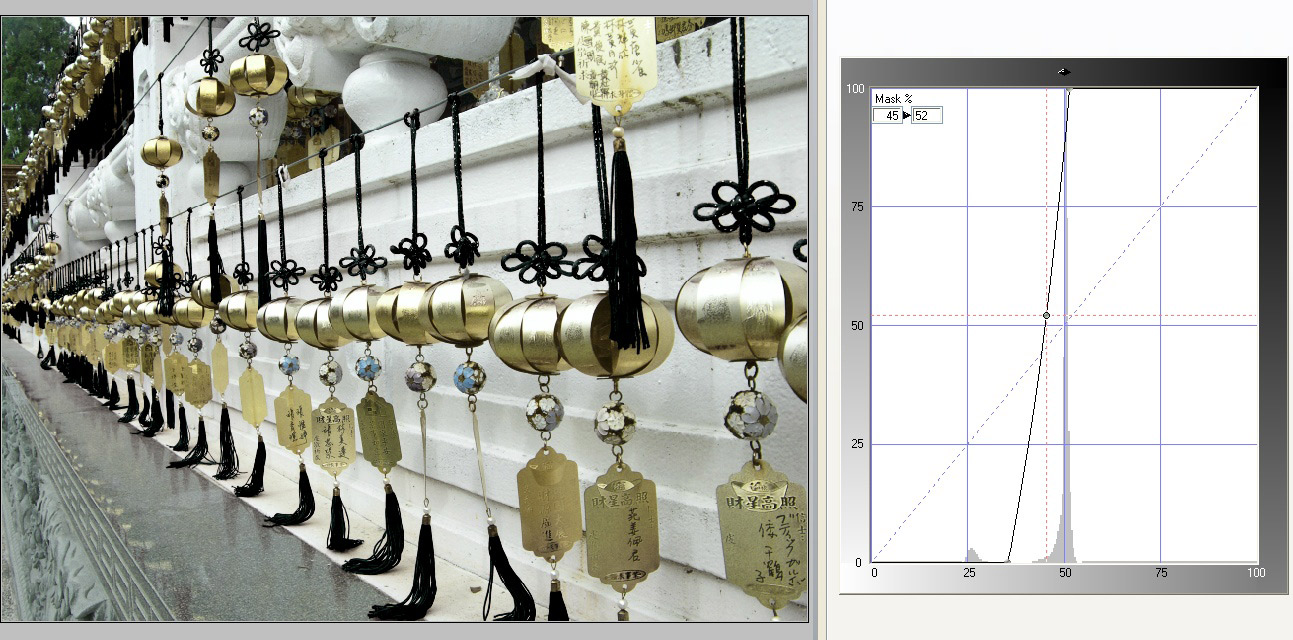

Postby sjordan93436 » Mon Oct 11, 2010 11:03 pm
Sort of like this.

Postby ggroess » Mon Oct 11, 2010 11:28 pm
Sort of...you want the shadows to be visible in the mask as well so that they are not red.  Instead of a hard line mask soften it by adjusting the Mask curve...
You can do that while still in CM.
