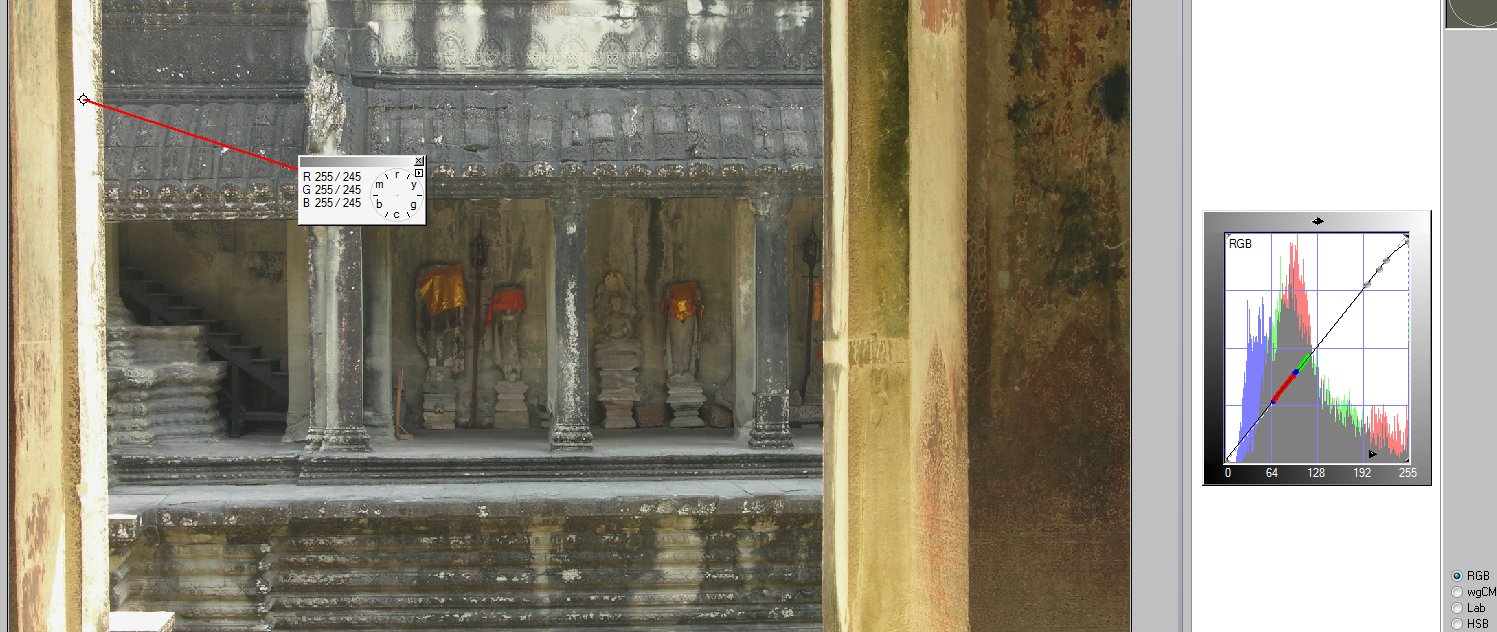

It really bothers me that the highlights in the left doorway are so blown out. Is there a burn tool in Curvemeister?!

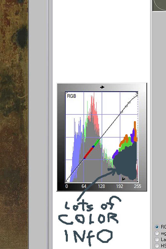

To gremurphogo: you said: You could try this as your first layer.Ten points is a bit more than I would usually use and I wouldn't do it if there was a lot of color information between 192 and 255,colors would be affected.GregM
Sorry, I don't have a deep enough understanding of colors to know if I have a lot of color information between 192 and 255. Do you mean by looking at the histogram of the channels? Why would the number of points affect the colors that you were trying to improve by setting the points in the first place? If the answer to these questions is complex, better for you not to try! :)
No but you can try other things like masking to see if you can make this right....

You know enough to know the highlights are blown out a bit...If you click on the highlight threshold in RGB you will see that there is color information in the frame of the door. Greg M is making a fair observation and stating his preference. I'm not going to put words in his mouth; I'd say try it both ways and see which you prefer. I believe he is saying changing the highlight by that much might make it worse or make it stick out...
I used a few points close together to stop the diagonal from assuming an S shape when I lowered the top right and affecting the main body of the image.As the part of the diagonal you're bending becomes more horizontal the more dingy the highlight area becomes.The range of correction very small,but works on this image to tame that wall a bit.The location of the pins was to con tain the effect to the area approaching 255,255,255 white.
In the histogram below the new blob of pixels suggests an area of an image with detail and color and a move like I described above could affect a larger,different area of the image.I would rather make brightness correction to this image in Lab or HSB then move to RGB for the color.GregM
