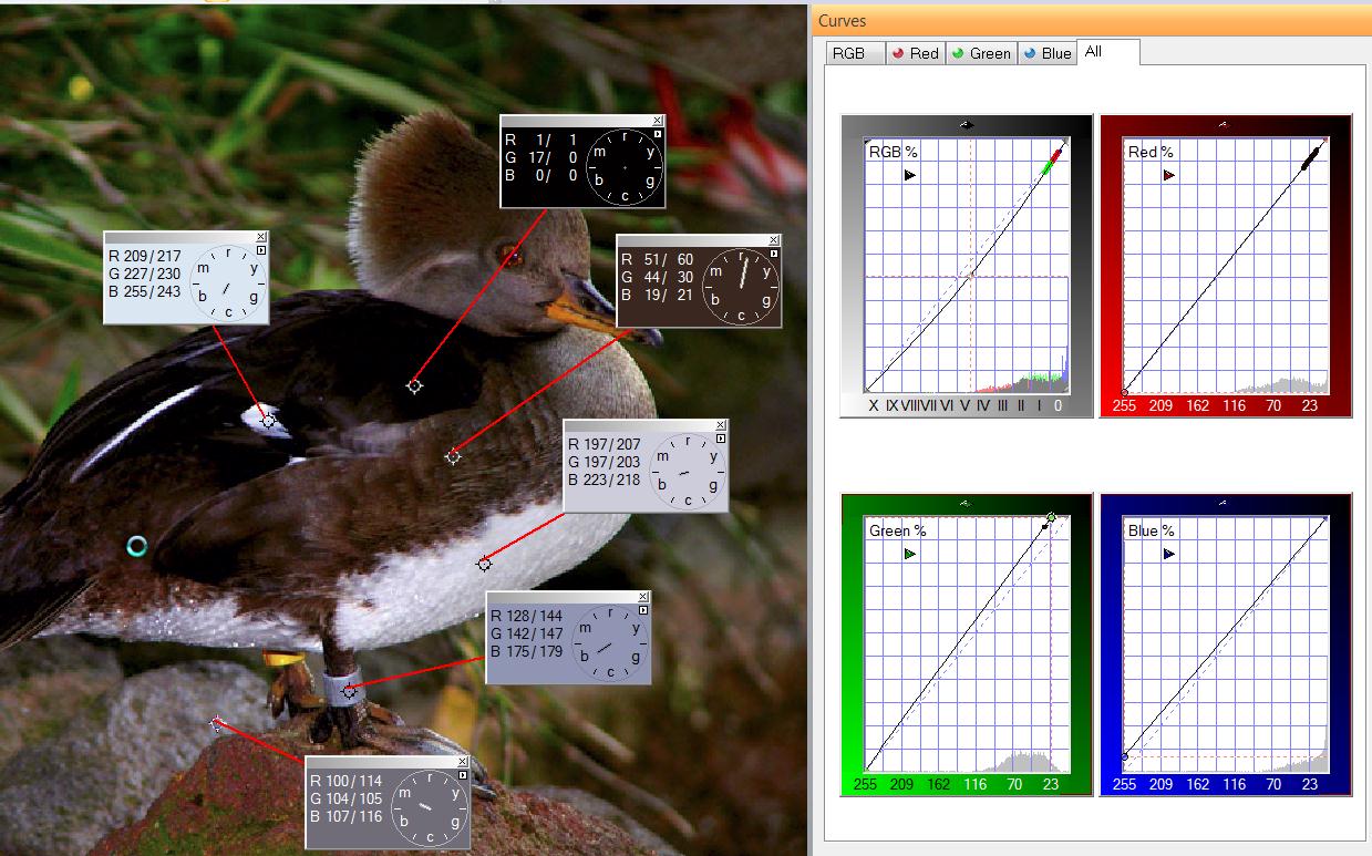

Rhonda,
Overall I think you have a green cast in the shadows and a blue cast in the highlights...See my screen shot.
This is a touchy neutral...Please check your sample size 3X3 might make it hard to find a good neutral. You might want to go to 5X5. If that doesn't work try 4X4.
The Band is usually a safe bet. It is aluminum and has been used for quite a while to set this neutral.

- screenshot001-jpg-61 (170.8 KiB) Viewed 17820 times

Rhonda,
If you have done this with the wizard I commend you...that is a very good correction using the wizard. Numbers can be a deep subject but i think people put too much into it. I try to keep it simple and I am sorry for the confusion...( Waves @ Art )...
The Idea behind numbers is that you can find known points in the color scale by looking at the numbers. Think of it as mixing paint. When you go to the hardware store and order paint they have a recipe for the "hue" that you want to buy. They mix it "By The Numbers". In CM we use the hue clock and numbers to help us find our way back to a known value like gray.
In RGB the leg band on the duck should at some point be neutral. By the numbers we express that as (XX,XX,XX) where the xx's are replaced by a number. It can be any number between 0 and 255. 0 is total black and 255 is total white. In your duck the sampled point reads 144,147,179...wow...what does that tell me....
The numbers are R G B so the R value is 144 the G value is 147 and the B value is 179. They need to be equal to be neutral. the closest neutral to your current setting would be 145. so making each value 145 by adjusting the curves makes that sample point neutral and by extension adjusts the rest of the image.
If you have picked a "wrong" sample point and you make it the neutral the rest of the image looks all messed up. You would then need to find another neutral...you see this in the wizard when you move the neutral point around. When you set a neutral you are telling CM to make the RGB values (numbers) all the same under the sample point.
In most cases until we get to the "By the Numbers" corrections the hue clocks are sign posts on the road and they just give us direction. We can choose to ignore them but just like road signs; you ignore them at your own peril.
Lab is a totally different color space and it has it's own rules and numbers. That is why it is so confusing at first. The grids do not make sense and the numbers are all messed up...
In LAB the color is separate from lightness. (L channel) This allows you to adjust the contrast and lighting without touching the color...Very powerful....The A and B channels contain all the colors in the image. The trick is that the exact center of the channel grids is neutral. We express that as 0,0 for lab. So when you set a neutral in LAB you are telling CM to make the point selected to be (X,0,0) Where X can be any brightness value from 0 to 100. Every Color in RGB has a matching LAB color but Lab actually has more color in it that RGB cannot see. There are LAB values tha tRGB cannot create..they are considered "out of gamut" and we need to be aware of them but not afraid of them. They are usually very strong colors that would ever be printed. There are exceptions and actual mileage may vary....
I'm hopeful that by looking at the numbers in the duck and reading the explanation above they will start to make sense...If not please keep asking...it is one of the things you came here to learn.

Whew--that was a great reply, Greg. I sort of get it. OK, if the exact center of the grid in LAB is neutral, is that not the same in RGB? In an RGB curve if I want to effect the midtones, I place a spot on the middle and go from there. In an RGB curve I can work on each color separately or combined. I usually work combined. Is the purpose of the RGB curve to affect the brightness and contrast of each of those channels, whereas in LAB, only the L channel affects the brightness and contrast, and the A & B channels affect the colors. (I'm trying to translate what you said into my words to see if I get it.)
So how could you tell that I had a green contrast from the numbers? In my sample of the wing the numbers are:
R 209/217
G 227/230
B 255/243
So:
What are the two numbers separated by the slash? Why wouldn't neutral be
L X/X
A 0/0
B 0/0
If the color didn't have a cast, would they all be the same number? i.e.:
R 209/209
G 209/209
B 209/209
They are different color spaces. The actual geometry behind them is different just understand this point for now. In LAB you have 2 color channels and 1 lightness channel. The A channel is Red/Green and the B channel is Yellow/Blue. In the center of the grid is neutral. " 0"
To describe a color in LAB you have 1 value from each (L=XX,) (A=(+/-) X),( B=(+/-) X) We write it as L(x), a(x),b(x) or ...L10, 20,-20. That value describes 1 point in Lab color space. If the value is (L10, 0,0) then it would be neutral otherwise it has some color value so a (L10, 1,0) would have a red cast since the A channel is a positive number.
In an RGB curve if I want to effect the mid-tones, I place a spot on the middle and go from there. In an RGB curve I can work on each color separately or combined. I usually work combined. Is the purpose of the RGB curve to affect the brightness and contrast of each of those channels, whereas in LAB, only the L channel affects the brightness and contrast, and the A & B channels affect the colors. (I'm trying to translate what you said into my words to see if I get it.)
Yes you have it. In RGB you work on each channel and you changes are spread across the brightness. The mid tones are in the middle of each color channel. In LAB the mid tones are in the middle of the L channel regardless of the color.
R 209/217
G 227/230
B 255/243
If we look at the Red numbers alone R= 209 is the original value for the pixel the 217 is the new value after the curve is applied.
So for your sample point the color is actually a blue/cyan the red and green channels are lower than the blue. If you wanted it to be pure white for instance you would raise the red and the green to 255 to match the blue OR lower the blue to match the green and red values but then it would be gray since you are dropping away from 255. Which way to go?? Look at other ares and see if the blue is a problem there as well. If it is you might want to effect the blue and see if the rest of the image improves first.
So:
L X/X
A 0/0
B 0/0
Again the second numbers are the values after adjustment. L(x), 0, 0 is the neutral.
R 209/209
G 209/209
B 209/209
Those numbers would occur if your hue clock was set to a pure neutral to begin with and you made no change.
