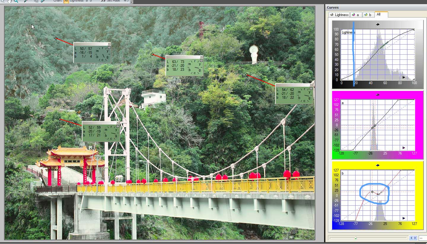

I tried this image although I am not satisfied with the correction. The fence appeared more yellow before the correction; how would I get the fence more yellow again? Also, the statue lost some detail; how would I bring out the detail in the statue? Overall, the foliage looks better. What do you think of this image?
Thank you
David
Week 6 - Example 5 - Temple Bridge
David,
You have two things going on here that are trouble...
1) the shadow end of the L curve is not being set. This will leave you with a false sense of the tonality of the overall image.
2) the inverted B channel area that I circled. This creates an area where the pixels are gray or worse inverted. They would be more yellow than blue when they are are on the blue side of the curve.
Lastly, remember that green leaves and grasses are closer to yellow than they are green. Let's try this again and keep the B channel out of the red curve guard area.

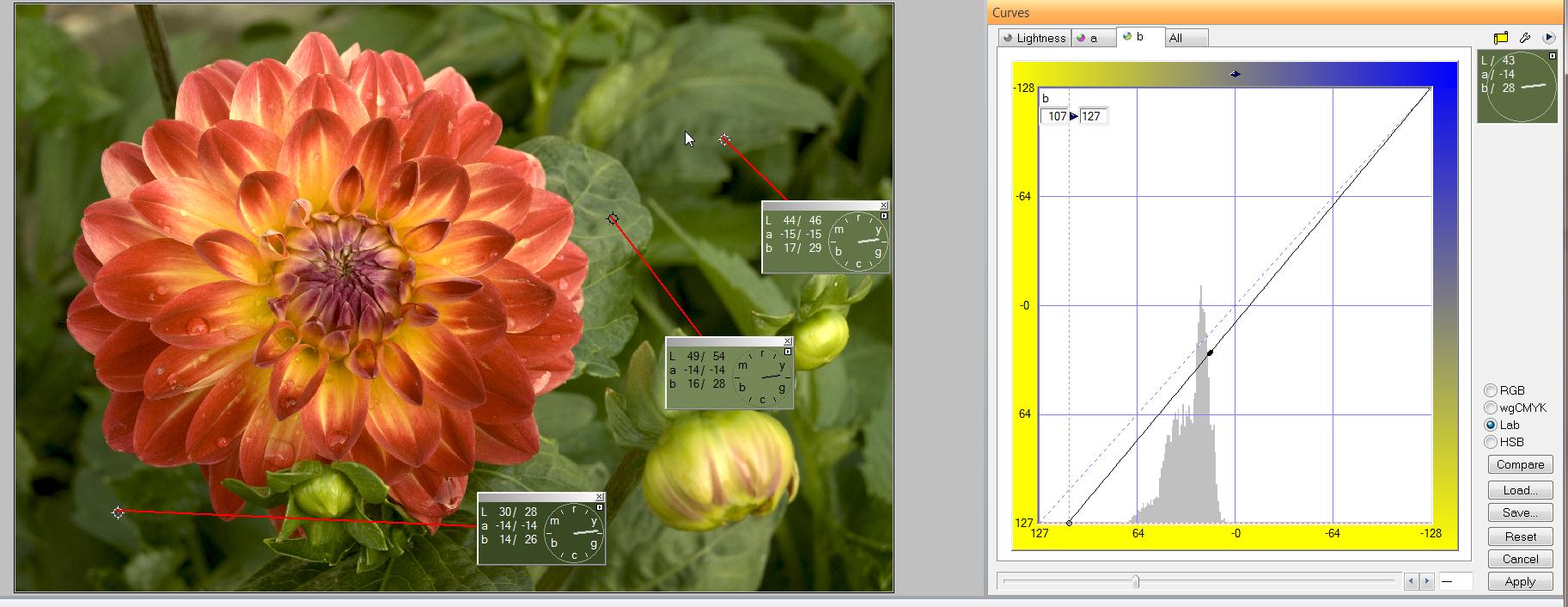

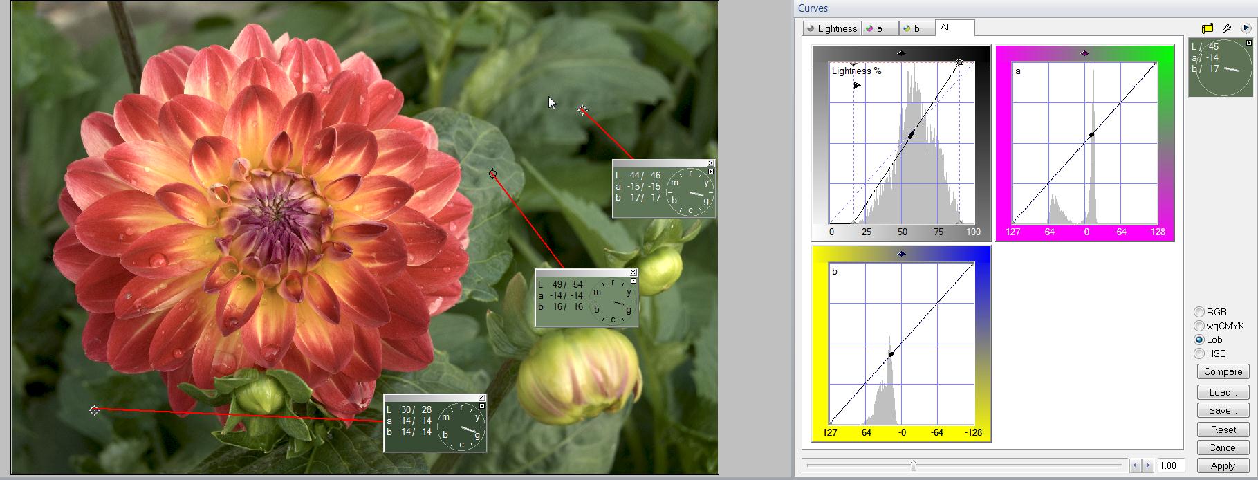

The green leaves being more yellow is measurable. Go looking for leaves you consider normal and measure them...in almost all cases you will find they are closer to the yellow mark than the green.
We live in a world where green leaves become amber and red in the fall, where grass that dies and dries out turns yellow....
Yet we always question why something looks better when the yellows and reds are increased. Ok..only up to a point...but please look at the two shots below.
I will tell you that these flowers were in my back yard and that during the time I was testing, both monitor and printing calibrations....the second version is much closer to the real plants in side by side comparison; I literally took the prints to the plants and compared...
Shot 1 is right out of the camera RAW converter with all color settings zeroed out.
Shot 2 is simply the adjustment shown to make the greens more yellow than Green...
Our perception of the color is a part of the problem.
The measured values show us one thing but our eyes show us another. There are many examples of this in the coarse..

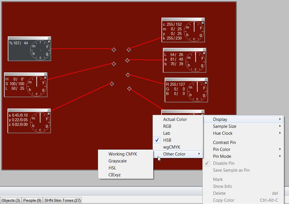

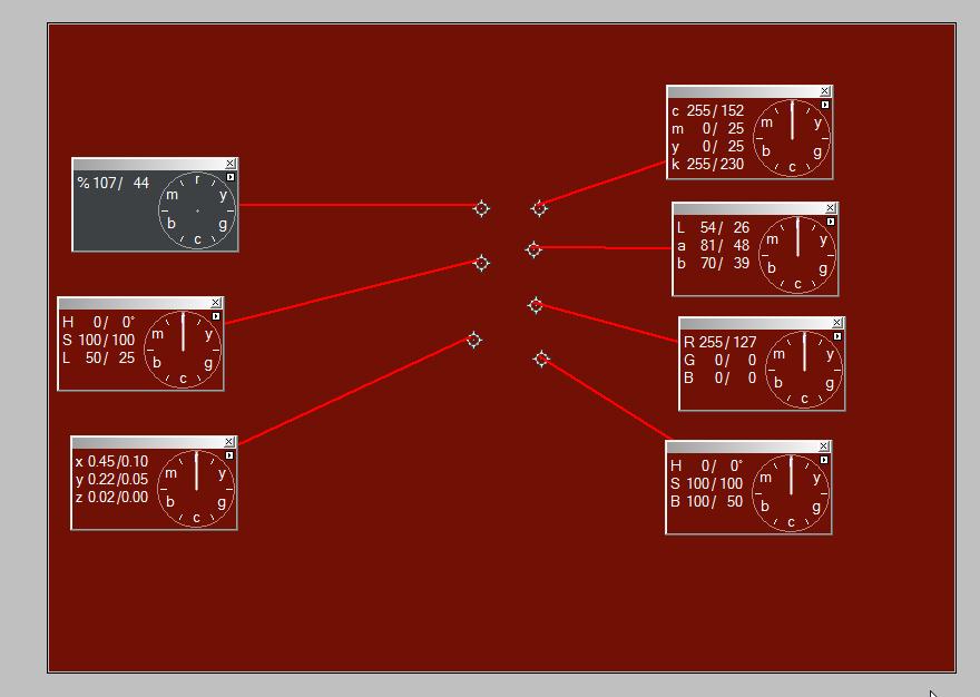

The hue clock is pointing to the Hue of the color you are moused over. In terms of HSB this would be the H value. It is measured in degrees from 0 to 360. Both of which are red BTW. This hue value is independent of the saturation or lightness of the color. The same hue in RGB would have 1 discrete value. It will be the ratio between the R and G and B values. So for instance Red having a hue of 0 would be 255,0,0 in RGB. If we add the Brightness and Sat from HSB to the equation then we can have a different value in RGB. So (Hue 0 brightness 50 Sat 100) would be 128, 0,0 in RGB. In LAB we would have about L 26, a48, b39 Both A and B being Positive makes the color warm...
You can do these yourself by opening a blank document in PS and filling it with pure red. Then use CM to place hue clocks on the image and change the hue clock displays to read the different color spaces. See shot 1. Click on the configuration button on the hue clock to get the fly out menu.
In shot2 you see all the different hue clock displays CM can provide for a color....
