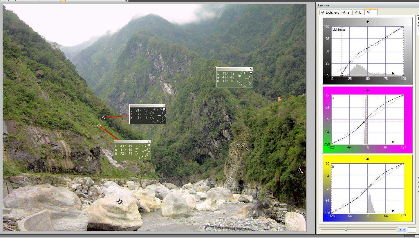

Hello.
I just noticed you posted a video on Expanding Color Variations in Lab. I decided to watch this video and then try adjusting the foliage again. I like this version better than the previous one. I decided to set a shadow and a neutral. I decided not to set a highlight because I was concerned that it would effect the rocks. What do you think of the try?
Thank you
David
Thank you
David
- 20110129_-example4-tarokagorge-lab2_screenshot1-jpg (178.62 KiB) Viewed 25362 times
Hi David,
It is better but there is more in there...
Bring the shadow end of the L channel curve in to deepen the shadows overall; and then go looking for more color. The color expansion techniques in the video will bring a lot more variation to the image overall and add a sense of depth...just do not go to far...
