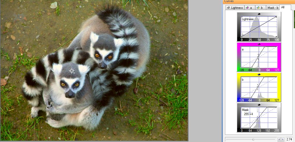

Postby mikemeister_admin » Thu Jan 20, 2011 9:54 pm
Two versions, one with a mask using channel b and another more saturated version without the mask. I prefer the version with the mask. However in neither attempt could I get the orange color that was in the lesson notes.

Postby ggroess » Fri Jan 21, 2011 8:46 pm
The only issue I have is the blue in the fur...
Before you make the mask and saturate...make sure you have a solid neutral.
The masked version has the eyes correct...

Postby mikemeister_admin » Wed Jan 26, 2011 10:01 pm
This time setting a neutral before using the b channel as a mask.
