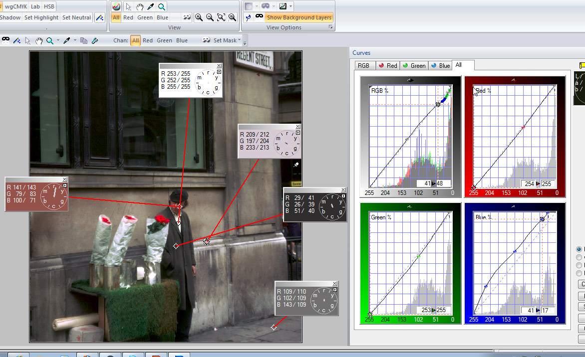

Postby sjordan93436 » Wed Jan 19, 2011 2:06 am
I tried it in cmyk.  I set the neutral on his hat.  That seemed to work.
57sj3-jpg
57sj3-jpg (999 Bytes) Viewed 7750 times
57ss3-jpg
57ss3-jpg (999 Bytes) Viewed 7750 times
Postby ggroess » Thu Jan 20, 2011 2:13 am
While you have some neutrals you also created some monsters with the magenta addition to the stone.
CMYK might not be the best space for this image...Remember to open the shadows a bit and enhance the yellows a bit...Keep it real looking though.

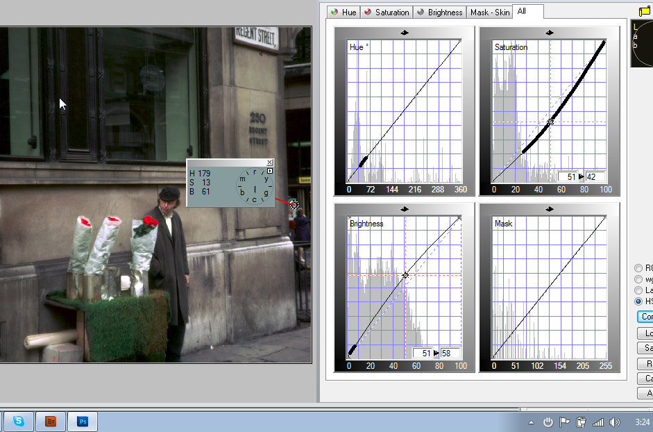

Postby sjordan93436 » Sat Jan 22, 2011 12:30 am
I cmyk the stone ..  the streak right behind the guy.
I went back to RGB.  I curved a little.  Then saved and went to HSB.  I masked the skin and reduced his saturation and increase the brightness of the vendor's face.
57sj-jpg
57sj-jpg (187.46 KiB) Viewed 7750 times
57ss-jpg
57ss-jpg (261.21 KiB) Viewed 7750 times
57sshsb-jpg
57sshsb-jpg (166.95 KiB) Viewed 7750 times
Postby ggroess » Mon Jan 24, 2011 3:23 am
Much better overall image...
It is good to see that you can combine color spaces and get results..
