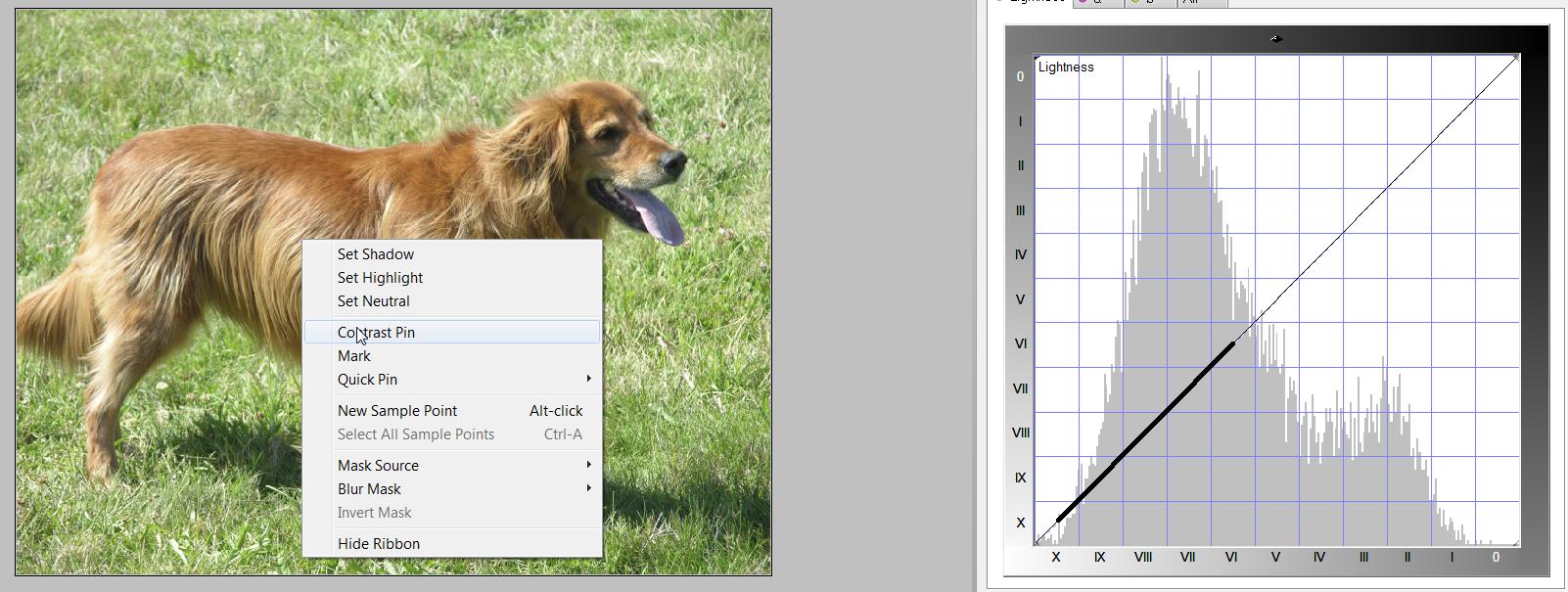

In Shot3 I am picking a part of the dog that gives me the longest "color worm" to work with. If I enhance the contrast across too little of a range the image tends to be harsh...I want to spread the correction out a bit. The trouble with RGB and contrast pins is the color cast you can introduce by changing any single channel.

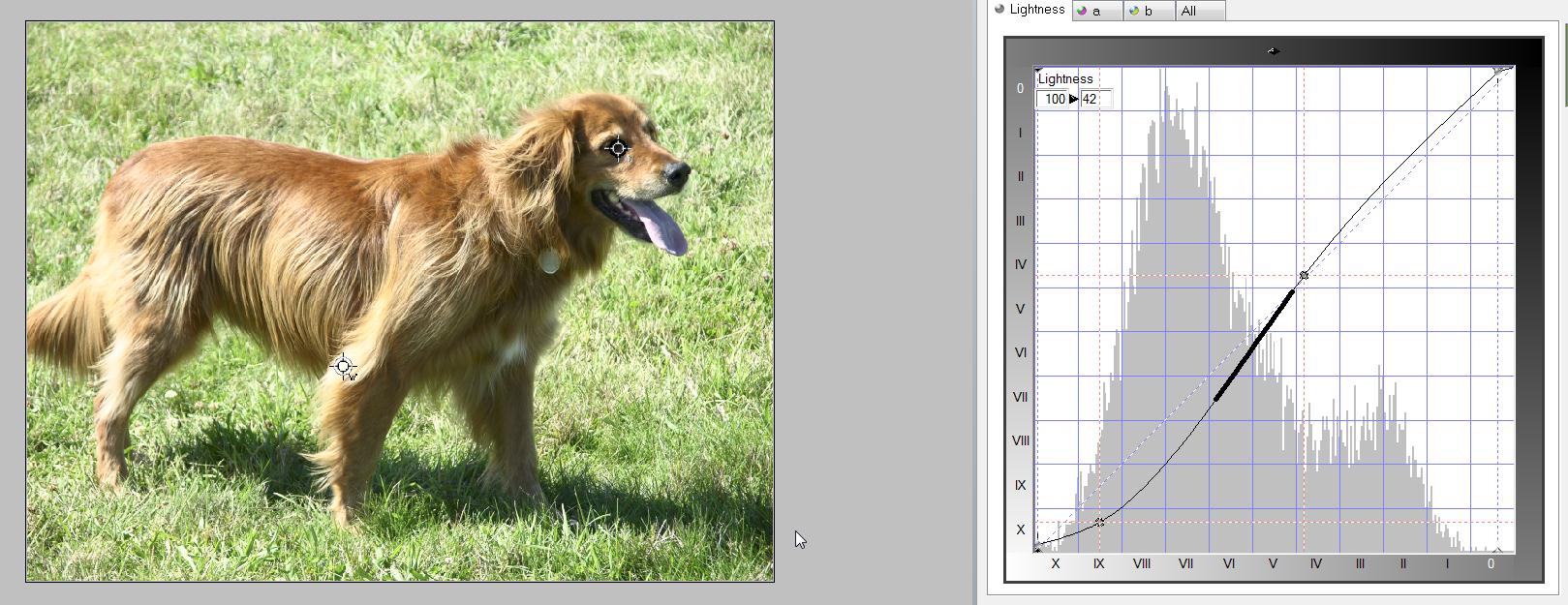

In Shot4 I have selected my range and made the contrast adjustment to make the dog look sharper...BUT only in the L channel. Adjusting the color channels just makes this harder to complete.

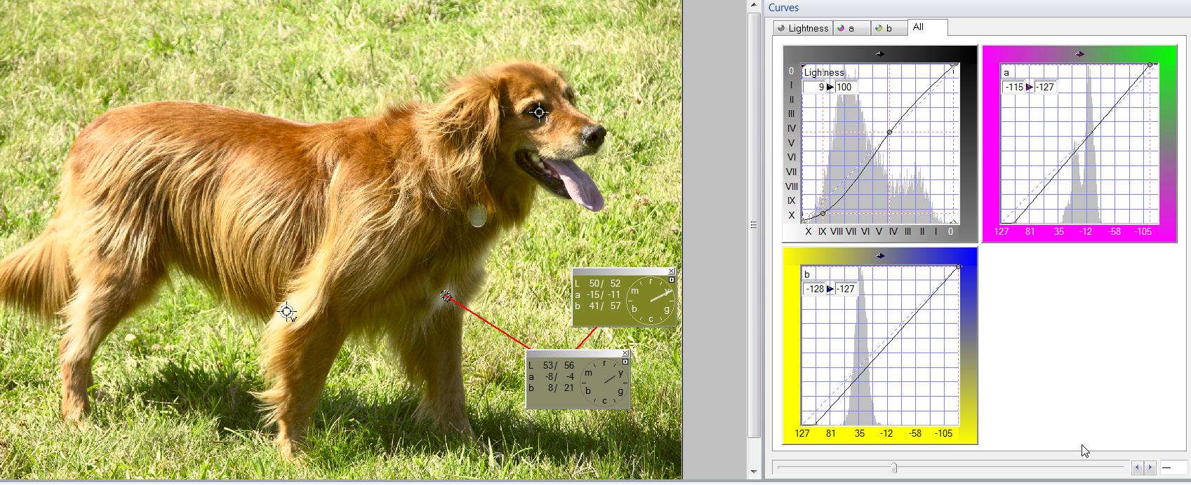

In shot5 I am making the image color look better with a few simple Adjustments to the A and B curves. The tip off is the lighter fur patch in the front of the dog.. It should be yelloow or white...not green.
- screenshot003-jpg-7 (164.19 KiB) Viewed 10365 times

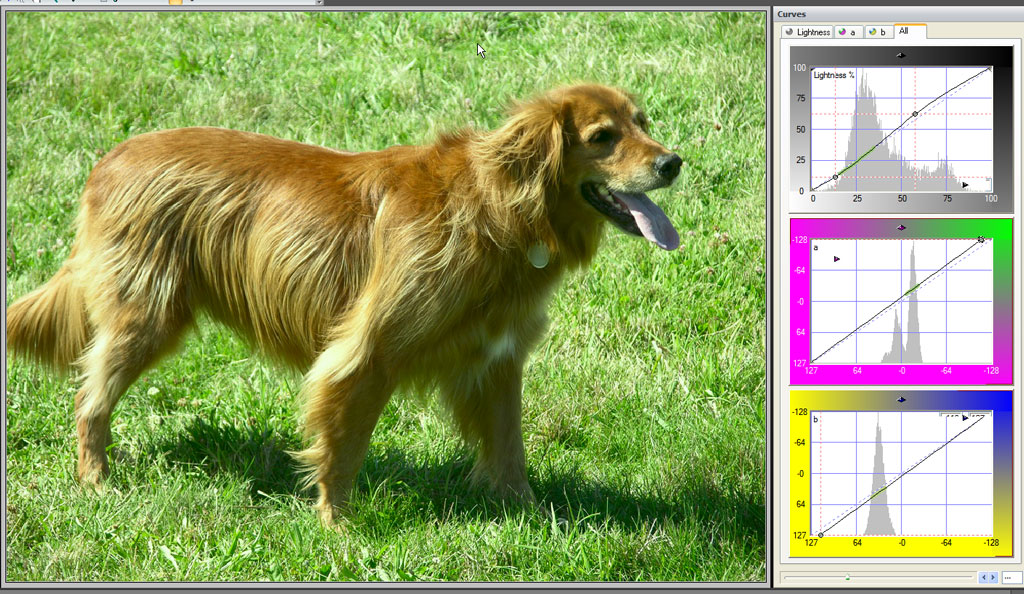

- screenshot004-jpg-5 (195.17 KiB) Viewed 10365 times
- screenshot005-jpg-4 (269.47 KiB) Viewed 10365 times

I decided do re-try the dog example. What do you think of this correction?

- 20110120_example1-lab2screenshot-jpg (235.95 KiB) Viewed 10365 times
The reason for the grass changing color is that I made all the tonal and contrast corrections first in LAB...
As you do that the image will lose saturation a bit as you change the brightness of the image. The first correction set the shadow and highlight.
The second adjusted the contrast....
By the time those two were done the saturation took a beating...In shot 3 I added the color back and tweaked it a bit to make the fur in the front of the dog look less green.
In your images the dog has a greenish cast and you really need to be aware of that when you work on hair...
