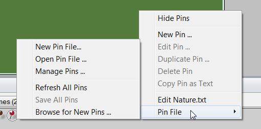

I have discovered that just adding a color pins text file to the Pins Library Directory does not make them show up in the Color Pins Palette. I found that you need to click in the Color Pins Palette and select Pin File and open pin file then select the Pin text file. I decided all the Pin text files should be in the Pin Library Folder and placed them their prior to adding them via the open pin file option.
So, again I can add a pins file to the Pins palette.

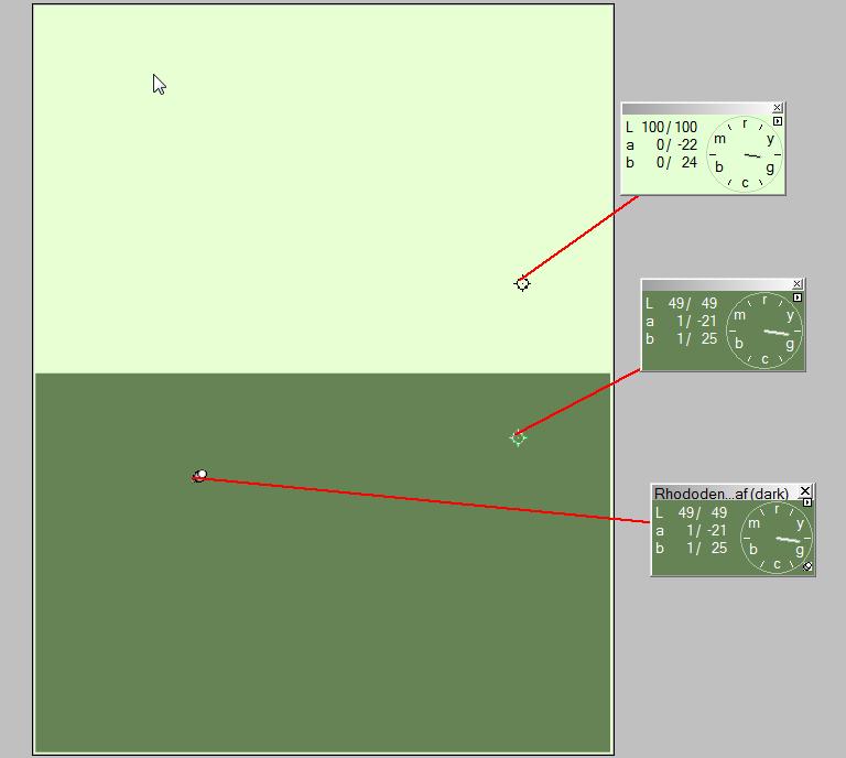

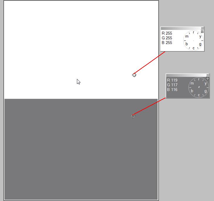

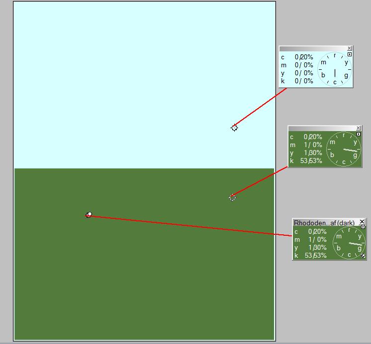

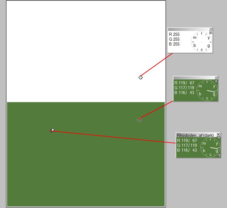

Here is what pins do...They adjust the color of the selected pixel(S) to match the values in the pin. Some Pins are HSB, some RGB, and some even LAB. Pins are very much like "set neutral" in that no matter what you have under the pin you get the output values for the pin in that spot. Attached shots...a white sheet when pinned will look like the pin. In the first shot the page is normal. In the second Shot I added a Pin. but I turned off the Brightness setting in the Pin. Notice that in RGB I only adjust the color in the same brightness range....in the third shot I switch to LAB Mode in CM...This is a great way to illustrate that in RGB color is tied to brightness...In the 4th shot I have the same pin in CMYK...Because the K channel is part of the CMYK puzzle the Cyan part of the pin is spread around the image....
Ok so here is a bit more...
In RGB if you make the adjustments for color first and then add a pin the there is really a very narrow range of brightness that is going to be effected...the other settings hold it in line...
In LAB you have to be a bit more careful...The color does cross all brightness boundaries...
Same for CMYK. BTW HSB is the same as RGB in how it handles pins.
You can Right Click on the Pins area and select pin file from the menu. The fly out has more options for you to select; and you can create your own files in your own groups.
You can write your own pin values into the text files if you open them from here and modify the existing pins...Your choice..the folders have moved a bit because of XP to Vista To Win 7 changes...If you have 64 bit OS it also can make a difference as to where the pins files are kept...
