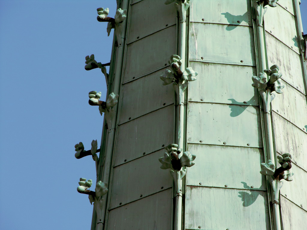

Postby sjordan93436 » Mon Jan 03, 2011 6:45 pm
This is my second version.  Not much difference.  Probably too sensitive.  I noticed some of the gargoyles went to B- 0.  They were green and more shadow than the panels.
BTW- tried it in CMYK.  Trying to kill a blue cast in CMYK is very difficult.
sj36a-jpg
sj36a-jpg (999 Bytes) Viewed 8085 times
ss36a-jpg
ss36a-jpg (999 Bytes) Viewed 8085 times
Postby ggroess » Tue Jan 04, 2011 5:00 am
Sometimes this simple image drives people nuts...
Try a restart...Keep the sky more in the blue/cyan range...too blue and it looks purple.
Tackle just the Steeple and see if the sky falls into place before you go after sky adjustments.
I'd try it in CMYK again...Remember that cyan is the opposite of Red and Green is the opposite of Magenta...and the yellow seems to be missing ...

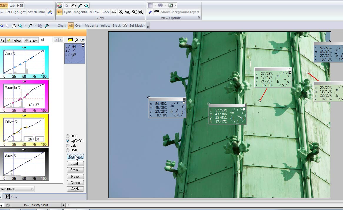

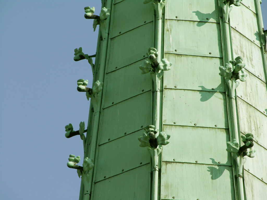

Postby sjordan93436 » Wed Jan 05, 2011 12:49 am
I hope this is better.
(I have been fooling around with cmyk.  This attempt at cmyk is tough because there are large areas of greenish roof and sky.  The C  and M values of the sky are very near the values of part of the roof.  The Y values are very near other parts of the roof.)

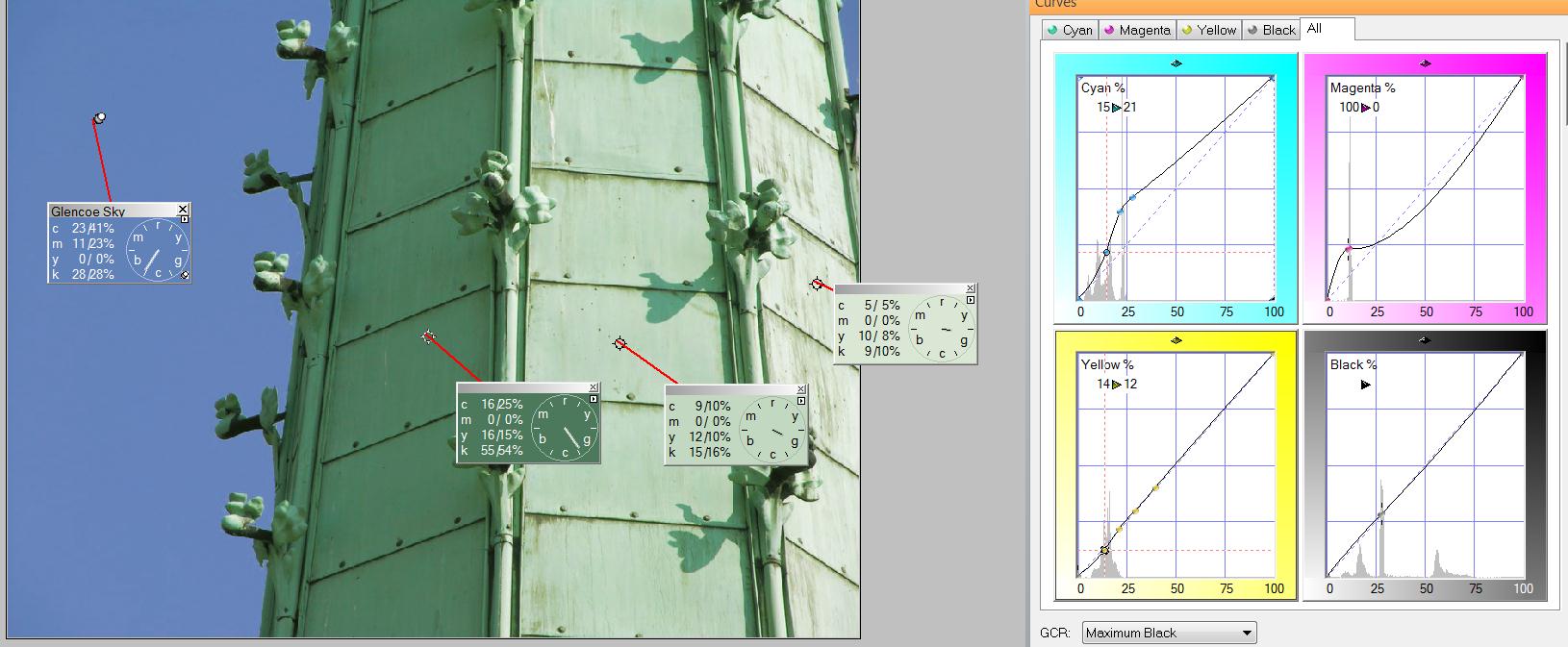

Postby ggroess » Wed Jan 05, 2011 4:34 am
Take your CMYK and add the Glenco Sky Pin...See Shot 1 then little tweaks to make the color better.  Really strong effort...
