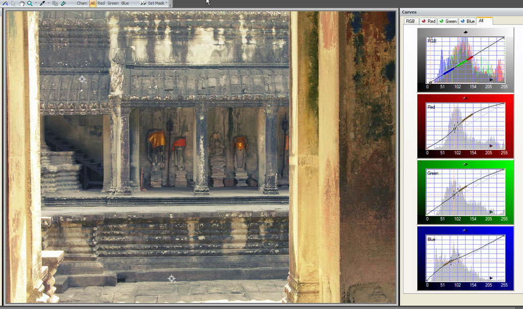

Hello.
Thank you for your understanding regarding my medical difficulties. For the time being, I plan on trying to keep up with the class. I am taking Prednisone which seems to be helping. I will keep you informed as my condition changes.
Back to you course, I decided to try Example 8 again, however, this time with two neutrals. The result was a little different. What do you think?
Thank you
David
Thank you
David
- 20101229_example8_twoneutrals_rgb2screensshot-jpg (192.32 KiB) Viewed 9954 times
I'm betting that you struggled with this one because the neutrals were too close together in tone. It is still too yellow....
Remember that a neutral can be any brightness. From White to Black so long as the RGB channels are equal. For this to work correctly you have to have more than 20 points between the neutrals. I would say 30 as a starting point...
