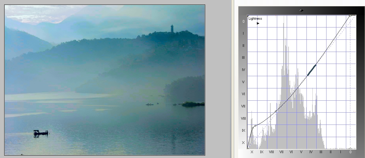

Postby sjordan93436 » Mon Dec 27, 2010 6:32 pm
I did something a little different here.  I put hue clocks on a couple of items, sky, red light, hills, water. (my screenshot does not show this).
I fixed the lightness.  Then I cranked up the lab colors before correcting.  I moved the pivot point with the cursor until I balanced the sky, water, etc.  Then backed down.
Final step, I tried (?) with lizard tail to get more detail from ridges.
I am not happy with some yellowing on the right.
sj6c-jpg
sj6c-jpg (999 Bytes) Viewed 6232 times
ss6-jpg
ss6-jpg (999 Bytes) Viewed 6232 times

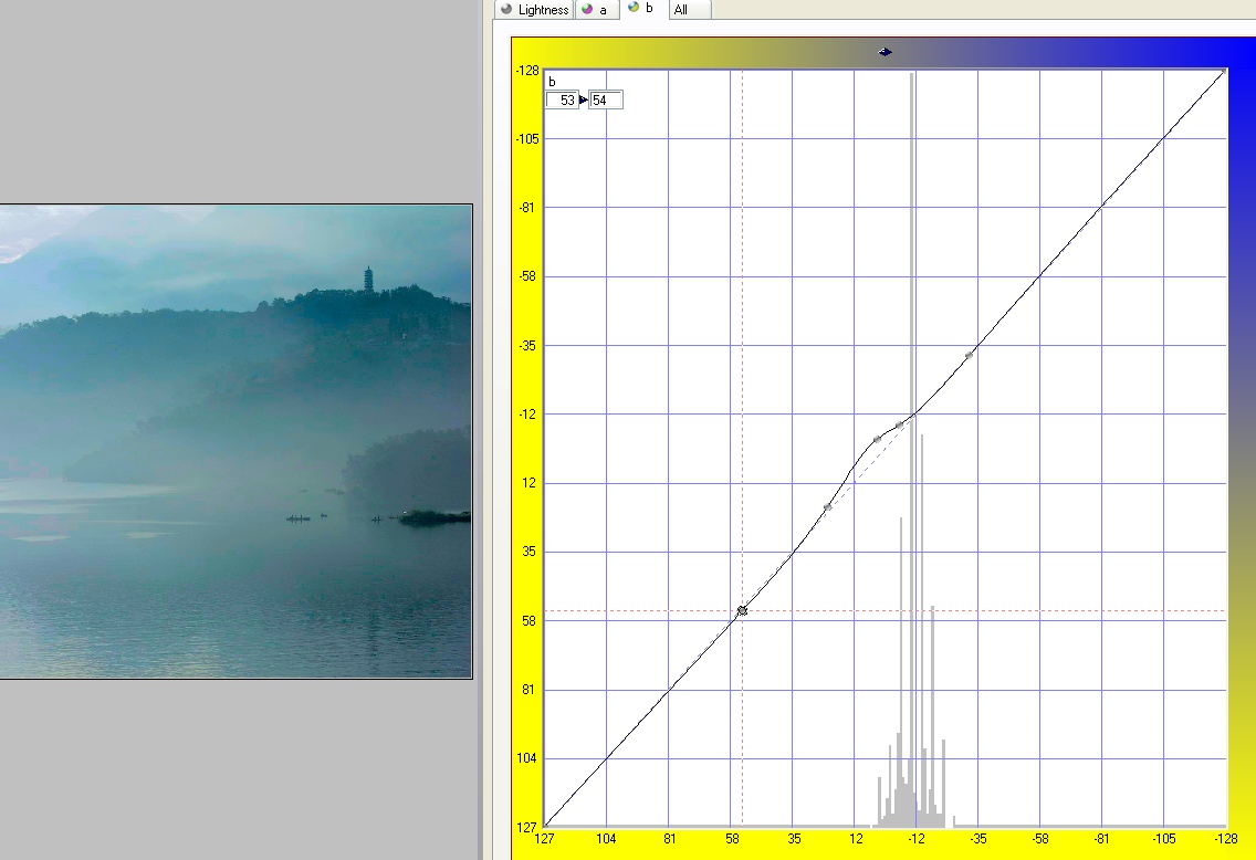

Postby ggroess » Tue Dec 28, 2010 8:55 pm
Steve,
2 things...
A Lizard tail on the L channel saved the highlights in the upper Left....Shot1
You can flatten the B channel a bit to kill off the yellow.  Use the color worm to help you find the area of the curve you need to adjust and use a contrast pin to get the range...Shot2
Over all well done...
shot1-jpg-15
shot1-jpg-15 (149.28 KiB) Viewed 6232 times
shot2-jpg-7
shot2-jpg-7 (157.47 KiB) Viewed 6232 times
