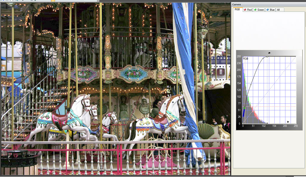

Hello.
I performed Example 1 in the RGB space. Moving the top white end inward greatly increased the photo. I was very surprised that moving the white end of the curve made such a huge improvement in the photo. I added two internal points and adjusted the curve to provide additional contrast.
Please give me your advice.

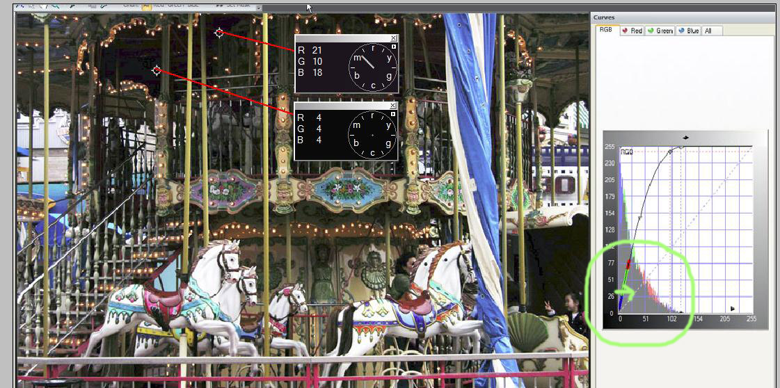

Try to open the deepest shadows just a bit more. In my screen shot I have a green arrow...try moving the curve at that point just a tiny bit..to the right. The deep shadows will open and you can control the tonality in the middle.

Hello.
I re-did this image basing it on the first try with a slight adjust to try to bring out the deepest shadows. I may have over did this adjustment non-the-less I am starting to gain an understanding of how adding additional points to a curve and adjust the curve will change the image.
Please give me your opinion on this second attempt.

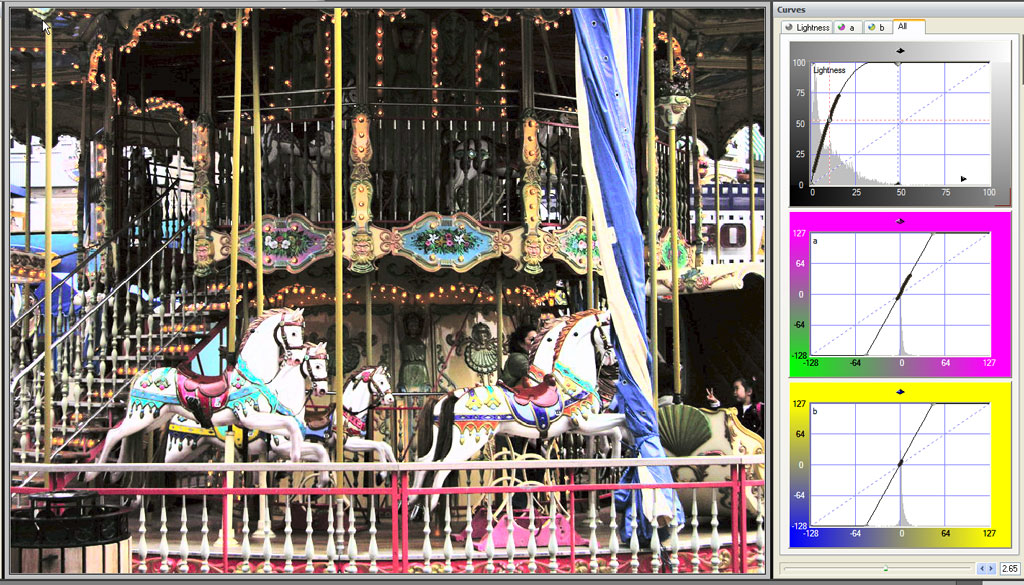

Hello.
Since you stated that this image would benefit from Lab because of its strong colors I decided to give Lab a try even though the exercise did not call for it. I feel making this effort and having your comments will have an educational benefit. Your comments are very informative and in my opinion a very important aspect of this class.
Please review image.

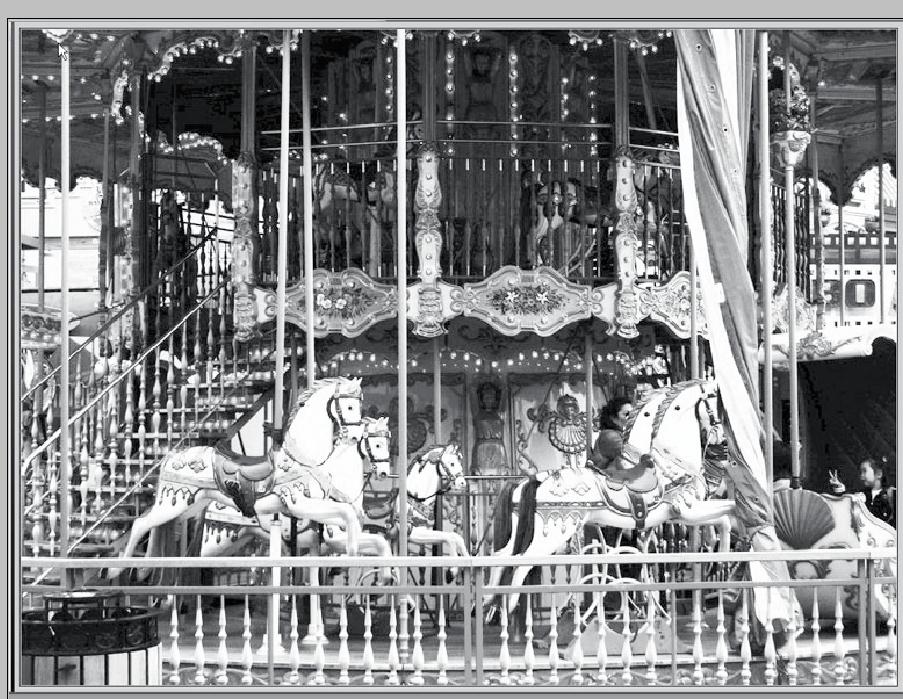

David,
Since I cannot really recover the LAB image I'll tell you what you need to do to make your own recovery....see shot1
If you look just at the L channel information; remember that L holds only brightness data no color....
Does this look like a good Black and White Image of the scene?? The highlights are in real trouble...
The color is going to look much better if the tonality is in place...
