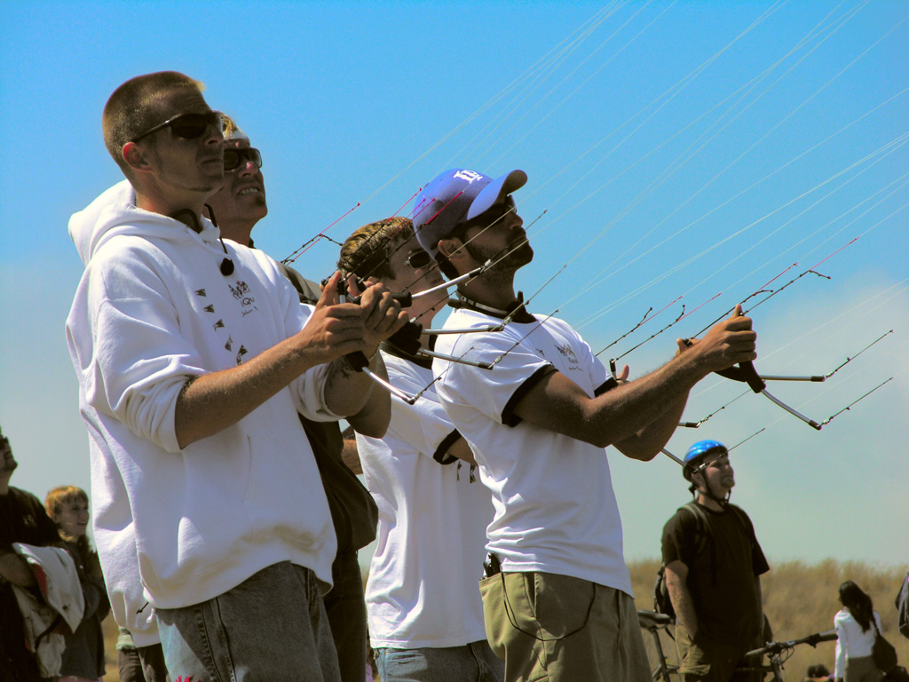

I thought I would give this image a try.
to kill all the blue in the shadows would kill the sky.  I could mask or paint or ??

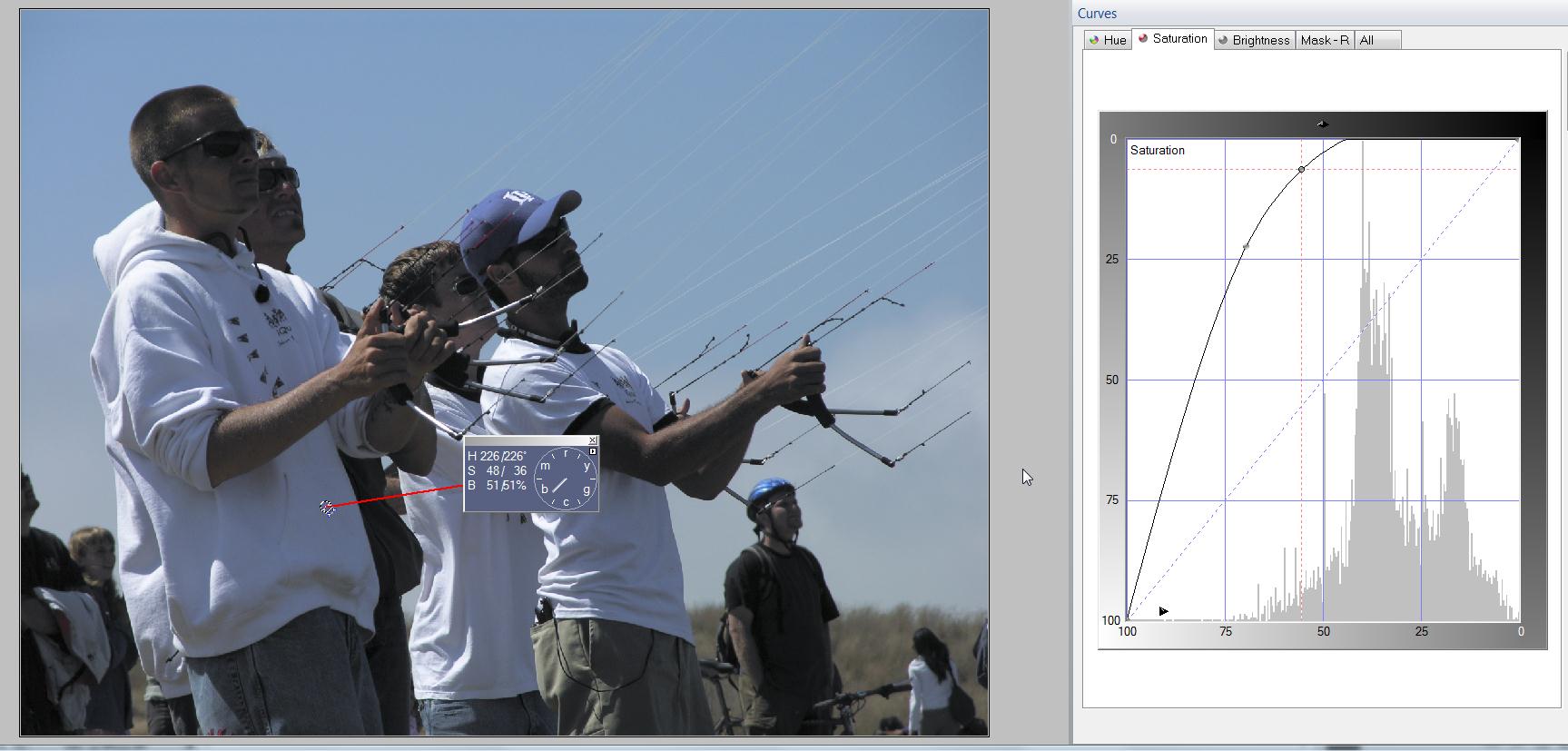

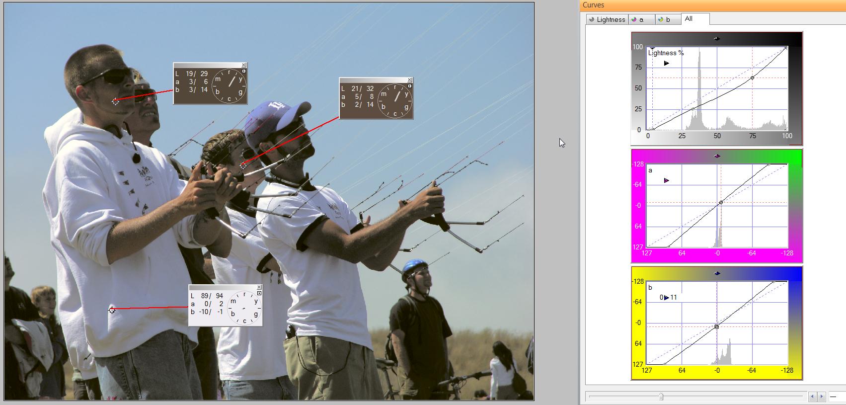

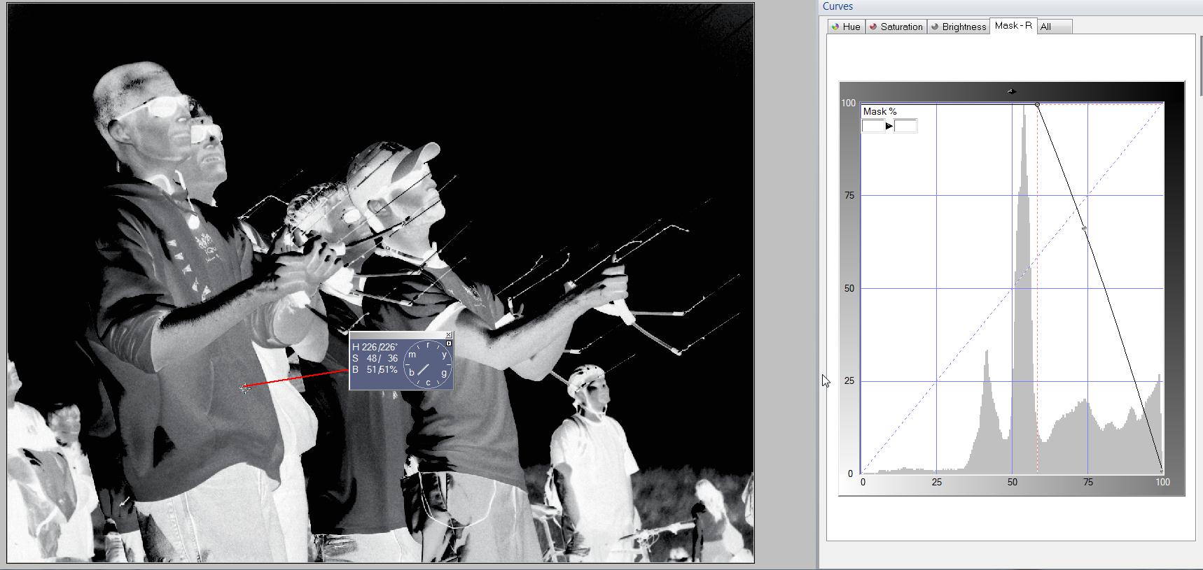

I would mask this myself...Use a red or blue mask and see if you can kill off some of the color in the shirts using HSB before trying to fix the rest.  Even half of it back is better.  Maybe do it as a color layer first and see if you can blend it a bit so that the exposure does not go all messed up...
Mask everything but the shirts.  The white parts can handle the de-saturation.  See if you can kill off half of the blue...
Screen shots for the masking and HSB attached...
Final mask was lightness channel of LAB and some painting to recover some over saturation areas.

screenshot007-jpg-6
screenshot007-jpg-6 (149.92 KiB) Viewed 7398 times
screenshot008-jpg-5
screenshot008-jpg-5 (138.57 KiB) Viewed 7398 times
screenshot009-jpg-4
screenshot009-jpg-4 (158.42 KiB) Viewed 7398 times

final image below...
I can do this image 100 times and get 100 different results.
2007-07-29_152422-iquadkiteflyersgg-jpg
2007-07-29_152422-iquadkiteflyersgg-jpg (266.8 KiB) Viewed 7398 times
Postby sjordan93436 » Fri Dec 17, 2010 5:23 am
It was a toughie.  I do remember.  I hope I did it better this time.  I did my best without masks or local adjustments.
As I keep doing these things, I get better.  I try not to use tools not available or not taught yet.  And no outside (non CM) applications.
