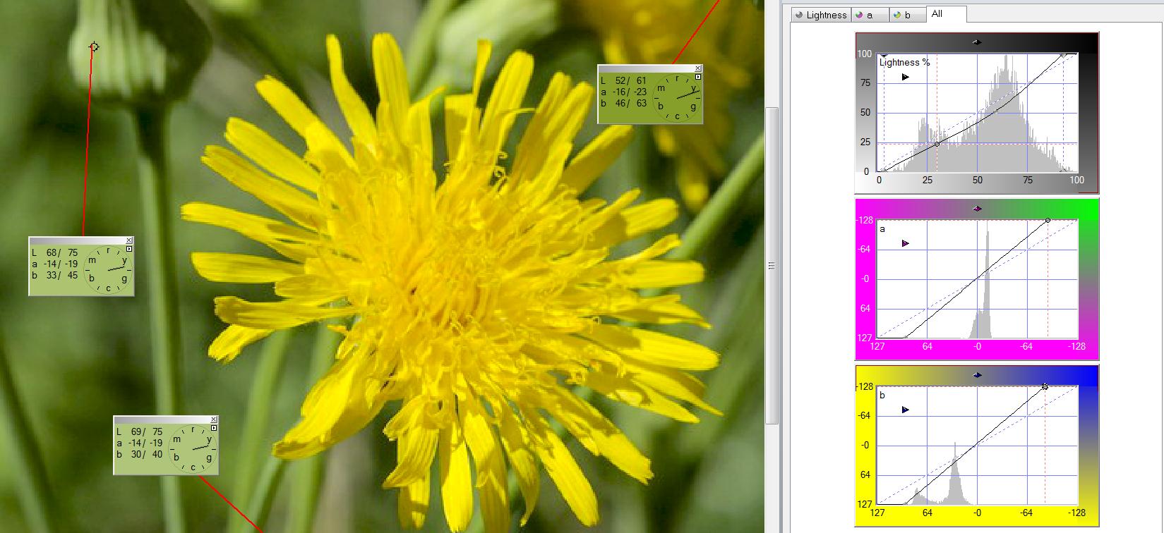

I'm not sure I would even tackle this one in HSB...I'll try taking an HSB swing at it next...But..in LAB it is a simple correction with a few things to note...
1) Shadow and highlight thresholds are the first step. You need only have a few pixels pop out in the highlight end. The shadows can take quite a bit more. In fact it adds drama to the image to deepen the shadows.
2) Over saturation in LAB will steal the highlight details. See screen shot. I kept the details in the petals...
- screenshot005-jpg-7 (155.81 KiB) Viewed 8824 times

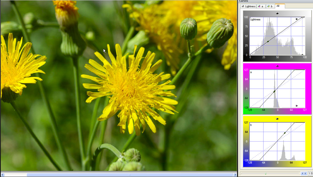

Hello.
The reason I tried Example 5 in HSB was because I thought that the Hints Video mention HSB with respect to example 5. I am taking another try at Example 5 using Lab. This time I used less saturation. What do you think?

- 20101218_exampe5_labscreenshot2-jpg (129.77 KiB) Viewed 8824 times

By the way you flower looks better...
