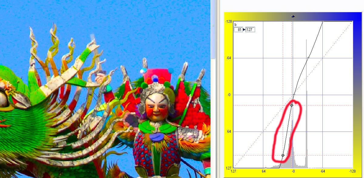

David,
You have 3 more colors you can adjust. Each side of the A and B channels is adjustable. The goal is to bring out the best in each color by stretching the curve a bit in the color ranges to separate the colors...
Think of it like leaves on a tree. At a great distance you cannot see the individual leaves. But up close the slight differences in color and lighting make each leaf stand out a bit from the rest...so...in the screen shot attached I have adjusted the Yellow side of the B channel for you. The area circled on the curve is the two points that were separated. I moved both points in this correction the top point I moved up and the bottom I move down. You can do the same on the Blue side of the curve if you like but the straight curve seems to be sufficient for this correction...
Compare the yellows in my screen shot with the same area of your posted image. The difference is worth going after...
The trap is losing detail in the image...Zoom in and make sure you only adjust until the color starts to overwhelm the detail then back off...
Do the same for the A channel...
