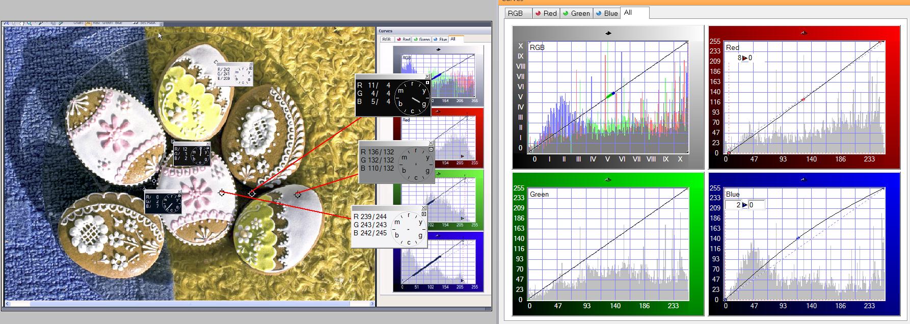

Hello.
I played with the hue clock options and setup several hue clocks in the screen capture.  I applied a small correction in RGB.  I do not believe I over corrected but would like your opinion.
Thank you
David

Postby ggroess » Fri Jan 14, 2011 4:18 am
David,
I always look for things that my eye tells me are supposed to be neutral.  In my screen shot you will see the S/H/N By the numbers correction for this image...
I think you got it very close but the blue adjustment went a touch too far...the Icing in the foreground started to turn yellow and needs a bit of help...
