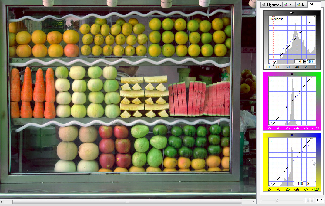

Postby sjordan93436 » Thu Jan 13, 2011 1:46 am
Is this better?
33cmyk-fixed-jpg
33cmyk-fixed-jpg (290.27 KiB) Viewed 9268 times
Postby sjordan93436 » Thu Jan 13, 2011 1:50 am
When I use wg cmyk, the white point works fine.  It moves the top of the cmy points down.
Setting a black point in cmyk is problematical.  How much K?  etc etc.  You can move the master curve, but I feel it is better in LAB or RGB.
Postby ggroess » Thu Jan 13, 2011 2:37 am
That is because the K channel relates to Ink on Paper not brightness on the monitor.  the true blacks hit the wall faster because you have CMY added to the K channel to make up the Blacks.  In Lab you are dealing with actual L values and not a calculated value for ink on paper...
The GCR setting has the greatest effect on the K channel; try different GCR settings to see if you can find the right one for adjusting the Blacks more smoothly.
