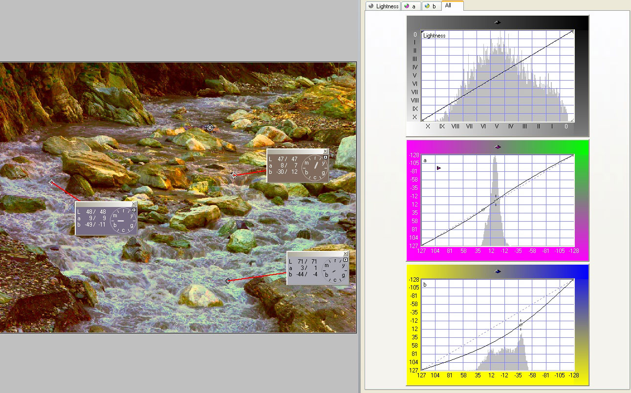

Postby ggroess » Tue Dec 28, 2010 8:59 pm
Steve,
If you find another neutral...the color stays but the blue cast goes....

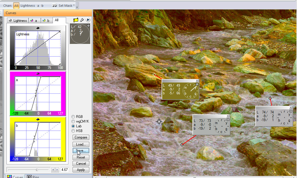

Postby sjordan93436 » Wed Dec 29, 2010 12:36 am
Once again I was looking with heart no objective.  All my foam was blue.

Postby ggroess » Wed Dec 29, 2010 3:50 am
ok...but too far with the saturation....Come back half way and see if it is still colorful...
Watch out for loss of detail due to over saturation...it is easy to do in LAB...
