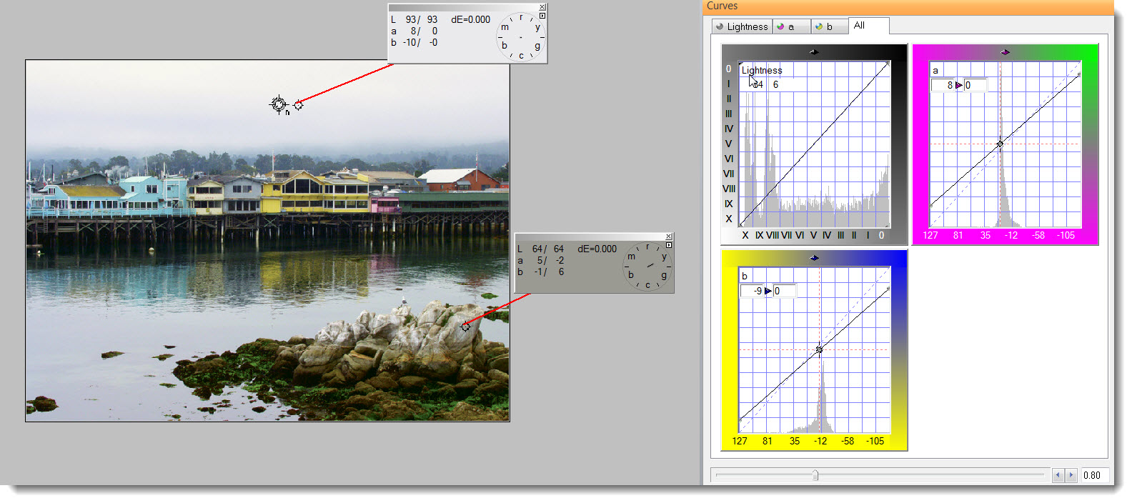

Lowell,
Again the neutral is key...Magenta clouds in this setting do not make sense...first screen shot.

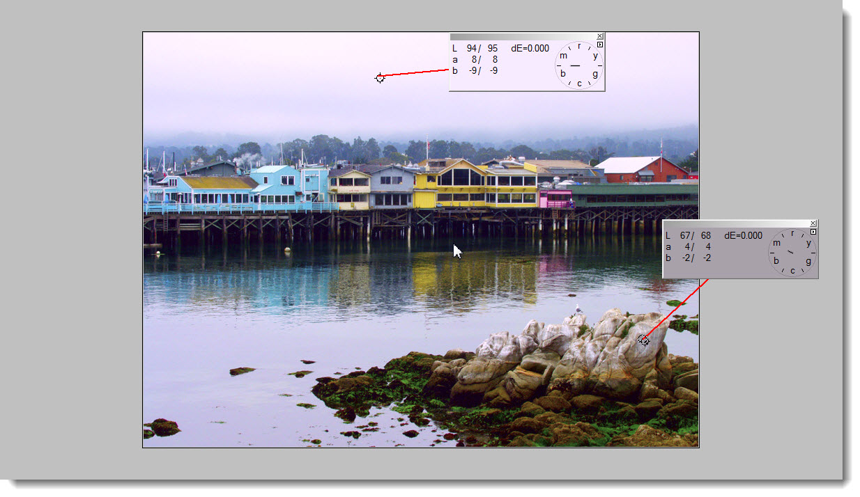

In the second shot I have set a neutral and desaturated the image a bit...the greens are too vivid and that is the trap in general...
Notice how the rock also looks less Magenta when you get the sky right...
Use those hue clocks...they can tell you a bunch...
