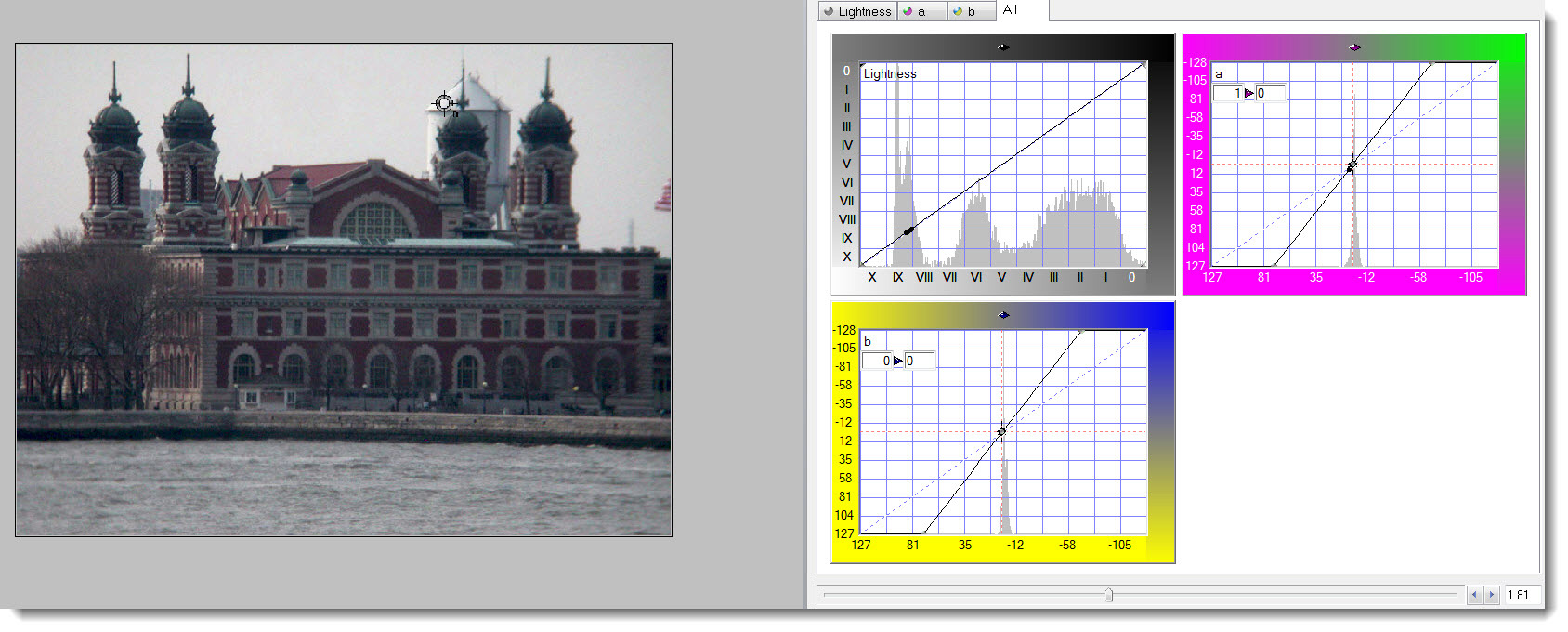

Here is my next submission. Once again, comments appreciated.
Lowell
Example 4
Lowell,
A couple of small things...
This one is a bit Magenta...I know...I know...the light tones are your weakness...
Note in the screen shot where I have placed a neutral. The water tower is either silver of white...both make effective neutrals...you can bump the saturation up to the value shown in the screen shot...
How does it look to you? We can talk about this one more if you want...Let me know if you did this in RGB as well...
- greg01-jpg-18 (285.62 KiB) Viewed 5509 times
