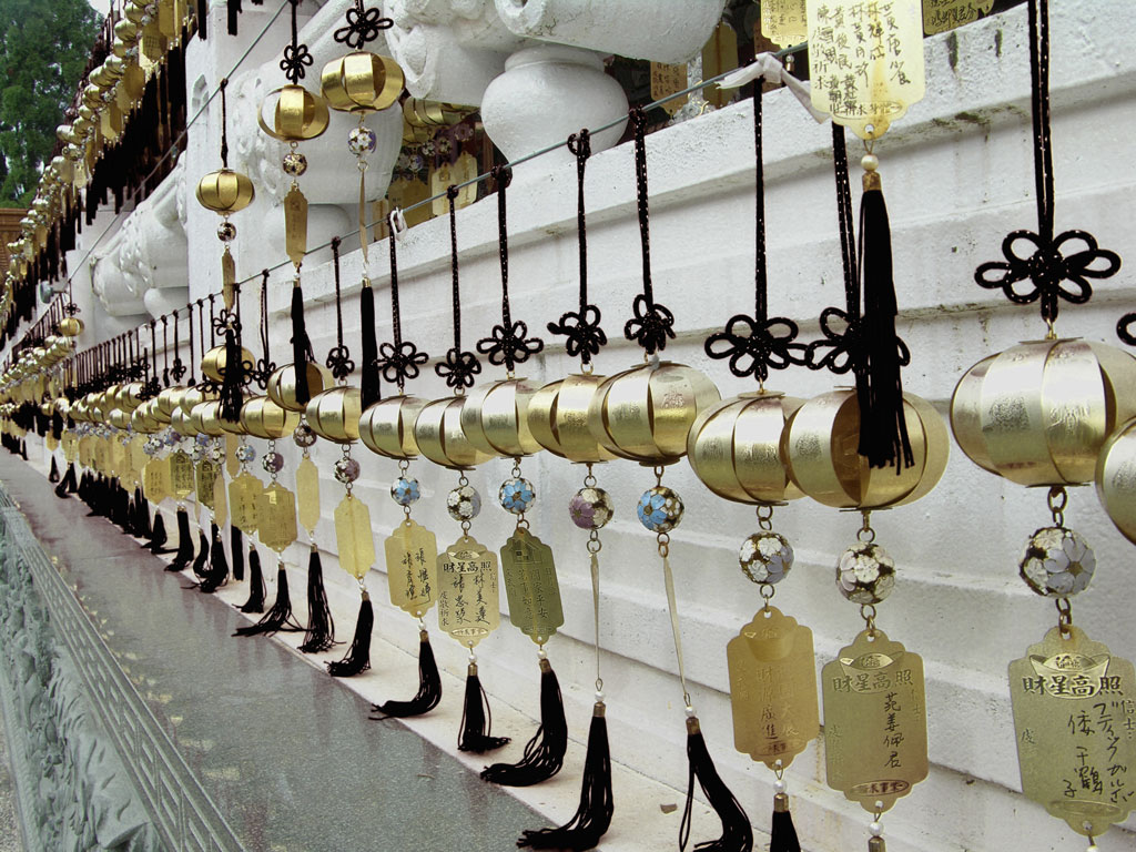

did the exercise.
I could not get rid of the red shadows on the counter. Gave up in the end.
decided to boost the colour a bit
Went back in to rgb and corrected by the number - no screen shot
Then went into lab for colour boost.
I tried to protect the neutral I had set by placing another neutral in the same spot in lab.
Dont know if this is the way to do it or not
Then I pinned the place where the red was reflected on the counter
Then boosted
Final was sharpened a little as well.
Its nearly spring and it was a sunny day here :)

Postby ggroess » Tue Aug 14, 2012 11:28 am
The red tinge is due to the hardness of the mask...remember we need to let some of the edges be soft to blend the adjustment across those transitions.
Postby imported_julie » Wed Aug 15, 2012 3:07 am
Hi Greg
ok, I had another go.
all I have done is use a mask.
I made is less steep and It seems to have reduced the red
Good enough or try more?
tasselstake-2-copy-jpg
tasselstake-2-copy-jpg (233.06 KiB) Viewed 33895 times
Postby ggroess » Wed Aug 15, 2012 11:13 am
I think it's reasonable...
good job...
