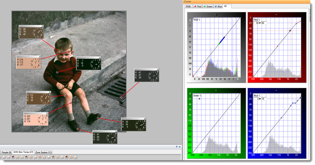

this took a while
first I put in a shadow and neutral.
I then tried to place the neutral so the grey would be on the warmer side but not mess the skin tones
This was just a preference. Warm looked better than cool to me
Some of the skin tones looked a bit 'off' but the hue clocks said ok and even the red cheeks were acceptable.
But... These corrections made the collar and the paper on the road really yellow.
I added a mask and tried to correct this
I think the shirt may really be a very pale green
So this was the best I could do
sharpened a little bit
I remember this from last time, I think it was easier this time round.

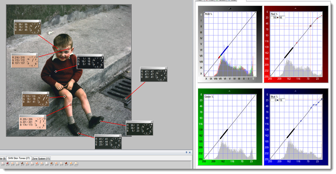

Postby ggroess » Fri Aug 10, 2012 2:28 pm
Solid work...now for the picky parts...
Your shadows are too yellow and while this helps the skin tones if makes the shoes look green...
Shot 1 is your image as posted.  Shot 2 is my adjustments to the shadows in RGB that do not affect the skin tones.
I have attached an ACV file for you to load .  Choose RGB in CM before loading it...
