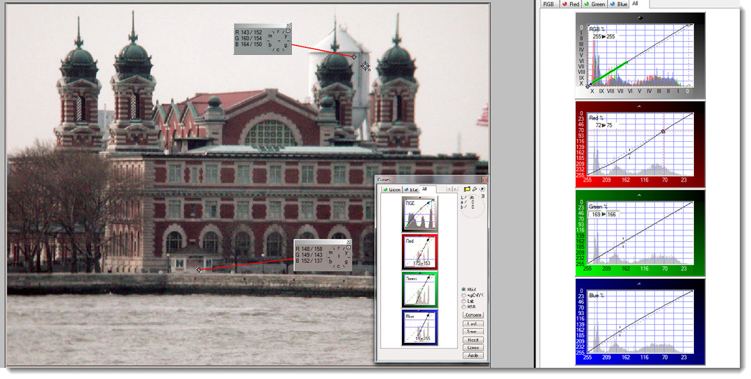

It's a touch blue...See my screen shot attached. I'm not sure where your neutral was set but some things to consider...Black, White and shades of "Known" grey are all good candidates for a neutral. remember to not pick a neutral based on its looks but rather what it should look like.
In my shot a set a neutral on the water tower because the white paint in the shadow "should look" neutral. Also note that I bumped the shadows end of the red curve a bit because the darker areas looked blue even still to me...It is kind of subjective but I hope you see an improvement in the image. Also note the patina on the copper domes looking a big more green...
