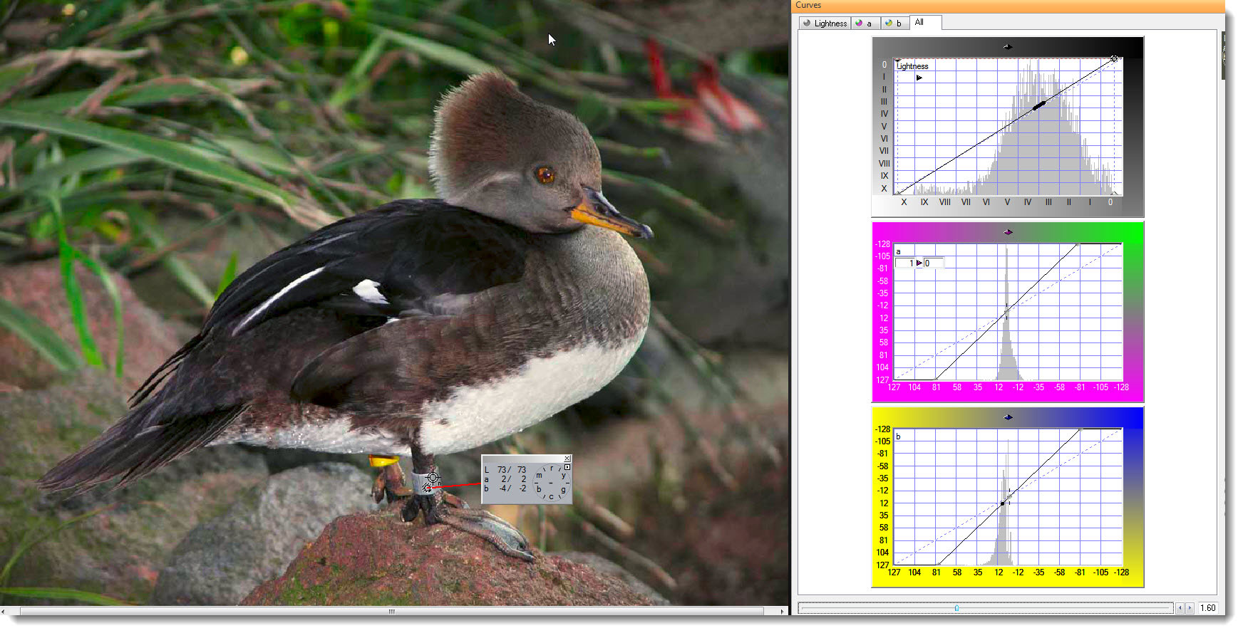

Postby ggroess » Wed Jul 18, 2012 1:48 am
2 things happening here...
1) these appear pretty bright overall.  The wizard makes it harder to control but try it out of the wizard.  Set your thresholds and get the tonality under control first.  The color will solve itself with a good neutral choice.
2) the neutral...I used Duck2 RGB for the attached image.  I thresholded the image I also added saturation... you were very close on the color...It's in there ...go get it...
greg04-jpg-4
greg04-jpg-4 (295.7 KiB) Viewed 7614 times
