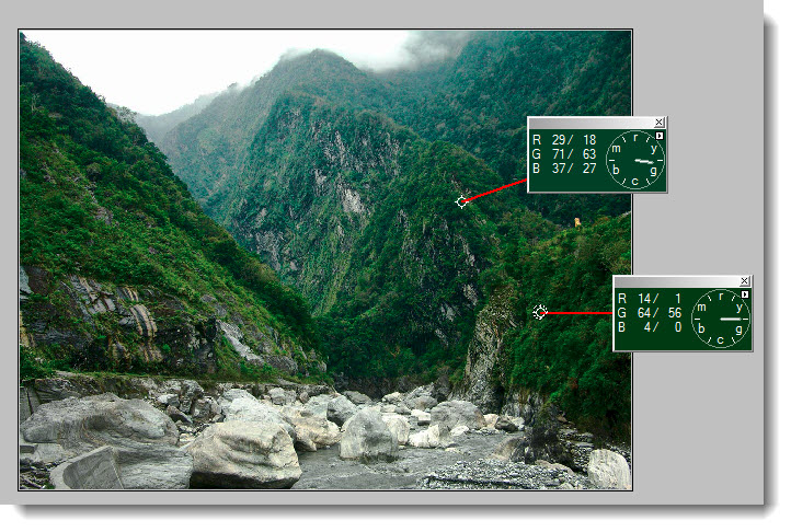

Postby ggroess » Fri May 10, 2013 12:49 am
Tanja,
The reason I say it is not yellow enough is that most green leaves and grass are more yellow than green.  the hue clocks tell the tale here...
greg06-jpg
greg06-jpg (151.36 KiB) Viewed 29486 times
Posts: 294
Postby imported_Tanja » Tue May 14, 2013 12:26 am
hmm, yes this looks maybe too cold.
Don't have the time right now to fix it, but one question:
Where can I find good examples for "how color has to be", like for example in plants?
Is the green of trees always more yellow than green even on a foggy day?
Postby ggroess » Tue May 14, 2013 4:01 pm
Unfortunately, no...
In this regard plants are like skin tones in that they can be many things as long as they are in the right "zone"  for skin we talked about the 12:30 to 1:30 zone on the hue clock for plants It would be like 2:00 to 2:30.  You get to 3:00 and you are too green.
If that makes sense.
