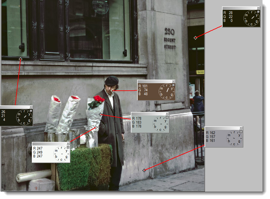

Postby ggroess » Sat May 04, 2013 3:22 pm
I think you troubles are in the shadow areas Art.
you are close but I think the image will look better when you get the shadows in place.
greg05-jpg-2
greg05-jpg-2 (129.88 KiB) Viewed 8038 times

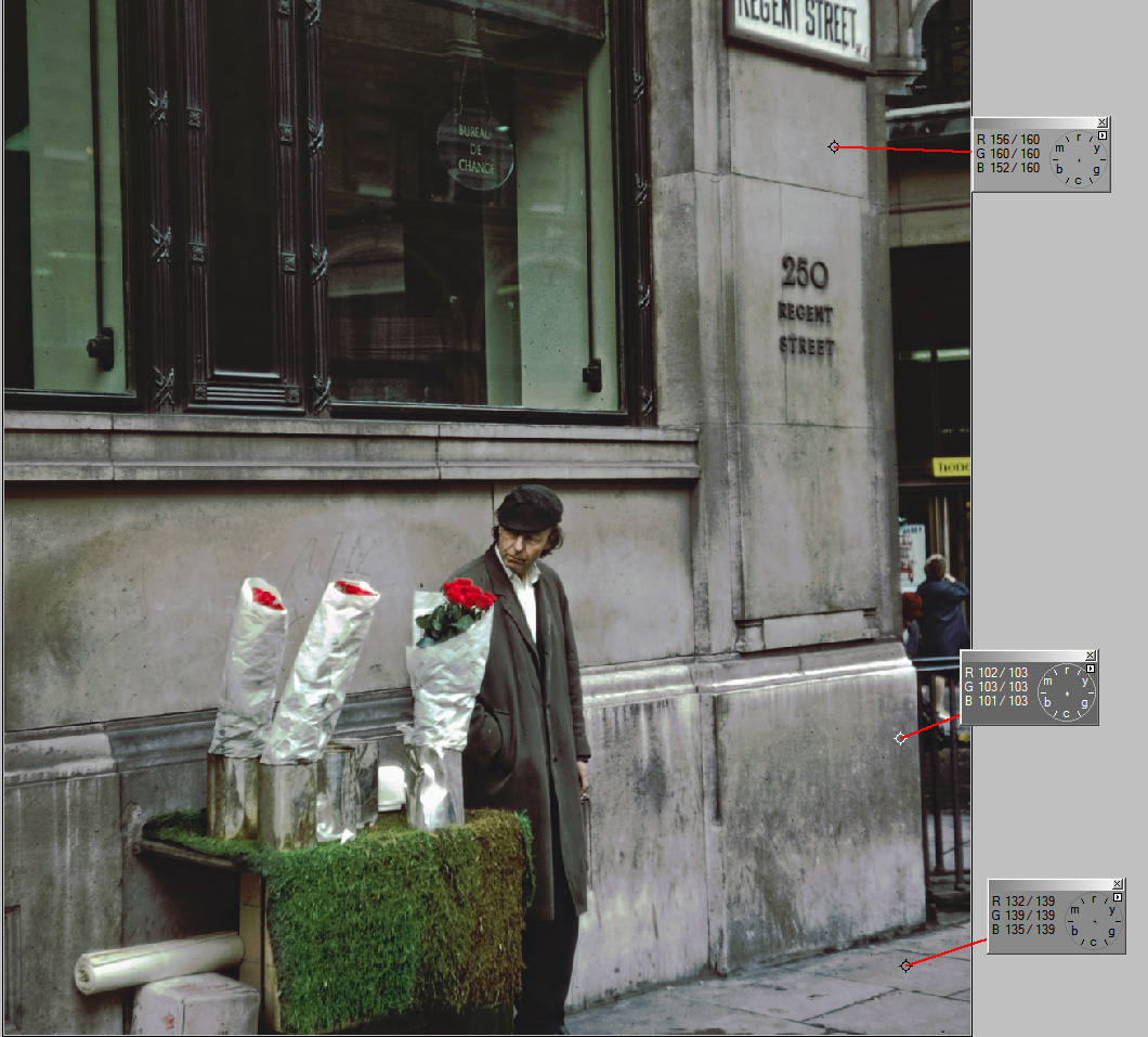

flower-vendor5-jpg
flower-vendor5-jpg (313.92 KiB) Viewed 8038 times
Postby ggroess » Sat May 04, 2013 6:18 pm
Don't count on the walls for a neutral you might find one but it will be hit or miss.  Look for other things that can be neutral in the image and in the mid tone areas.  You are actually pretty close there but I see your point about the stones.
Also try to open the shadows a bit in the window and the background...there is detail you want to recover.
