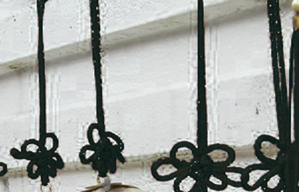

Postby imported_Tanja » Tue Apr 30, 2013 11:51 pm
Have this now (attachment 1).
Better details, but now I have problems with the funny lines (attachment 2).
What is this? Jpg-artefact?

Postby ggroess » Wed May 01, 2013 1:14 am
looks like it...screen shot the mask for me...

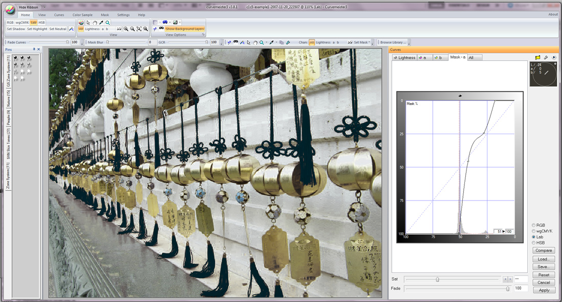

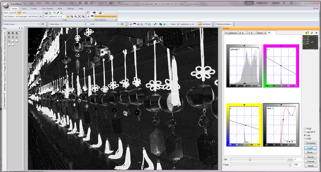

Posts: 294
Postby imported_Tanja » Wed May 01, 2013 1:58 am
had the mask only in cm.
Saved the file, but mask is not saving. Good to know.
It was something like the attached one.
Problem is in the mask. Hm...Why? Too funny curve?

Postby ggroess » Wed May 01, 2013 11:21 am
exactly...the curve is too extreme.  See if you can do the same effect without the Red curve...

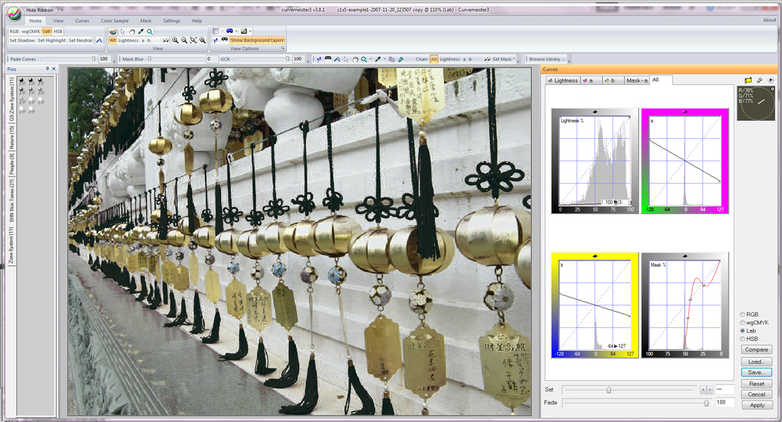

Posts: 294
Postby imported_Tanja » Wed May 01, 2013 12:48 pm
Oh, okay. Curve goes red, when too extreme. Didn't notice that.
Here is another curve, which is not that extreme, but same effect.
