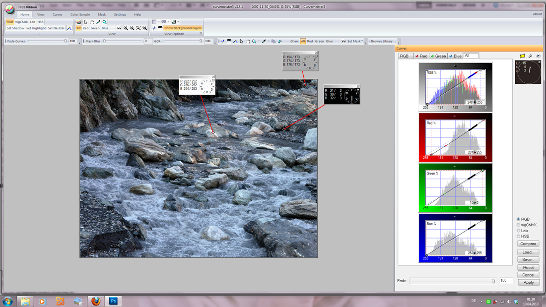

Postby imported_Tanja » Thu Apr 11, 2013 10:35 pm
Oups, only 42% quality by saving for web.
Don't look that colorful, that the file could be so big...
2007-11-30_084931-jpg
2007-11-30_084931-jpg (999 Bytes) Viewed 14343 times

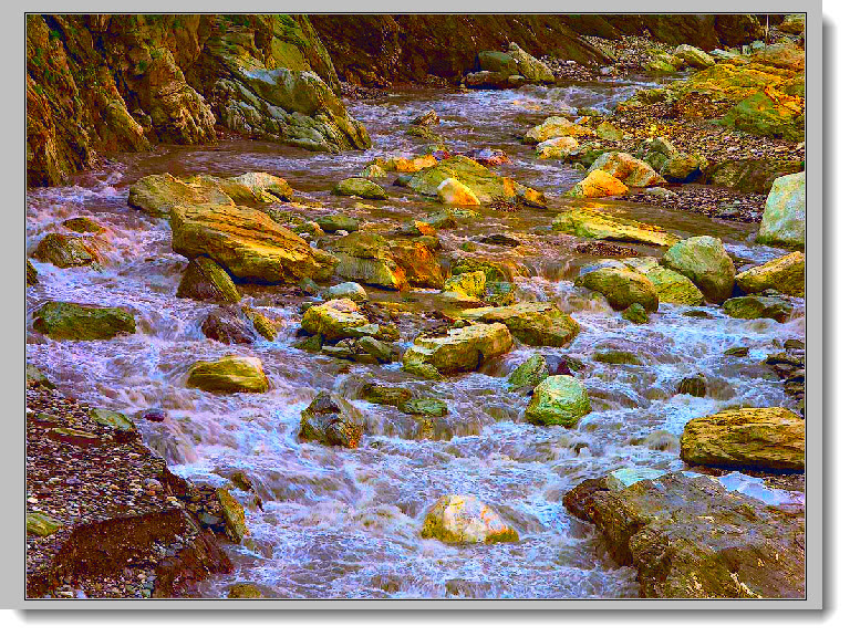

Postby ggroess » Fri Apr 12, 2013 1:43 am
Tanja,
When I test these I use the saturation slider in LAB to help me figure out a color cast.
Shot 1 is your original image supersaturated.
Shot 2 is your image supersaturated with a different neutral choice.
shot1-jpg-3
shot1-jpg-3 (305.85 KiB) Viewed 14343 times
shot2-jpg-2
shot2-jpg-2 (314.74 KiB) Viewed 14343 times

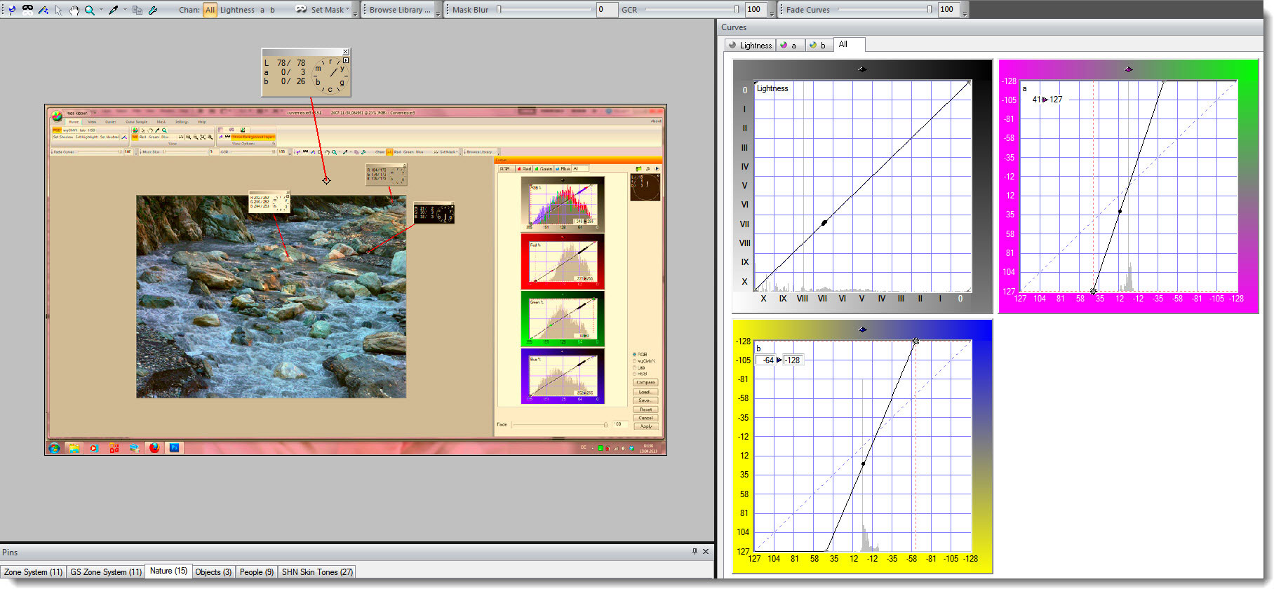

Postby imported_Tanja » Fri Apr 12, 2013 11:28 am
Oups...  ;D
Posts: 294
Postby imported_Tanja » Sat Apr 13, 2013 8:45 pm
Hm, did I have the right points? Still looks so blue.
Was there another step to color correction? I don't remember...
Good to have the video tomorrow  ;)
Greeting, Tanja
untitled-1-jpg-7
untitled-1-jpg-7 (304.64 KiB) Viewed 14343 times

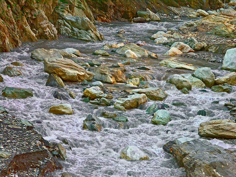

Postby ggroess » Sun Apr 14, 2013 3:53 pm
Tanja,
Indeed it is too blue...
I think you choose a part of the pipe that was too blue.  The sample itself should be 3X3 pixels and you need to make sure you find a good spot for the neutral after shopping it around a bit.
I have attached my curve files for the image you have posted to the web...They fix that version.
I adjusted the a and b channels in lab just a bit to reduce the blue in the overall image.
greg08-jpg
greg08-jpg (310.76 KiB) Viewed 14343 times
untitled-1-lab-acv
(44 Bytes) Downloaded 687 times

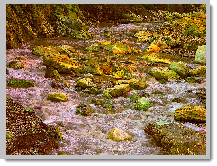

Posts: 294
Postby imported_Tanja » Mon Apr 15, 2013 10:58 pm
Unbelievable! I don't find that correct neutral point.
Try now to correct with a and b channel by view.
Still don't look like I want to, but hopefully better.
2007-11-30_084931c-jpg
2007-11-30_084931c-jpg (313.58 KiB) Viewed 14343 times

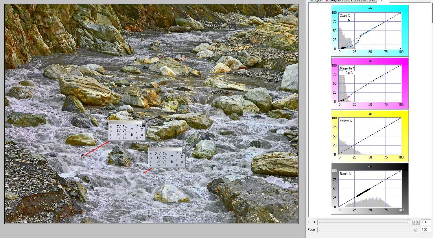

Postby ggroess » Tue Apr 16, 2013 3:28 pm
The water is definitely too blue...
This looks like a job for CMYK.  Subtle corrections are needed here.
See my screen shot and Curve file attached:
2007-11-30_084931c-wgcmyk-acv
(94 Bytes) Downloaded 609 times
capture-jpg-45
capture-jpg-45 (312.83 KiB) Viewed 14343 times
