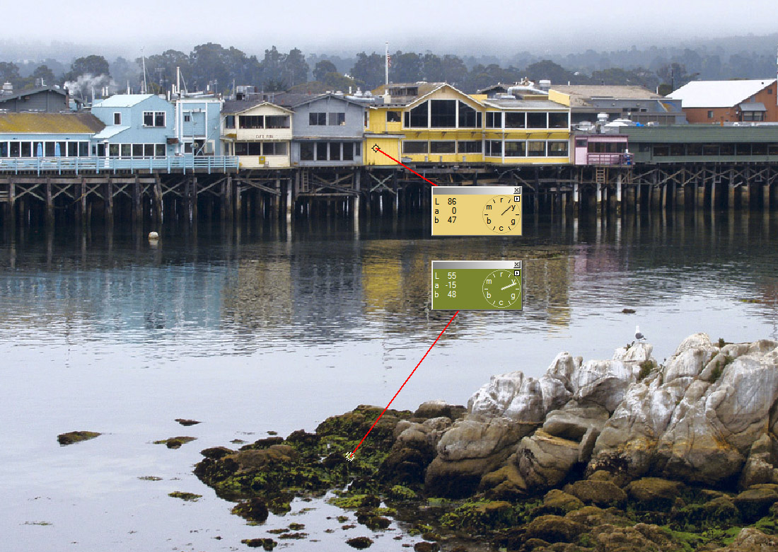

The yellow in the grass and in the building were so close that it seemed that was little or no room for adjustment, so I went into the b channel and reduced the green. Although it's a subtle change, I think it possibly gets closer to one version of a believable reality. I just noticed I've drained all of the green out of the building on the far right, which is now a slightly greenish grey. Oh well...maybe another day for this one.
dock-measures-jpg
dock-measures-jpg (290.95 KiB) Viewed 14316 times
dock5-jpg
dock5-jpg (306.63 KiB) Viewed 14316 times
