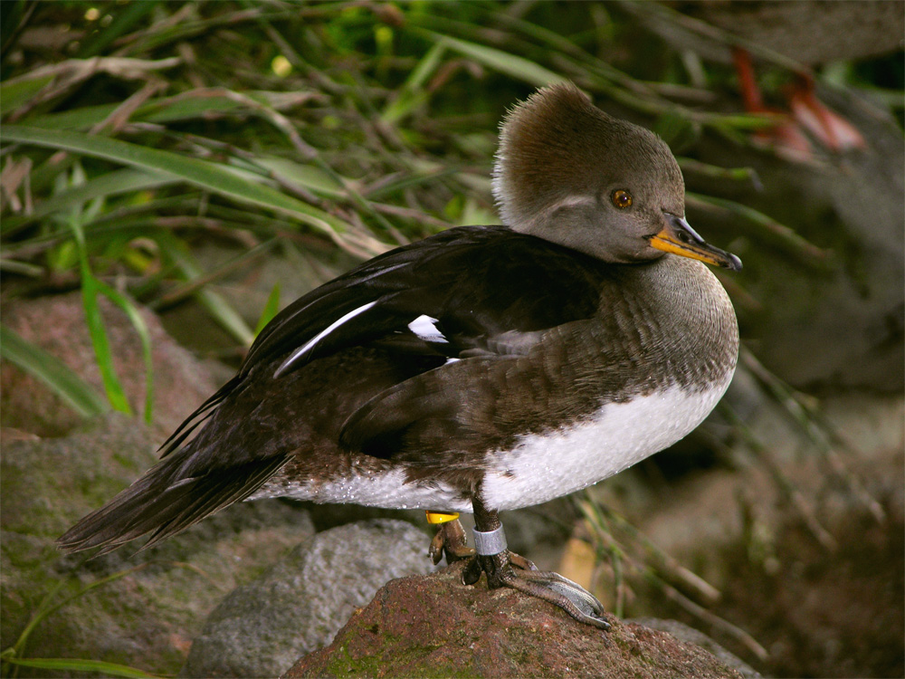

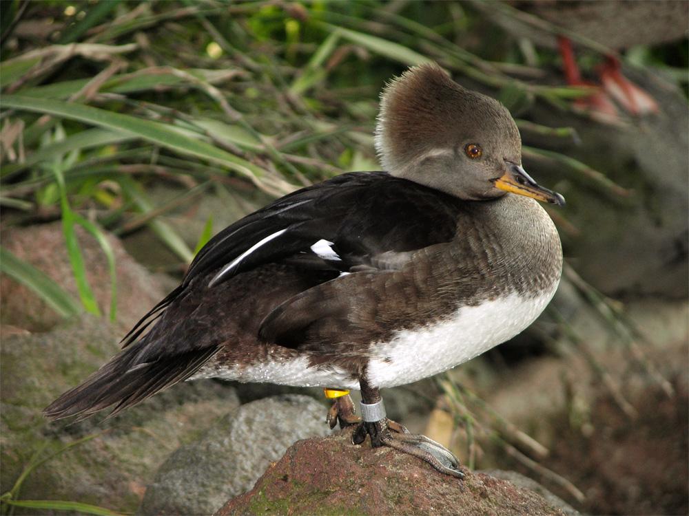

Hello All,
My results were similar to Tanja's. The LAB colours are more vivid but the duck looks green, which doesn't appear entirely natural. The green appears when I set the neutral on the band; I've tried several different places on the band, but could not find a place that didn't make the duck look like it had been eating too much algae. The RGB image looks more realistic. The underexposed original's hues look more similar to my RGB version than my Lab version. Greg, your final LAB image (the one within the "Adjust the Overall Brightness and Color Intensity" paragraph), appears to favour a greenish duck as well. Do you think this is the correct colouration?
I should mention that the Abraham Lincoln video gets no farther than about half-way through, at which point it stalls (tried several times). Not sure if it's my computer connection or not. Anyone able to watch the entire video?

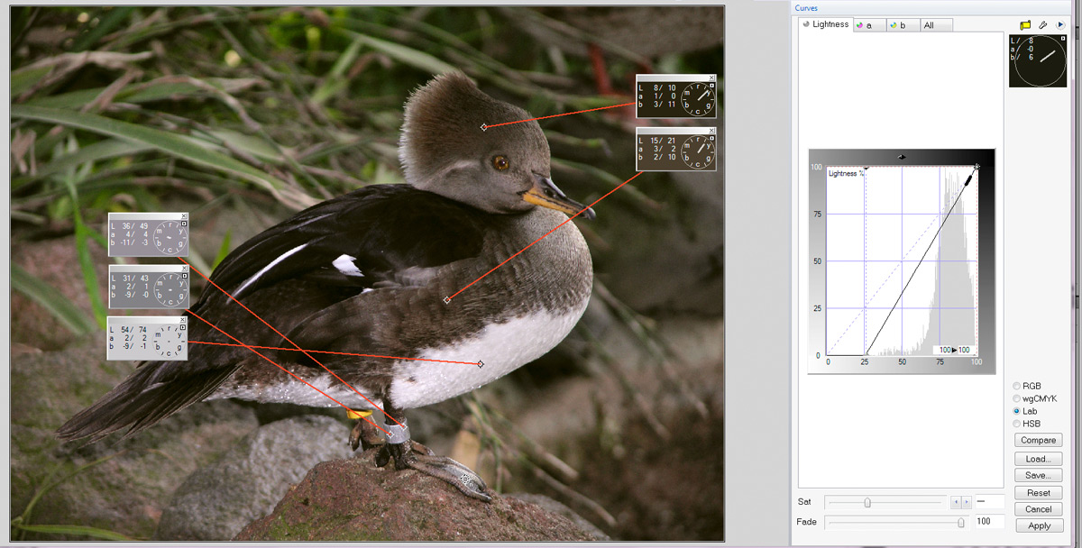

Hi Art,
where you found your neutral point?
Similar to mine?
Greg, I found the videos now :)
Makes it easyer now...
I decide, that the ducks darker feather has to be zero or "plus" in lab, but don't find a better neutral point to bring the white feathers more to neutral. Compromise.
I forget colorboost and brightness in cm and do it ps.
Similar to mine?

Hi Art,
I think, your white feathers are more neutral.
This would be mabe the compromise with just the neutral point for correction.
More yellow in the duck or some blue in the feathers.
Same as magenta/green.
What do you think? Are we ready with the duck?
Let's see, what Greg's saying.
Then you have to start the next one ;).
Thanks Greg -- reducing the sample size was very helpful. I'm think I'm beginning to prefer LAB!
What do think of this version? Should I have another go at it?
Art, you have a very solid correction there. I'm on my laptop until tomorrow afternoon. I'll comment more fully when I can trust my screen.
