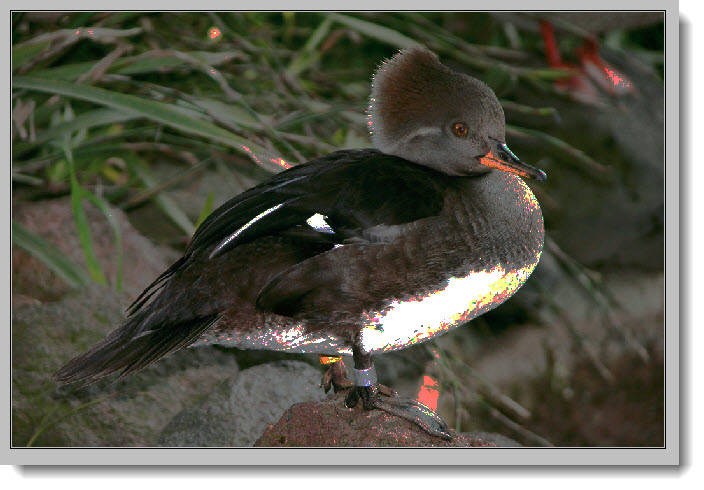

Dan,
The color is hard to judge because the highlights are blown out.
There is significant detail in the breast feathers of the duck.
My screen shot shows the highlight threshold for your posted image.
As to the Hue clock. the length of the hand is a measure of the saturation of the hue under the sample. The longer the hand the more saturated the color. You can have a visually neutral color with a few points of error.
- greg02-jpg-6 (88.92 KiB) Viewed 17165 times
Hi Dan,
I see your bigger picture now.
The correct processing, as I have understood greg, seems to be going in a different direction.
But obviously we all prefer a more neutral duck. Class revolt ;D
Okay, he has created the image and know the light conditions. Nevertheless overruled.
Sorry Greg! ;)
I like your colors and think it's brave to go so far with the highlights.
Just read something from Dan Margulis about that. It's an decision.
But also means that you lose details.
Sometimes you have to sacrifice something to get something else. The question is how much you are willing to sacrifice.
The ducks belly is now so pure white. I personally would like to see more details there.
Class revolt...nonsense. I want you to think and explore.
Your choices are what matters here. If you can justify the choices I can see a reasonable argument to accept the image. Is there a right and wrong?? Sure, but the boundaries are loose and open for interpretation. For instance I thought you did a much better correction on the Car than I did. I am intrigued by what you did and I hope you will take the time to show us all more.
