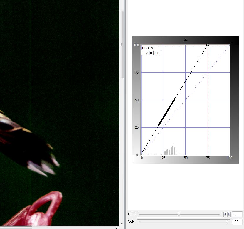

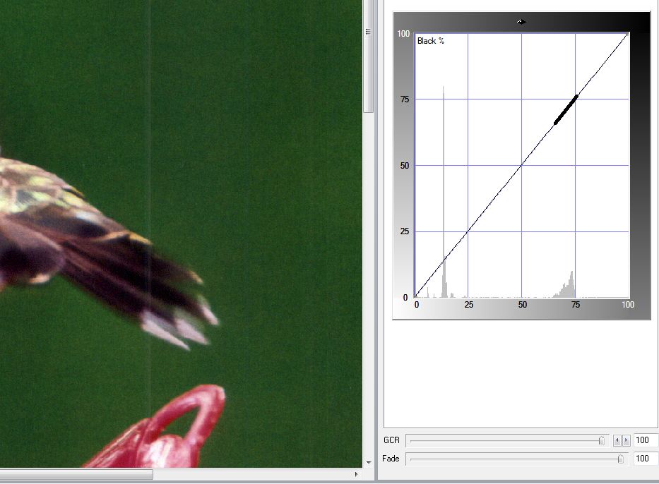

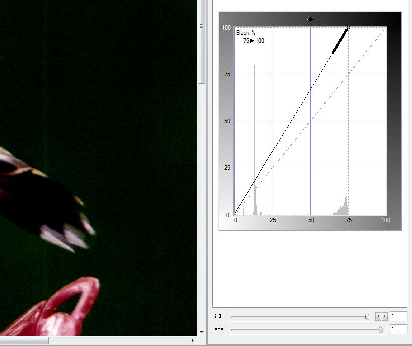

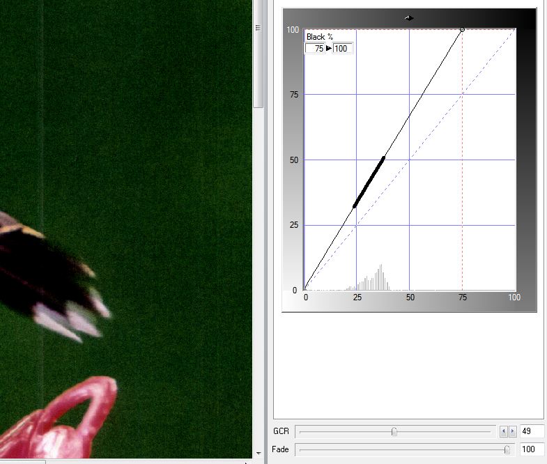

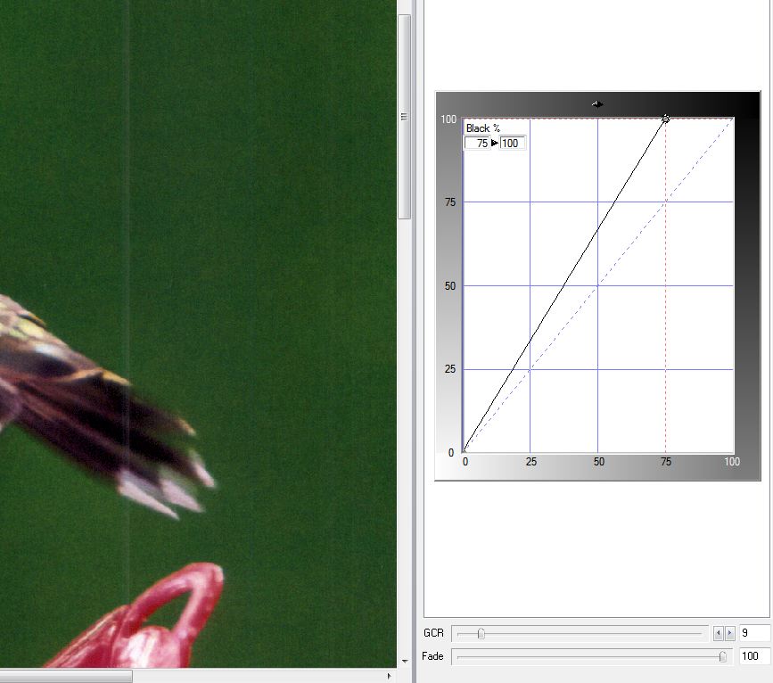

Postby ggroess » Thu Apr 11, 2013 7:28 pm
Ok,
As I suspected...The GCR update bug has not been fixed.
Screen shots below show...
1) Initial state.
2) K channel Curve applied to image.
3) image and GCR setting before clicking "Compare"
4) Image and compare after Clicking compare
5) New GCR setting after clicking compare.
I'll remind Mike about the bug.
