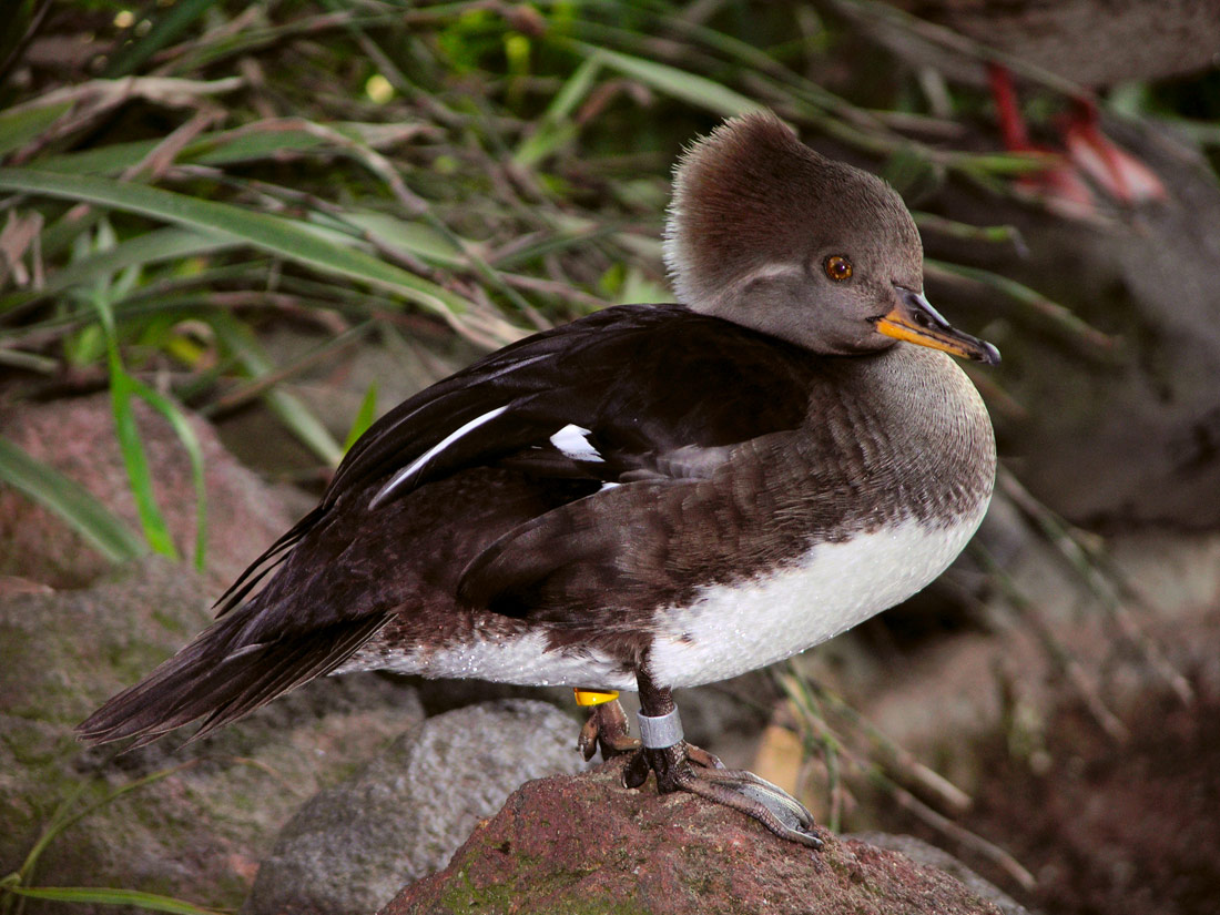

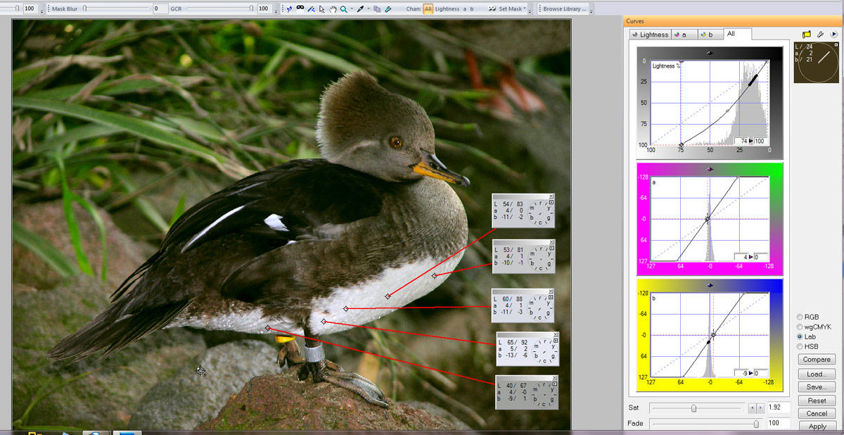

Postby imported_Tanja » Sat Mar 30, 2013 11:12 pm
Greg, I can't saturate more. The color cast is then showing up too much  ;D
Okay, I try again.... ::)  ;D
Art, take the next exercise you like. I follow you, when I'm finished here ;-)
Edit: Better now? Duck looks green again...
duck-lab-2-jpg
duck-lab-2-jpg (195.61 KiB) Viewed 16991 times
Postby ggroess » Sun Mar 31, 2013 12:28 am
Tanja,
You are quite close in lab.  Think for 1 second...
If you are too green in lab you have to move the zero point.  There are 2 ways you can do this.
1) you can pin the curve as I did in the corvette video OR...
2) You can move the green endpoint.  Each can do the job.
See what you can do but but keep it simple.

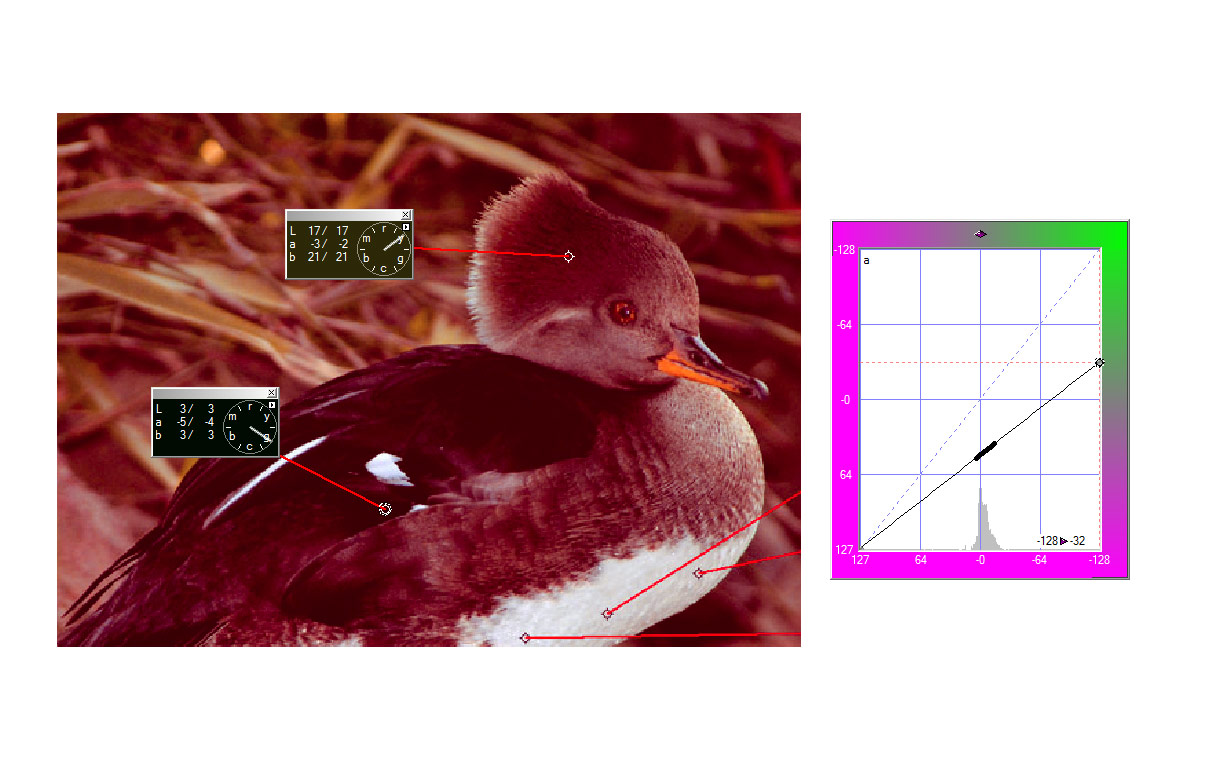

Postby imported_Tanja » Sun Mar 31, 2013 5:49 pm
thinking needs more than 1 second  ;)
When I use that pin grid, like you in the car-video, I fix the zeropoint.
Moving the cuve with fixed zero in the green side, brings all green out, exept the color cast in the duck. Because to close to zero, right?
Moving the zero point - by selecting or move the green end -, brings green out of the ducks darker feather, but more magenta in the whithe ones.
Only solution I found is using a mask.
One big problem in moving the lab zero point by using a mask: My hue clock isn't changing.
Easyer to show on an extreme example on a picture. What went wrong?
red-duck-jpg
red-duck-jpg (150.73 KiB) Viewed 16991 times

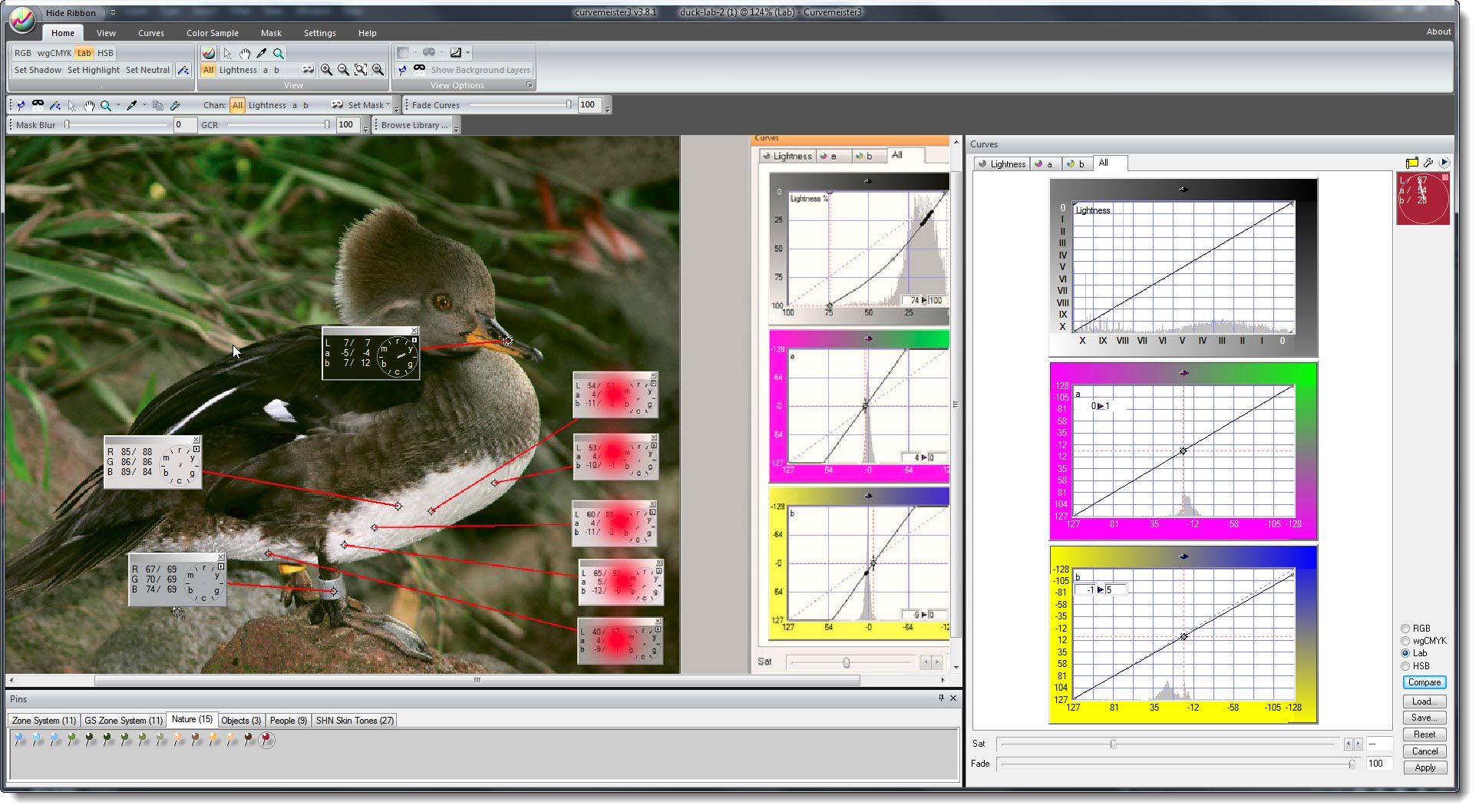

Postby ggroess » Sun Mar 31, 2013 11:53 pm
OK Tanja...too far...
Here is the correction I was thinking about using you image posted above.
I will also load my .ACV file for you to load up on your PC.
Download the ACV file to your desktop and then download the image you have posted above unless you have it saved in that state on your hard drive.
Open the image and then open CM.  Choose "Load" and then select the ACV file from your desktop.  This will apply my curves to your image.
Zoom into the A and B channels and look at the slight adjustments made...you adjusted way too far for the problem you had.  I found more Cyan than Green by the way...
greg00-jpg-4
greg00-jpg-4 (301.17 KiB) Viewed 16991 times
