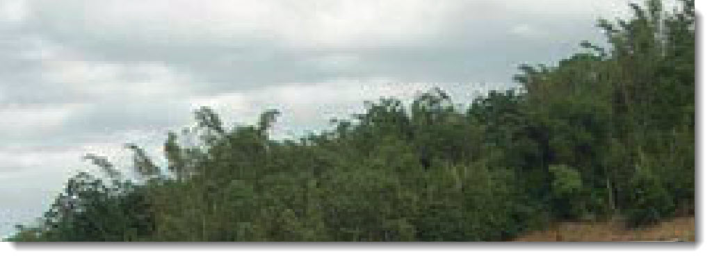

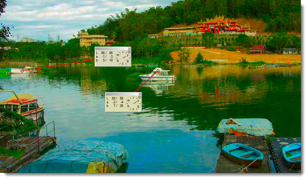

Shot 1 shows the tree line.  The noise might be coming from the mask so take a good look at it to see if you can eliminate some of the edge noise.  try reducing the blur if you can.  Also the image has a slight yellow cast to it...see screen shots below.
greg01-jpg-4
greg01-jpg-4 (52.84 KiB) Viewed 7238 times
greg02-jpg-3
greg02-jpg-3 (259.79 KiB) Viewed 7238 times
