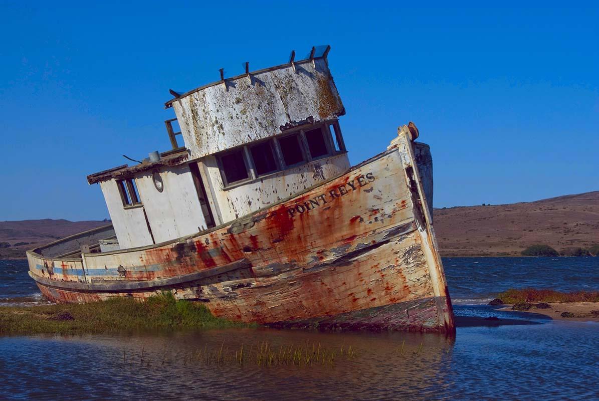

I've finished the first week's assignments and am attaching my results. I totally misunderstood the number ones and tried to adjust them to black and white with the most contrast.

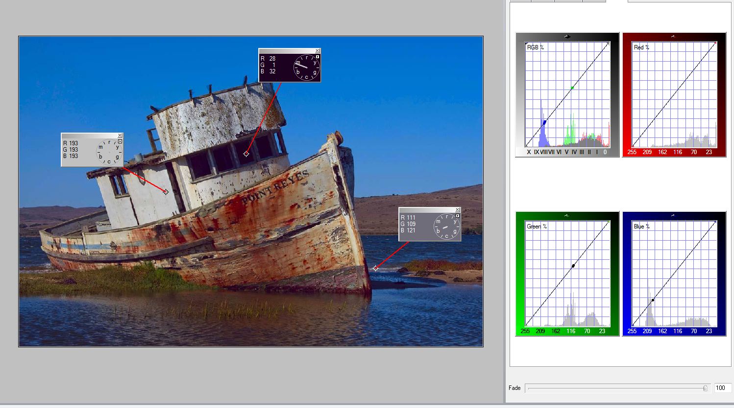

Tina,
Good Job overall. A few minor details remain...
Ok, maybe not so minor but fixable...First things first. There is a magenta cast in the shadows overall. See the screen shots below. It is not a big deal because the By the Numbers part of the class is this week and next and you should do a BTN correction on this image in RGB to get the color right.
Also there is a heaviness to the image overall that a slight brightening of the whole image improves.
Overall a good recovery of the image and you made a great choice for your neutral on the white side of the boat. I added a midtone neutral from the splash on the right of the frame.

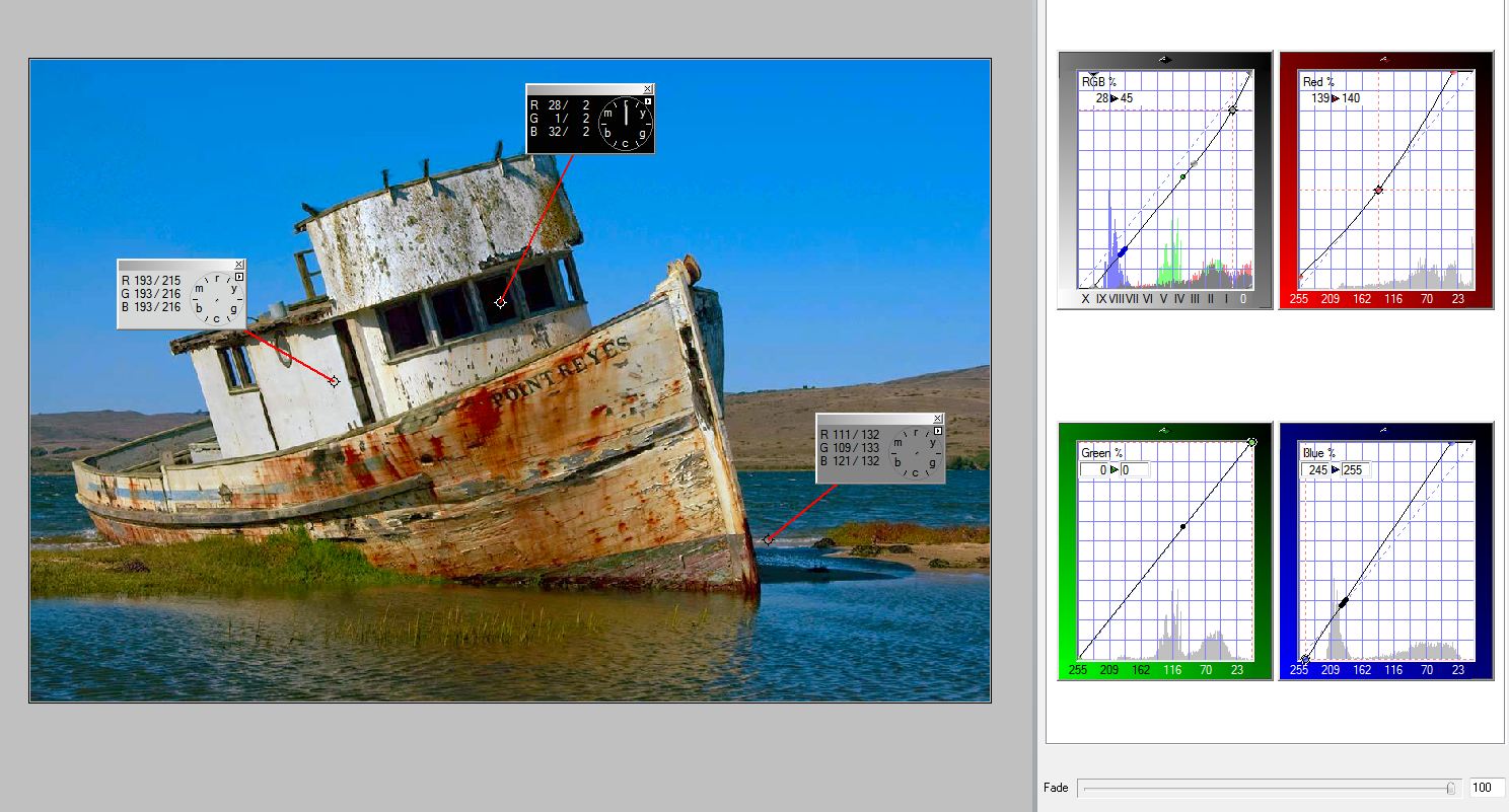

- capture1-jpg-2 (198.44 KiB) Viewed 8619 times
- capture-jpg-27 (208.77 KiB) Viewed 8619 times

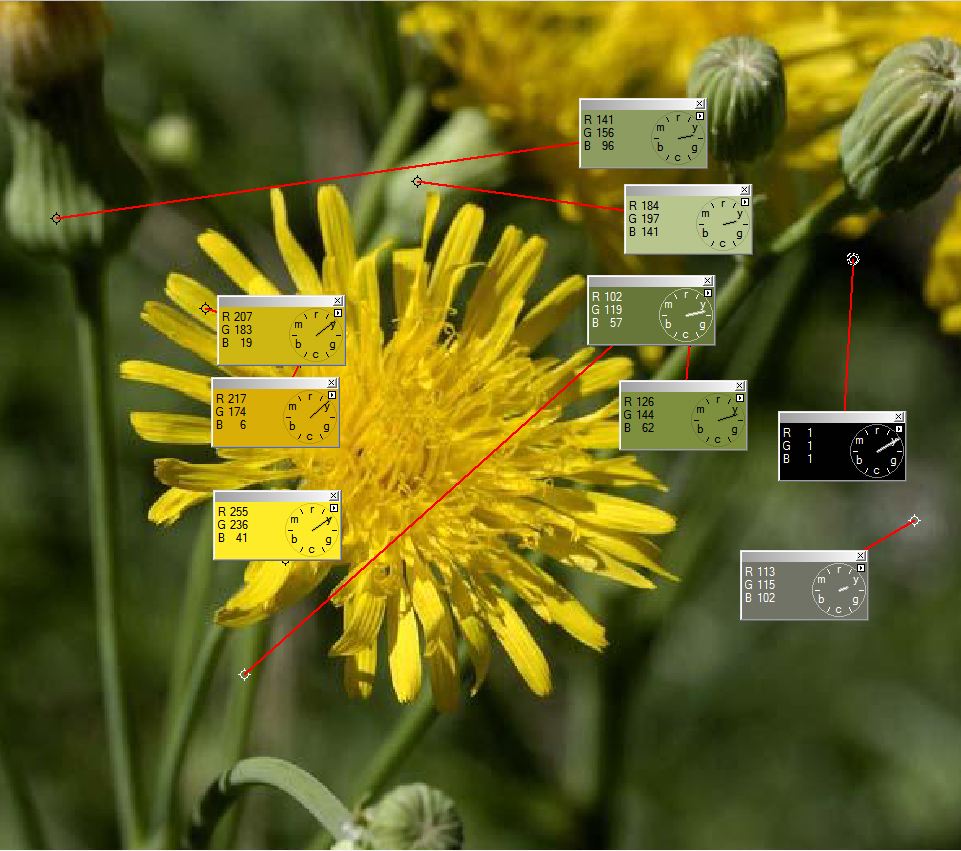

re: Yellow Flowers. See screen shot below. Good job keeping the hues all in the same area. The greens look good and the yellows are all consistent.
